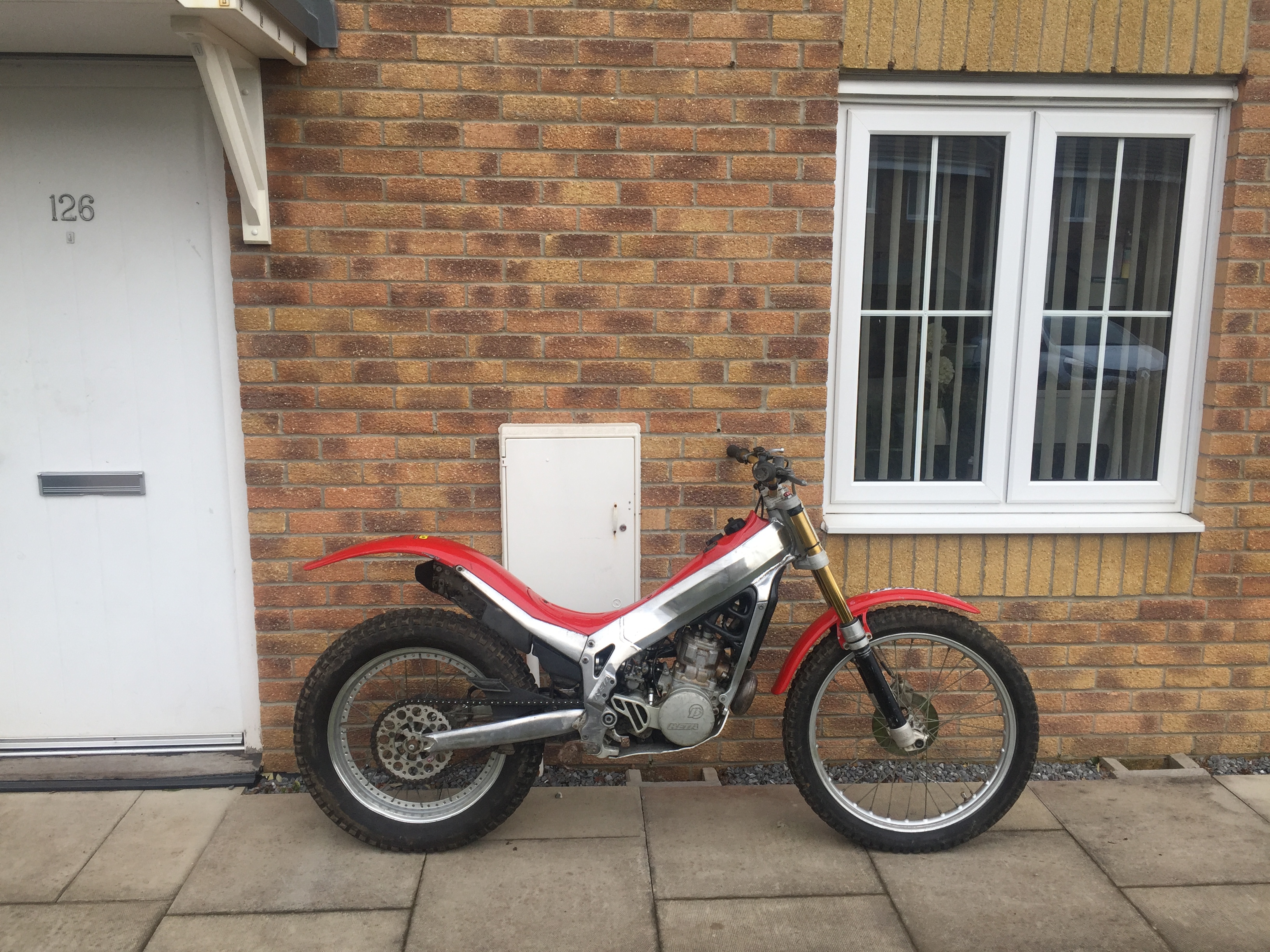

Hi please excuse me I’m completely new to all this I’ve just bought my first trials bike I didn’t rush in to buying a new 1 yet just in case I don’t get on with or or just keep falling off I believe I have a beta 280 but have no idea how old it is or what model is there a way to identify it from the frame numbers? Thanks for the help in advance.
I dont know anything about frame numbers but i usually find the colours of the forks / wheels and if the plastics are original the shape and colour of them change depending on year

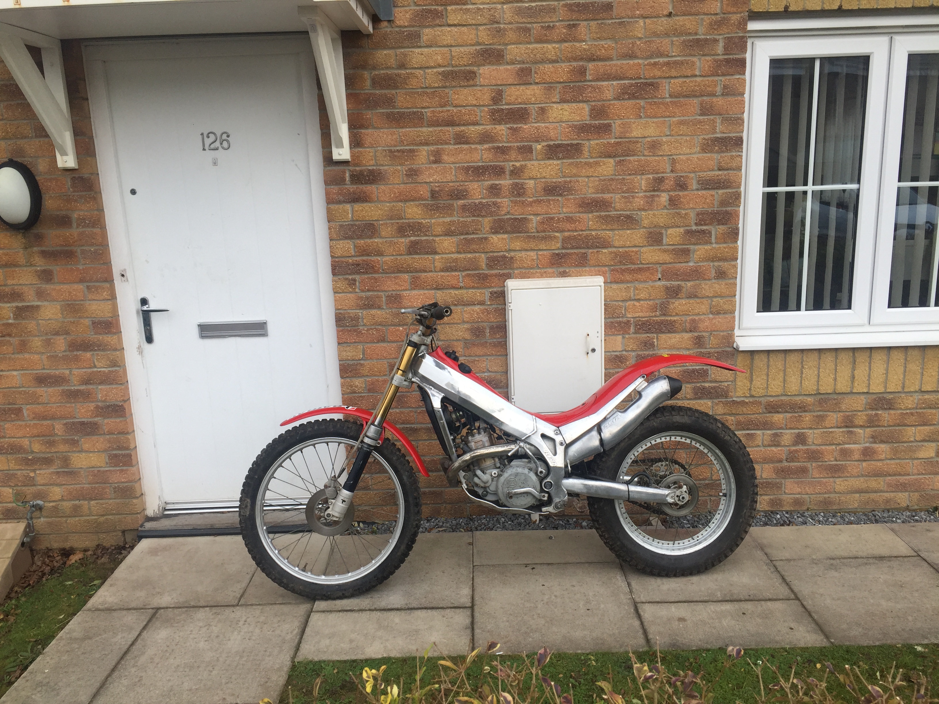

Hi I have gold forks and alumni Colour rims I have pic if my bike I would appreciate your help if you could identify it for me
have a look on 'Beta usa'...they show a trials bike history with pictures of the bikes and a brief description.....assuming your forks are original it appears they only produced bikes with gold forks in 96, 97 & 98...but not 280cc only 250 as the biggest engine.....you could try calling Beta uk and giving them the frame number....usually found  on the head stock on modern bikes.....good luck
I dont suppose it helps and you prob already know but the model name is a beta techno its a start  good luck and happy trialing
That’s fantastic it’s more that a start it’s super helpful thanks
 It is a 96 or 97. The size you will not know for sure until you measure the bore. It is more likely a 250 because Beta did not make a bigger motor until 98 and a half. They were late getting out the bigger model in 98. I did put the larger cylinder on a 96 myself, so anything is possible.
