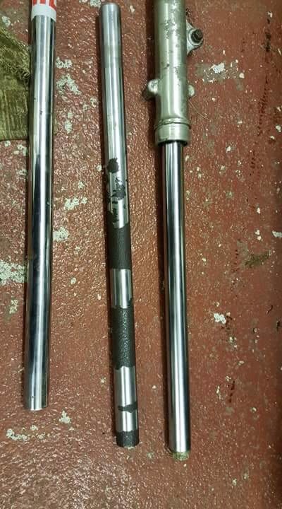

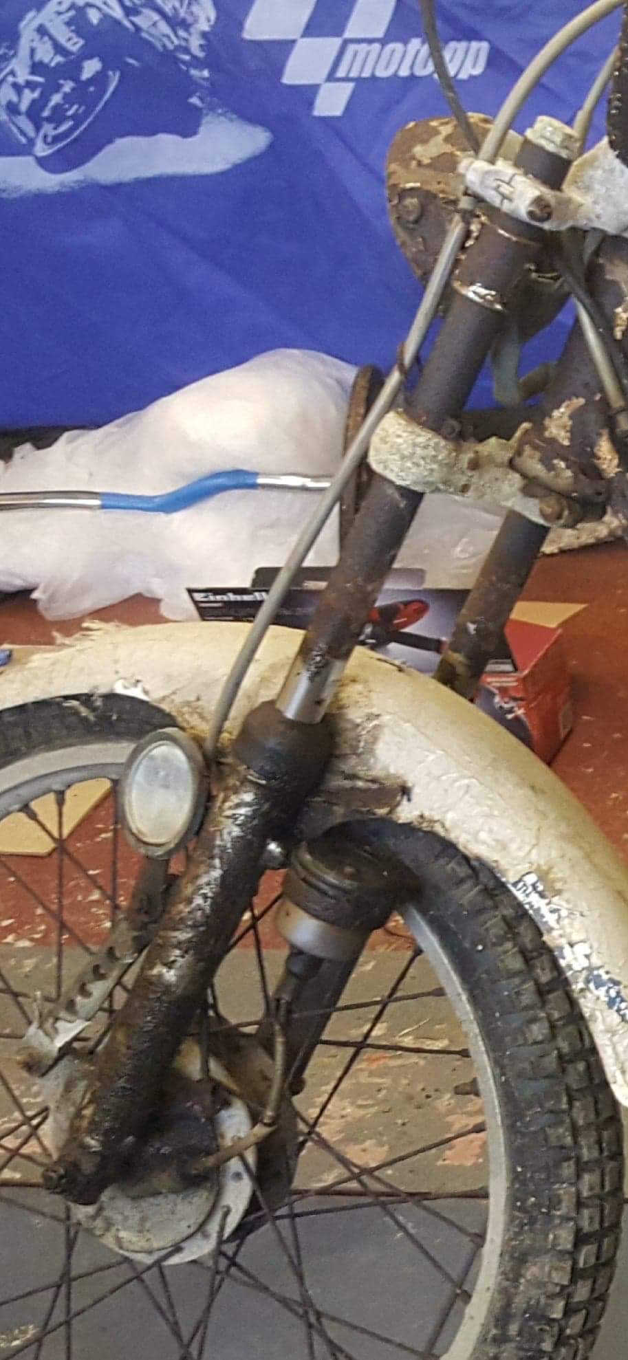

This is the condition of the tubes, worst comes to worst they might be able to rigrind. But thanks for the suggestions they may be an option yet.
Ok so it turned out the DT stanchions I could get were the right size after all. So I got lucky there.
Just a quick fit into the fork leg to see but there's a million other jobs to do first. There not perfect but a good bit better than what was on before.
