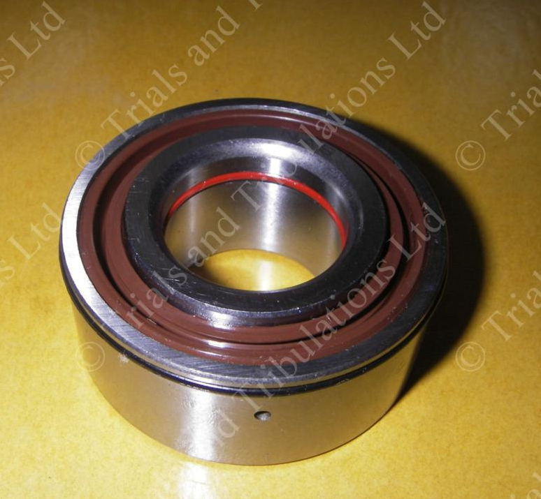

I found this at trialsandtribulations.com (stated for credit, not necessarily advertising.  I have no connection) This states for 2005 onwards, the crankshaft bearings/seal/O-rings are all integrated as one unit.  Which may explain why the seal was too small to pull with a screw

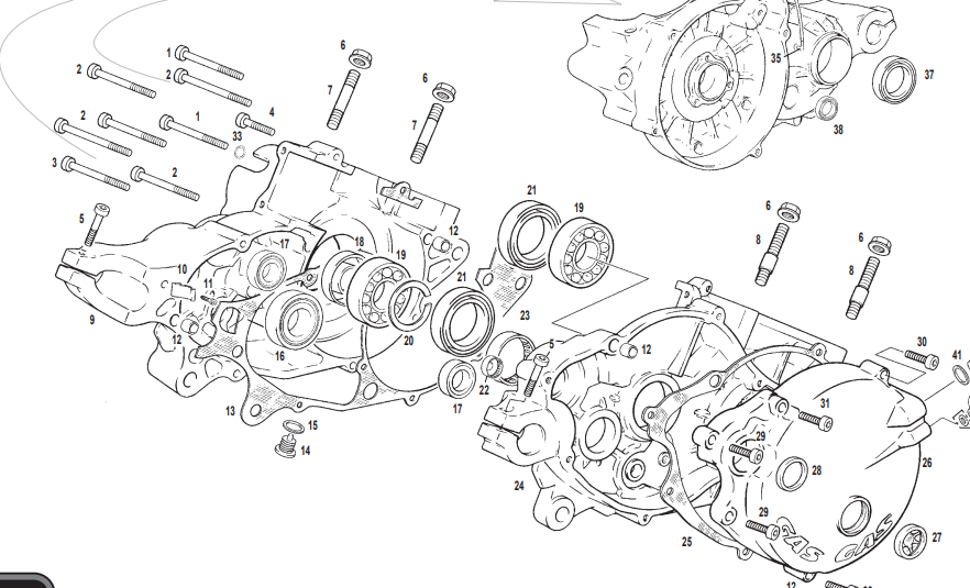

Older versions like mine have on the ignition side: going from outside in, Seal -18, bearing-19, washer-20 and another seal-21

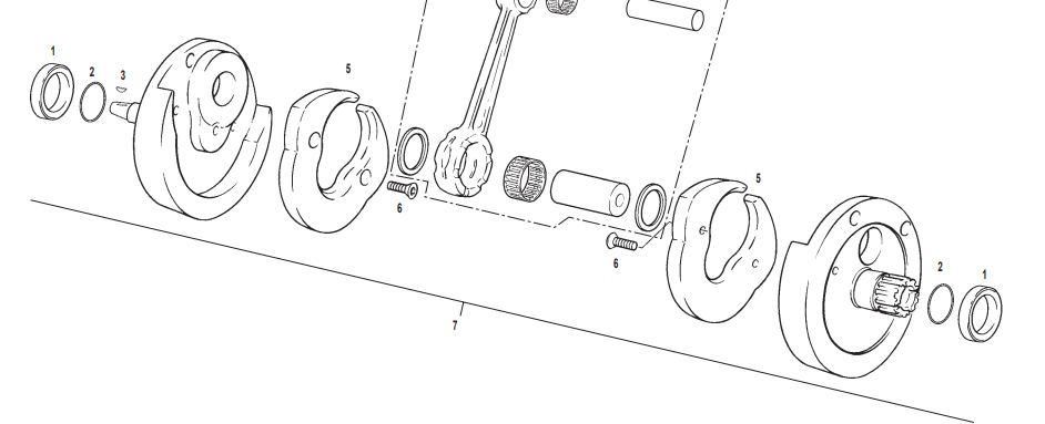

The crank also has a collar with an O-ring between the collar and the crankshaft. Numbers 1 and 2 in bottom photo.  I believe the single unit above replaces all of those bits.
(images below found at Lewisportusa.com again just for credit no other reason.)
