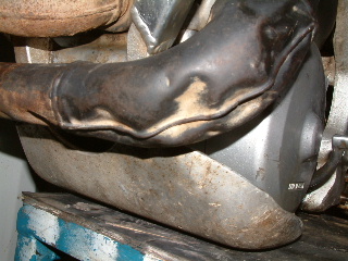

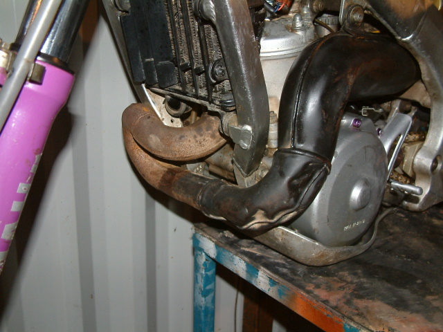

Cheers for the replys guys, here's a couple of pics just to show you how bad they are.
Someone has suggested drilling a hole opposite the dent then knocking it out from that side and then welding the hole up ! I can see me trying all of the above mentioned methods before I fork out the
That one is going to be rough no matter how you go about it.
I would pursue finding someone in the MX field that does it regularly and see if they would takle it at a reasonable cost.
I could point you to some folks in the US, but that would not be a lot of help.
Cheers Alan, I'll put the feelers out, it is quite bad isn't it :rolleyes:
Beats the hell out of me how folks can get the things into such a mess in the first place ! looks like it's been thrased with a hammer
Or you could try some of the specialist off road breakers. May not be priistine, but could be better than the one you have! It may be an easier bet to start repairing one which isn't so badly dinged, and will be less than 350 squids.
That is not a bad 'ding' going by what I have seen fixed on a scrambles bike by using pressure and heat. I remember seeing a pipe which was flat and did not allow bike to run at all repaired back to nearly perfect condition.
Try speaking to your local MX riders and dealers, someone locally is bound to be able to repair this at a reasonable cost. They will have the equipment to repair this sort of thing and more importantly know how to do it!
Good luck!
ouch.
can't reach those using my rod method.
I think I'd try the suggestion above, but instead of a punch, cutting a one inch hole on back wall, against engine or over near the front left cylinder hold down bolt in the picture. Then work through that hole with a rod. Use heat to soften and work out the dents. Patch it later and the patch on the inside won't show.
Wont' be pristine, especially in the seam, but it would be a workable pipe.
