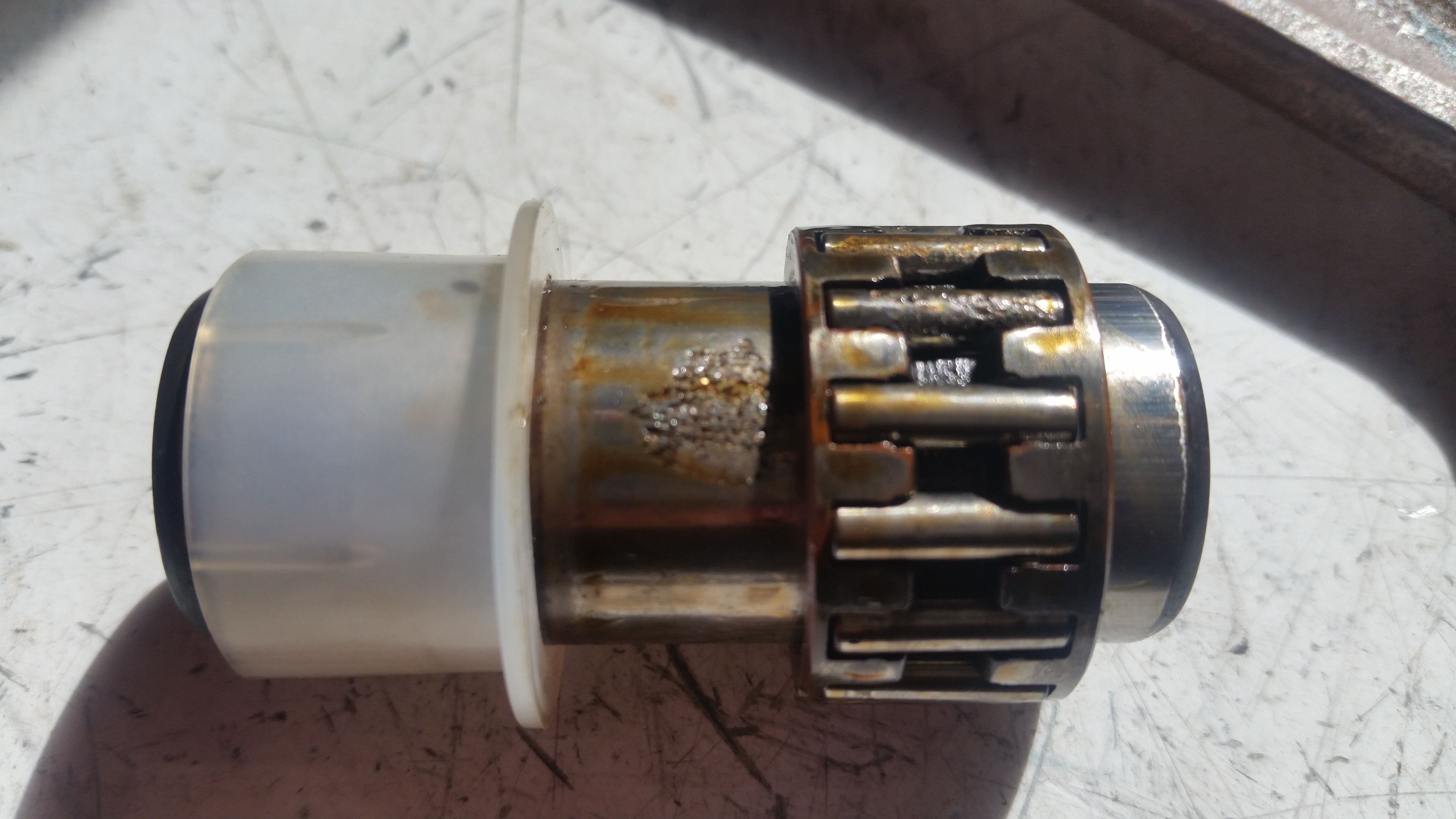

    Your cranks big end might have ‘felt’ alright on the bench but there are a few ways that the bearings can wear from barrelling to tapering depending on main bearings wear to! There was no detectable p
  • Big end can feel fine while being bad. This pin & bearing came out of a crank I didn't know the history of but felt good, would have failed fairly quickly if I has run the motor without fitting ne

Your cranks big end might have ‘felt’ alright on the bench but there are a few ways that the bearings can wear from barrelling to tapering depending on main bearings wear to! There was no detectable play in my crank but when taken apart there were some appreciable wear signs on the big end pin. Just replacing the piston will not solve the issue of piston slap, well it might but I doubt and it will be a costly mistake not to have a rebore and correct piston and rings. ?
Big end can feel fine while being bad. This pin & bearing came out of a crank I didn't know the history of but felt good, would have failed fairly quickly if I has run the motor without fitting new parts

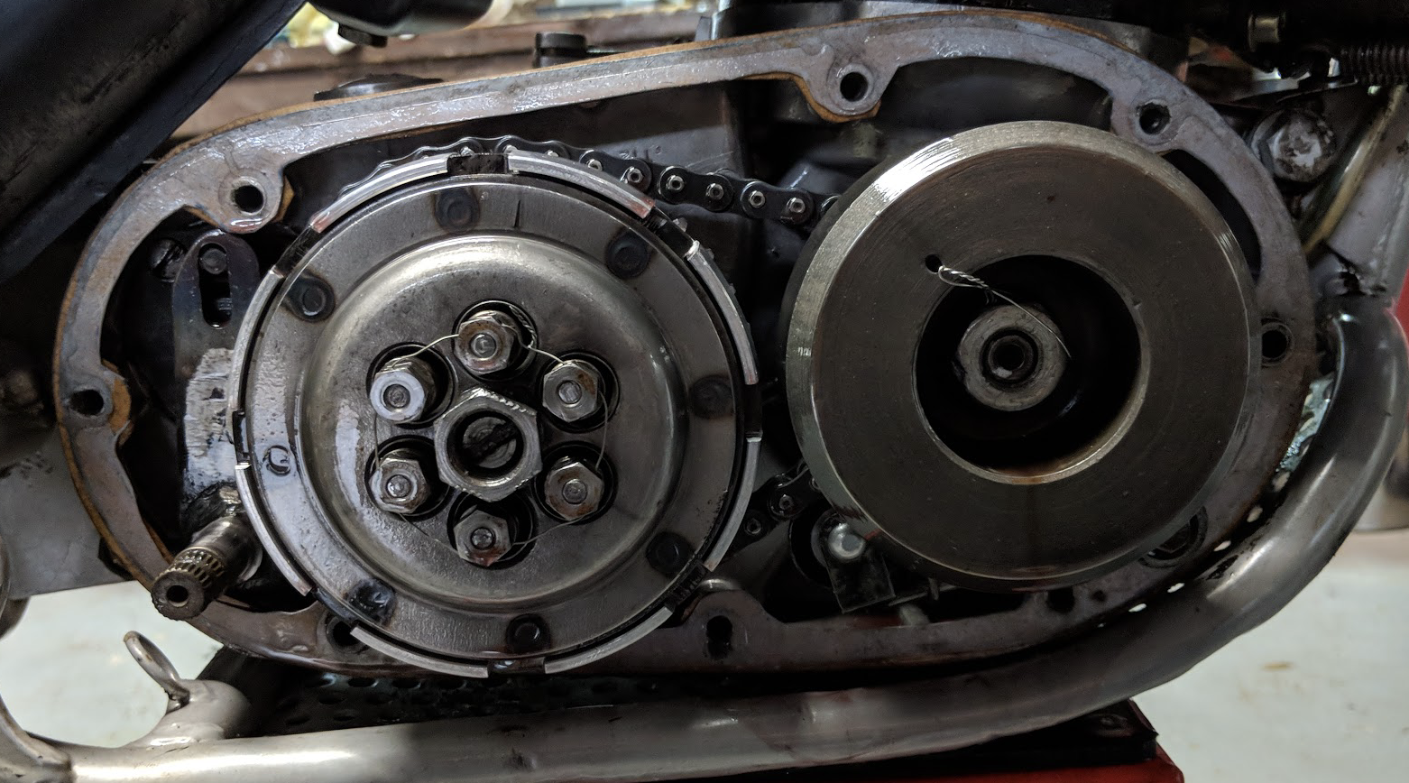

From memory the piston clearance is 7 thou, baggy for sure but I was expecting some noise. I did think this sounds different though.
I did wonder about the primary chain as the bad sound comes and goes riding around at walking pace, sort of like the chain is getting caught up. You can feel a bit of chain slap rolling the throttle on and off as well. I thought the tensioner was stuffed and I took the cover off to have a look but it looked ok, as did the flywheel feel tight. I didn't try to tighten anything while I was in there though.
The clutch basket is alloy which I don't think is a standard for the sherpa, perhaps Pursang?
Also, it has a flywheel on one side of the chain. I think I read somewhere they came with one each side?
Edited by cornishflyer
Added video
I have 2 Sherpa's, both have an aluminium basket. At this stage, I'd check the flywheel if the crankshaft nut is tight. I had a similar sounding problem on my bike, that was the result of wear on the RHS parallel crankshaft, fixed temporarily with a special loctite, I think it was silver Loctite, whatever it was it could accept a clearence of up to 20 thou or so. Even though the crank nut was tight, the flywheel could still rotate on the shaft and sounded like your bike. 7 thou is a lot but that sort of clearance would make a ring a ding ding noise, not a heavy clump. Check the flywheel. You may be able to hold the magneto flywheel and then try to see if you can rock the RHS flywheel. Odly enough, your bike hardly makes any ringing noises. Could also be the primary chain, they never lasted too long before needing replacement. Bye, Peter B.
