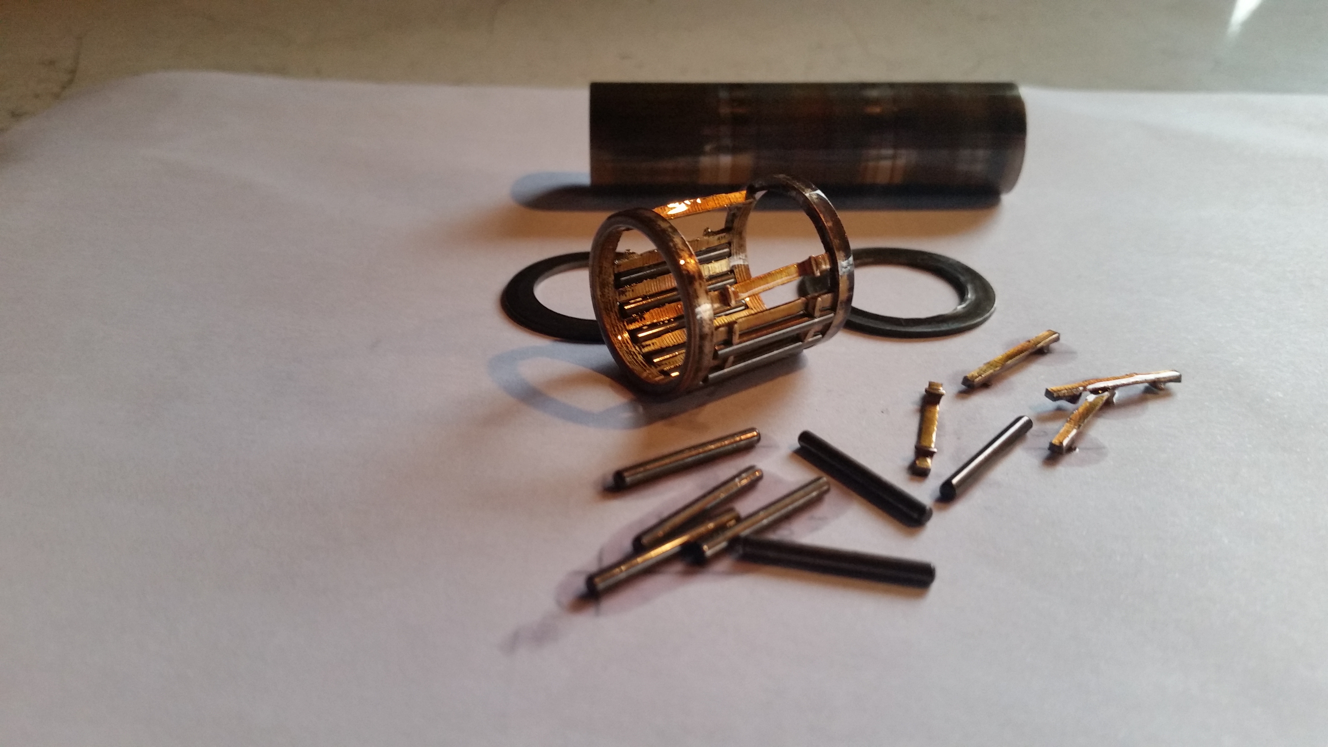

I have my own story of small end failure.
I was swapping the piston port top end on my CZ to a reed valve converted top end & got greeted by all this when I pulled the pin out, who knows how much longer it would have run before making a big mess. What probably saved me from a big blow up is the washers that centre the rod inside the piston kept the bits of collapsed bearing cage contained
Sometimes we get lucky & avoid the big mess

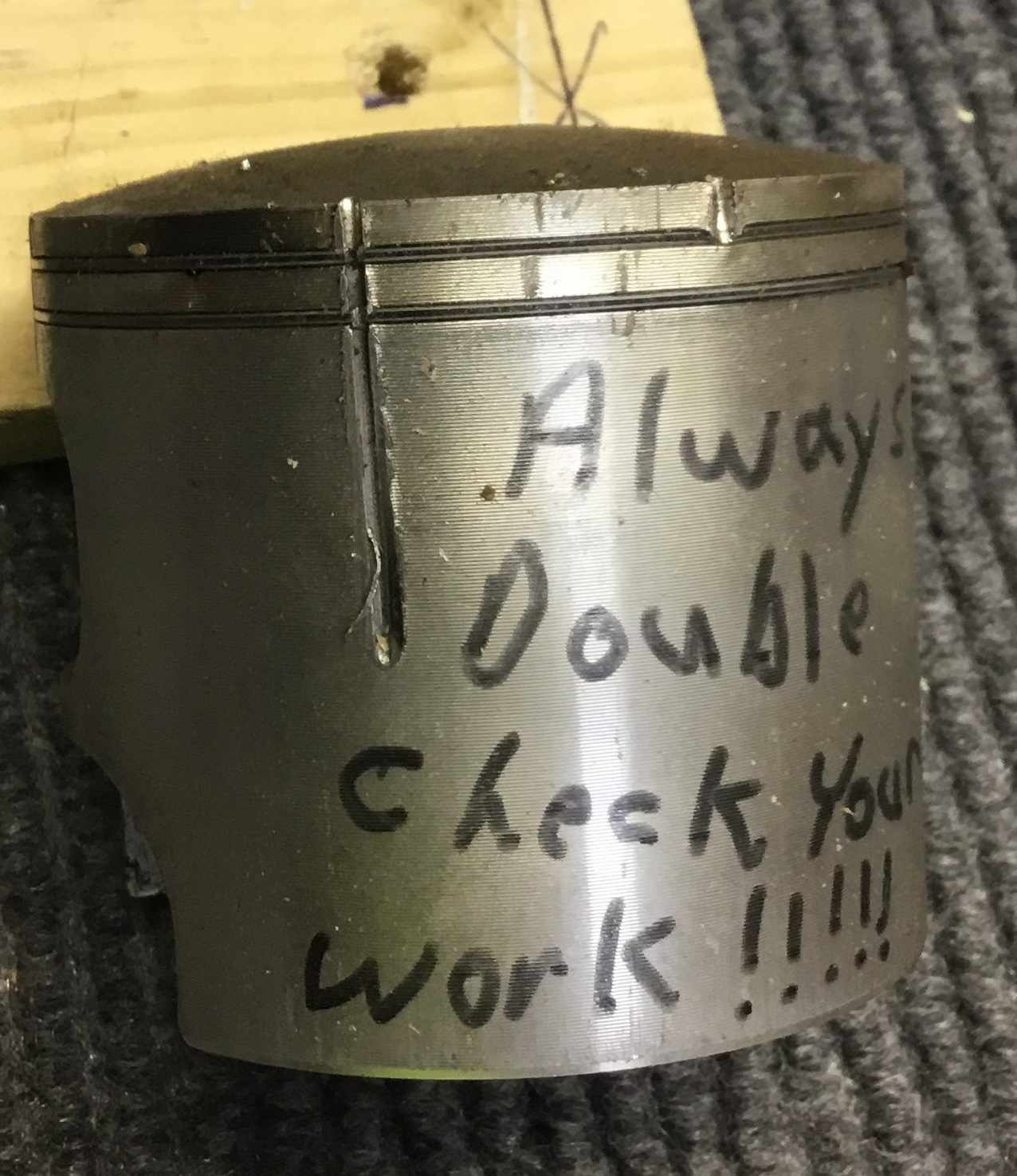

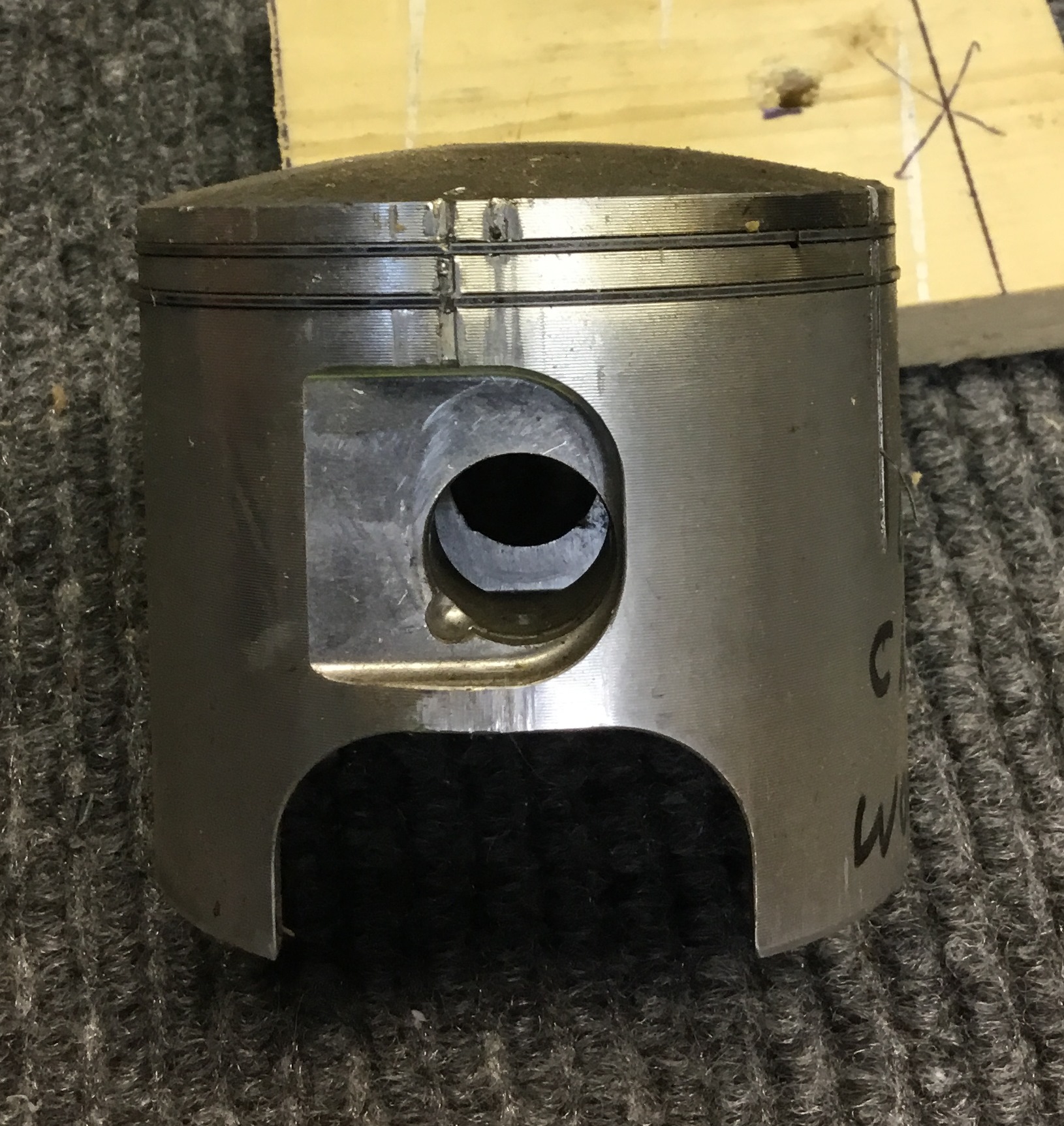

He are pics of my then new piston after it ingested the small end bearing.I keep it on the shelf as a reminder.
Edited by scot taco
