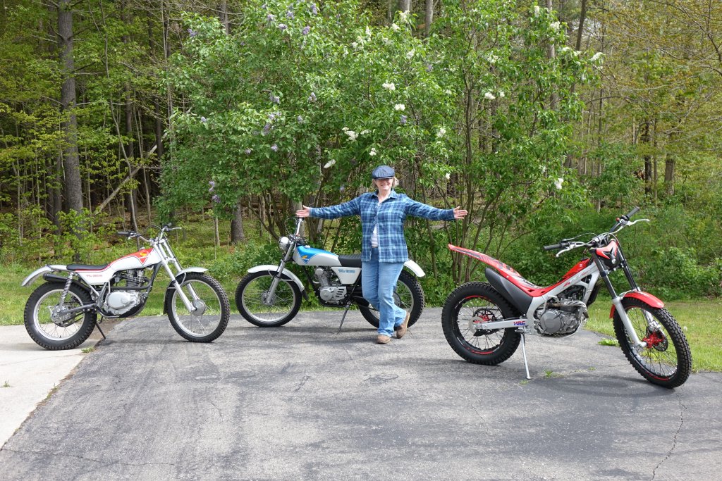

August 6, 20188 yr hello Mal, I built my tl125 and tl250 from ebay parts mostly, things like the plug cap and sparkplugs and gaskets are available thru honda still though and it is best to always check the microfiche first for availability, then go to used sources. I actually found on ebay a new old stock tl250 motor that I started for its first time in 2016, so my 250 has ultra low hours on it. my wifes 125 has a newly rebuilt engine with a sl125 cam and piston and top secret heat shield to open up the intake to 25mm instead of 22mm . for photos of me and agent 99s bike look at the post in honda forum "happy new year" we were playing on new years day in the snow and posted photos of the bikes.
August 6, 20188 yr OK I looked at the "Happy New Year" posting and 86 and 99's bikes do look fabulous. Being quite a fan of Get Smart, I'm now really keen on seeing photos of 86 and 99 and hearing 99 say breathily "Oh Max" as Max rides past

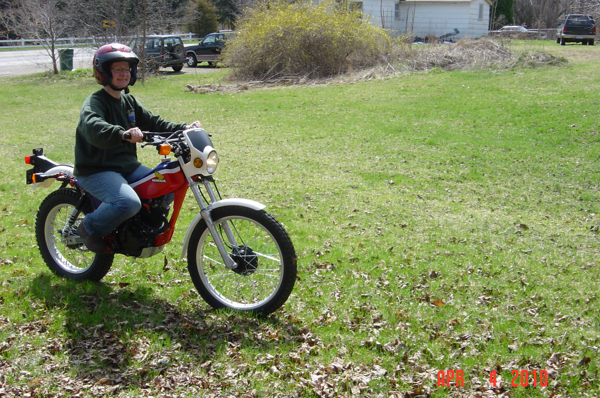

August 7, 20188 yr On 8/6/2018 at 7:47 AM, feetupfun said: OK I looked at the "Happy New Year" posting and 86 and 99's bikes do look fabulous. Being quite a fan of Get Smart, I'm now really keen on seeing photos of 86 and 99 and hearing 99 say breathily "Oh Max" as Max rides past Oh Max! ( you will have to imagine the breathiness)....Thank you for the kind words on our TL's , we love them - my husband found the TL125 on craigslist after I accidentally wheelied the 2015 Montesa across the back yard, I obviously needed something with less power. It is perfect for a beginner off road rider! We then proceeded to replace almost every major component until it was acceptably nice.
August 8, 20188 yr Excellent and thank-you agent99. The photos are lovely and the sound of 99 saying "Oh Max" is something I always enjoy remembering
