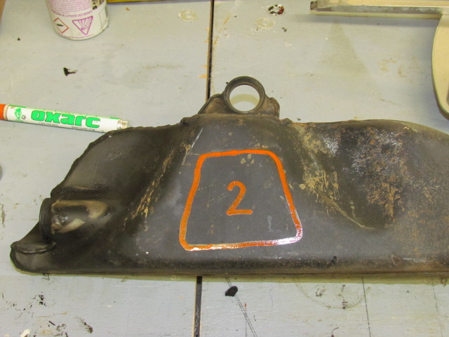

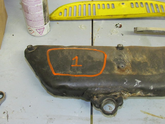

Generally, inside there is a perforated tube ( usually solid with sh@t ) surrounding this is packing, glass fiber or similar. If it's steel burn it out. My preference is to cut a window and fit a plate to make repacking easier in the future. I use rive nuts and good quality silicone to seal.

First box is similar to back box in design and function. How do you tell it needs done ?  If you ride the bike regularly the sound is the giveaway, it gets louder and tinnier. Bottom end performance drops off.  You have established the back box is full of crap, chances are the front one is too.

check out the WES silencers. alsp I myself would not cut the front pipe until first I seen how things go after getting the blocked  rear cleaned or replaced.
Also, I have long wondered why a good long soak in a Hot solvent tank at a local automotive machine shop would not work to cut the crud in the pipe. that is what that stuff does, but it is some nasty stuff!

actually I believe that the majority of your issues may be resolved with cleaning the fire arrester screen ang repacking that. you could flush the muff with a solvent like gas or laquer thinner, then dry with a air feed. the fine screen on the SA is your choke point. those screens are regulation size you know.
We used to bung up one end of an exhaust then fill it with caustic soda solution to decoke it.  Will need repacking after that of course.

I have 2 pictures attached to this email.  they are labeled "1" and "2" and they are on opposite sides of the rear end of the expansion chamber.  would you look at them and tell me if those outlined areas are where you would cut if you were doing it all over again?
Thanks in advance- Newbie to expansion chamber "surgery"
