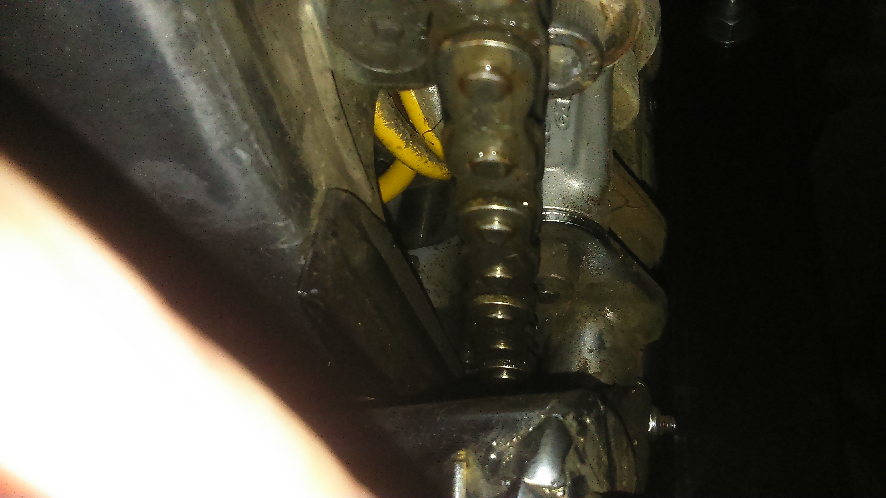

Is it because am spinning the wheel with no weight on the bike.what's the bit of rubber I'm missing I've taken a pic of the chain over the frame at the bottom.

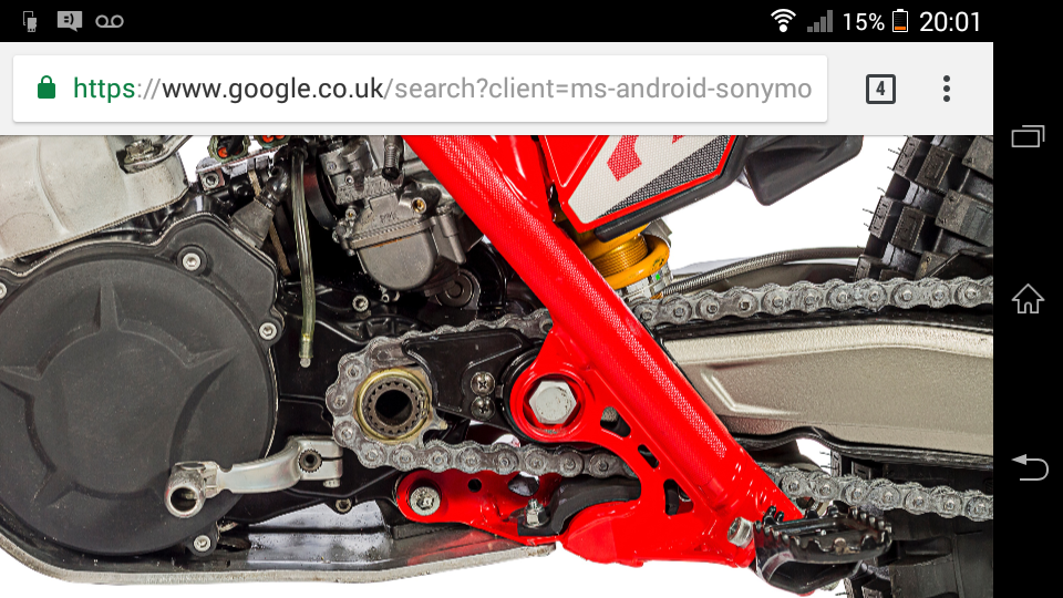

Been looking to see if the frame should have a chain guide on it so far not looking like should. The later ones have I seen on Google images just struggling to find a picture of a bike my year around the sprocket.

Your tensioner looks ok but you are missing the rubber pad that the chain slides over the frame. The part No is BT280212026

Dnt think the 04 pro as the rubber bit ya mention mate as it's not listed in the parts manual and Google says that's 2013 onwards mine is 2004.
Any one have a picture of there 2004 model were the frame and front sprocket are see if there's have the rubber chain guide
2 hours ago, Trials madness said:
Mine is as follows
That gearbox sprocket is worn out and needs replacing, that probably means the chain is knackered (technical term that) as well. I’m wondering what the rear sprocket teeth are like too!
My tensioner is set this far off swing arm.
Chain is rubbing against the tensioner arm, this needs to be corrected. When you push the bike the chain is not under any tension apart from the tensioner arm if the chain has been set properly in the first place. When the bike is being driven by the engine the chain will be pulled tight along the top run and clear the frame, except when the suspension is being compressed or on rebound, then the chain will hit parts of the frame ie the swing arm...hence the protectors....it’s not a precise science.

Chain was rubbing on tensioner when purchased the bike as had slight bend. since as been.straightened.
The 04 parts manual doesn't list any frame rubber chain guide they seem to be 2013 models that have the rubber guide hence protectors
