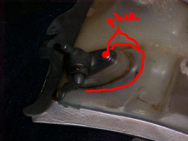

hope this helps anser me question its leeking where its red the bolts and the red lines B)
If the red lines represent cracks in the main body of the tank then i'd say you have problems.

The picture is classic symptom of what Alan has described. Follow his instructions and you will solve your problem.

I know of two other Sherco that have had this problem. My son's and friends son's. Both were Y2K bikes bought about the same time. The problem was not abuse just that the tank was extemely thin just where the tap fixed on. Even light use of the tap cracked the tank. I tried hot glue but it just melted after a few days of contact with the fuel (gas or petrol you choose). I ended up using an epoxy metal glue compound and its now held for over a year though it does weep a little.
02's did have this as a fault but the blow moulding technique was changed on the 03's onwards allegedly.
I have seen and repaired this problem also. The problem "was" that the tank is made of a very flexible material and the adhesive used to bond
the mounting boss into a recess in the tank was hard and brittle. When you turned the fuel on and off or applied a load against the valve (falling banging, hitting with your leg, etc) the valve would move causing the tank to flex. When this happened, the adhesive would crack and start to leak.
Easily repaired by carefully removing the oval shaped boss from the tank, cleaning, and resealing it using a flexible fuel tank adhesive. On 03 and newer sherco's the valve is now in a different spot on the tank, thus eliminating the possibility of damage. I don't know if Sherco changed the adhesive.
