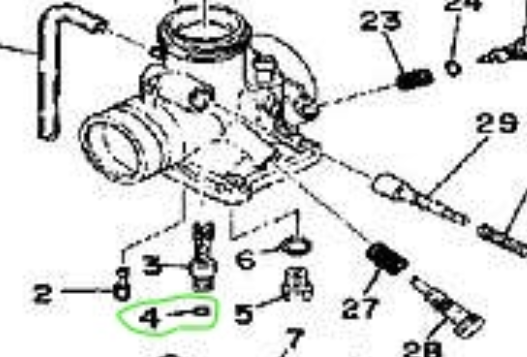

RD4ME Posted October 29, 2018 Author Share Posted October 29, 2018 2 hours ago, tony27 said: When you are changing the needle & seat pay attention to the condition of the o-ring that fits into the float bowl, when these get damaged it allows fuel to bypass the main jet Thanks for the links and additional tips. I inspected the needle and seat and there's no obvious signs of wear - but given that the float does float - it's all I can think of. I believe my bike has the stock mikuni VM26SS which are not easy to get rebuild kits for. I did find a needle and seat at Yambits in the UK - so I have an option there. I will try replacing the the o-ring first - is it #4 below - the one that fits on the main nozzle? Thanks! Quote Link to comment Share on other sites More sharing options...
scifi Posted October 29, 2018 Share Posted October 29, 2018 (edited) Yes it is number 4, but it is a very odd size, not often found in O Ring Kits. ( from memory maybe 4 x 1.5..?) To tell if the O ring is worn, it should be a squeeze to put the float bowl on. If the float bowl just drops off the o ring, then it is too slack. You can use a smear of silicon grease to lubricate the fit. . Edited October 29, 2018 by scifi Quote Link to comment Share on other sites More sharing options...

tony27 Posted October 30, 2018 Share Posted October 30, 2018 14 hours ago, RD4ME said: Thanks for the links and additional tips. I inspected the needle and seat and there's no obvious signs of wear - but given that the float does float - it's all I can think of. I believe my bike has the stock mikuni VM26SS which are not easy to get rebuild kits for. I did find a needle and seat at Yambits in the UK - so I have an option there. I will try replacing the the o-ring first - is it #4 below - the one that fits on the main nozzle? Thanks! #4 is the part. Here is the kit for replacing all the o-rings & bowl gasket, definitely worth doing for the price & should get rid of most carb problems https://www.tytrials.co.uk/trailandtrialsuk/prod_189299-4-9-14-24-Carb-Repair-Kit-TY250-Twinshock.html Could be worth ordering either the ignition tune up kit at the same time unless you plan on upgrading to electronic ignition https://www.tytrials.co.uk/trailandtrialsuk/prod_147767-911-Ignition-Tune-Up-Kit-TY250-Twinshock.html Do you have a manual for the bike, the only 1 for 250s that seems to be easily gotten is from cycleserv for the B model but it works for the later bikes as well. I can check with a guy here in New Zealand who sells copies of manuals to see if he has ever copied the genuine Yamaha manual if you need 1 Quote Link to comment Share on other sites More sharing options...

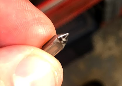

RD4ME Posted October 30, 2018 Author Share Posted October 30, 2018 Thanks Scifi, Section and Tony - this has been so helpful! I swapped the o-ring on the main nozzle tonight - still leaks so that's off the list (and it did fit because I can feel the resistance when I put the bowl on). You can see the scoring on the needle - I'm really hoping that's the cause of my leak. I found a place in the US (jetsrus) that stocks parts for the Mikuni VM26SS - so might get lucky going that route. I'm fortunate that my bike came with a well used owners manual - it's quite detailed and ha been very helpful. Quote Link to comment Share on other sites More sharing options...
tony27 Posted October 30, 2018 Share Posted October 30, 2018 That grooving would definitely cause your leaking issues, new valve & needle will seal & lower the fuel level to where it should be The o-ring wouldn't be the cause of the overflowing but may help with the lack of snap if you're getting main jet bypass Quote Link to comment Share on other sites More sharing options...
