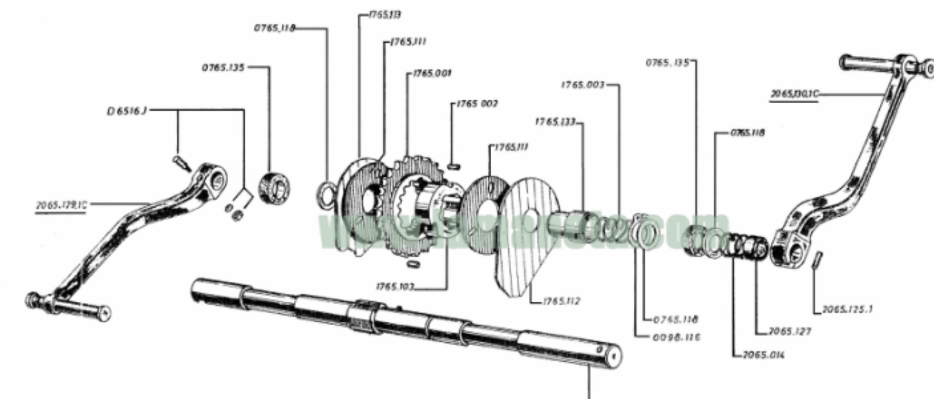

Can anyone please describe in a nutshell how the kicker mechanism functions on the Cota49 ?
All we have is this diagram to go by.
On our Cota49 there is only one pedal.

If you could explain the kick mechanism.
Gracias.

As much as I know the basic principle is that the bike is supposed to be ridden like a bicycle.The assembly in your picture when assembled properly (mine is a sealed unit that doesn't come apart) should allow the pedals to be locked in place while the engine runs.
the pedals have a locking device that lets both pedals fold around so they are not 180 degrees apart.
Hope that makes sense, I'm not sure if I understand that myself.

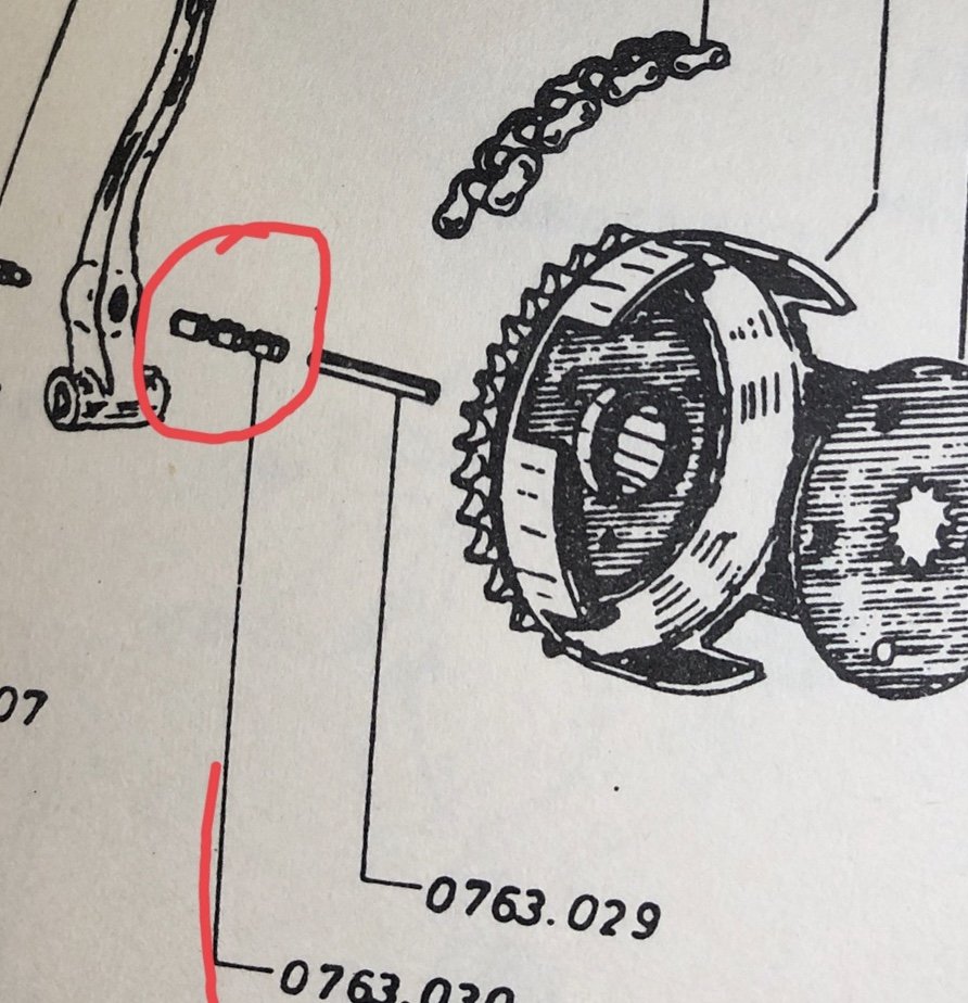

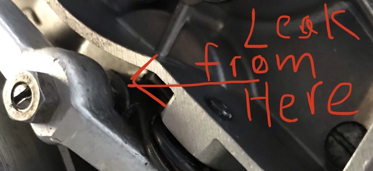

Our Cota49 leaks oil from the clutch actuating pin’s passage on the left side of engine. There seems to be 2 slots on one of the pins that looks as if there ought to be 2 Orings. Any idea on what we can do to stop the oil leak? Not sure if Orings are specified.
Thank you.

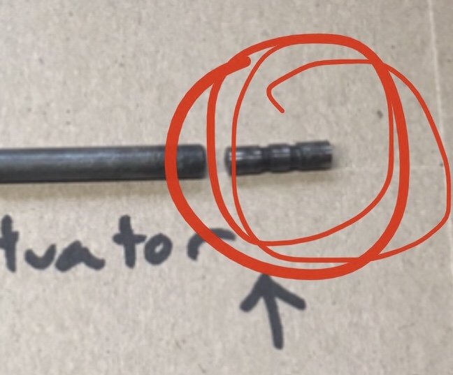

Hi fellows. Still haven’t got around to addressing this issue. We did hear from a Montesa fan in Spain that actually drilled out the passage’s diameter to allow the O-ringed mini shaft to fit in.
The passage is a hair above 5mm and not too sure if there is a way to ream the passage and maintain a smooth round surface so O-rings will glide as mini shaft moves laterally.
Any ideas?
thank you.

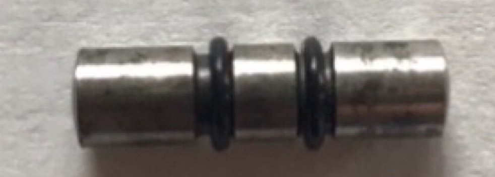

Here is the small shaft with O-rings. Unfortunately this configuration does not fit into passage.
Perhaps a squared shaped O-ring would work if they exist
