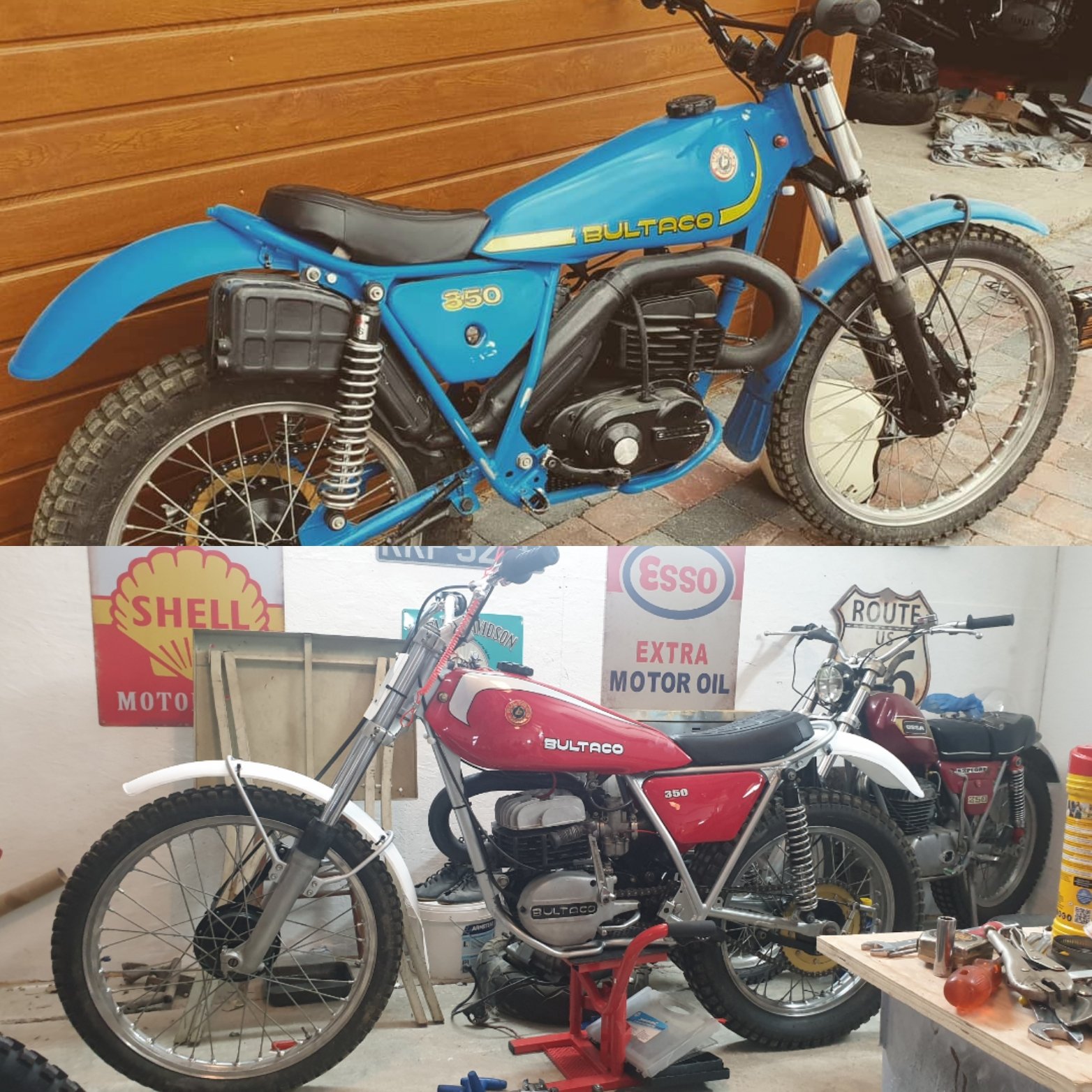

October 13, 20197 yr First bultaco I have purchased. When i done me homework and realised how it was meant to look I knew what had to be done ? Cheers to the guys at Inmotion (Bultaco uk) for the advice and parts.
October 13, 20197 yr Yes, 45 years old, but still look the business. Really nice, what’s next ? I have 5 various models, just so satisfying to own and work them.
October 13, 20197 yr Author 4 hours ago, johnjsy said: Yes, 45 years old, but still look the business. Really nice, what’s next ? I have 5 various models, just so satisfying to own and work them. Thank you. Got a few things to be getting in with. Either my 360 frontera or the Ossa explorer behind the sherpa.
October 26, 20197 yr Looks great! Is this a 183 1976 350cc Sherpa? Looks very similar to mine. Well, mine doesn’t look as shiny but I’m sure they’re the same model. Great work, does she run ok? Best James
October 28, 20196 yr Author On 10/26/2019 at 11:10 PM, Jcarteradams said: Looks great! Is this a 183 1976 350cc Sherpa? Looks very similar to mine. Well, mine doesn’t look as shiny but I’m sure they’re the same model. Great work, does she run ok? Best James This a model 159. Thanks for the nice comment ? When i purchased the bike it had clearly had some money spent on it in the right areas but had been assembled quite poorly. I got it in a deal with another bike and it was running very poor. After taking it apart and doing some homework i realised it had a worn out carburettor slide (a well known bing issue) I sourced a new slide from bultaco uk and adjusted carb accordingly and now shes spot on, very happy with it. Are you having issues with yours?
