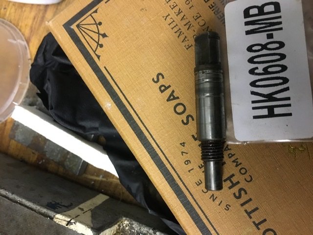

used home made tool to unscrew water pump shaft. The benefit of having the bike on its side is the drive sprocket doesn’t fall into the engine. I dropped a small rod in just to keep it still until I put the new shaft in. Mine needed replacing because the seals had worn deep grooves new shaft cost £80 !

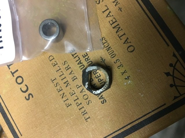

The tool I made was dead simple. Get an M8 nut and drill it out 9.5 mm cut a slice off one side to end up with a D shape 7.5mm across. I welded a bit of metal to close the straight edge of the D and filed it back to a hex. Tap it on stick a socket on it and give it a sharp tap!

inner bearing is HK0608 outer bearing HK1010 ( still in the spares box)
Special tool sounds a bit grand now I look at it

I popped the shaft out after a year and stuck some more grease in. With the ordinary nitrile seals there was no signs of wear. The more recent manuals show this as a 40hr service and 80 hr seal replacement. Will have another look in January.

Yes I saw the shop manual, that is where I heard about the locking bolt. I had a chance to knock the shaft loose today, quick tap and it was free. I looked at the shaft again while it was out and found that the outer seal area was worn more that I could see by just peeking into the seal when it was on the bike and the inner seal area n the shaft was fine . I have ordered a new shaft and a couple of factory seals for now. I may just replace the outer since the inner showed no wear. I'm thinking the inner one probably lasts longer because it gets lubed from the engine oil.

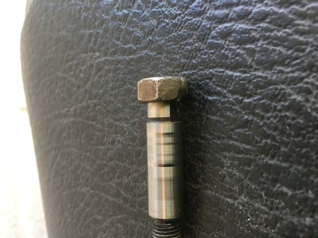

Lock down has given me the chance to do a bit more maintenance, so while the engine is out I popped the water pump shaft out and took the attached pic. The seal surface is visibly polished but no detectable groove or edge you cam feel after two years, probably around 80 hours, Grease was still present with no signs of leakage. Re-greased with red rubber grease for another year.
That shaft still looks very good. That is with using non OEM seals right. Mine just started to leak again (OEM seals), maybe 50 hours. I haven't taken it apart yet to see if the shaft is worn or the seals are faulty, kinda bummed it happened so quick. I will update you on what I find. Thanks for your update.
