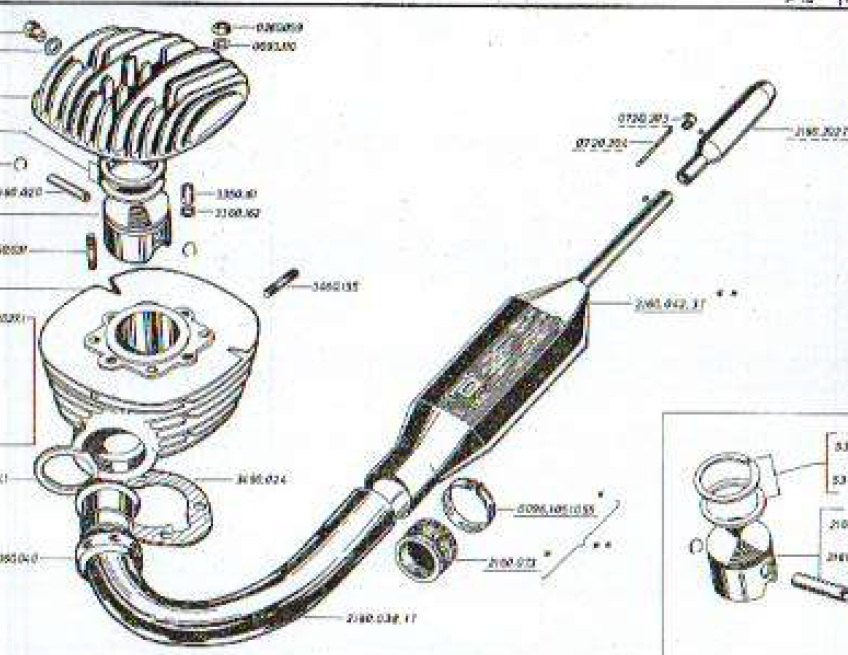

Hi, I'm trying to get hold of an exhaust silencer for my Cota 247. In the attached picture it can be seen top right.
I've tried most of the usual sources but have had no luck so far.

These occasionally come up second-hand on eBay. You can get a WES replacement, I think In Motion Trials do them, but a much lower cost alternative is a Volkswagen Beetle tailpipe, again on eBay for about a tenner. It's a direct fit on the exhaust pipe and easy to make a bracket to secure to the silencer mounting on the frame. This was a well known mod back in the day, even the works riders used them.

What year are we talking about here? This parts pic is really old, maybe '70 or '71, I don't really know. It's gunna be annoyingly loud with that type of silencer.

Mine's a '79. Has the mid section box as in the diagram but it's a welded up one piece system up the point where the back box fits. The pipe at that point looks narrower in the diagram but would be easy enough to make a spacer/sleeve to fit the tailpipe.
