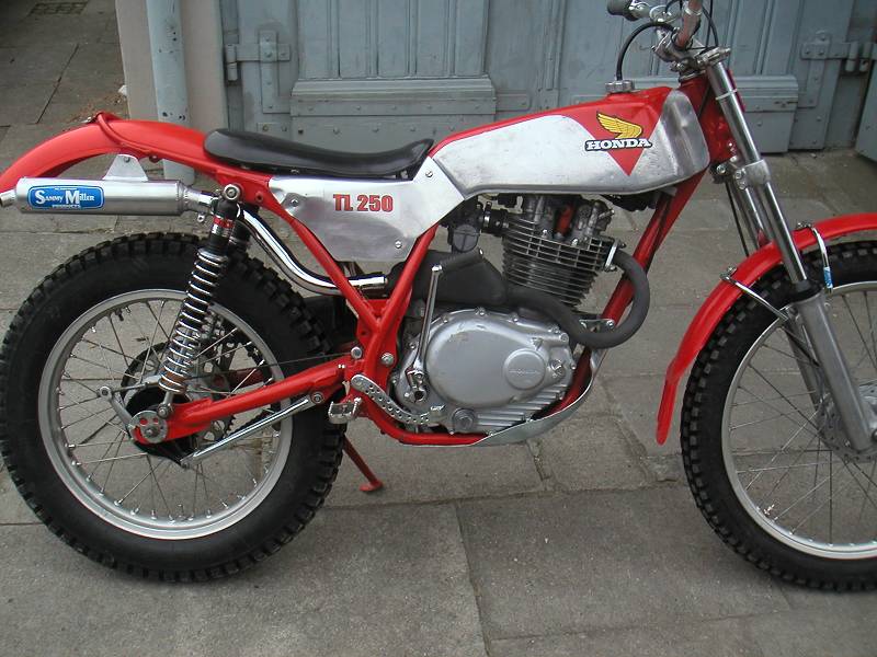

patrick , i just bought a sammy miller tl125 exhaust (tail pipe and middle pipe) for my tl 250 it will not bolt straight on to the original front pipe, i was wondering what alterations to the exhaust did you do to make it fit, really enjoyed the photos and video clips,
alan
:P Hy Alan
Do you ride your TL 250 in Trials ?

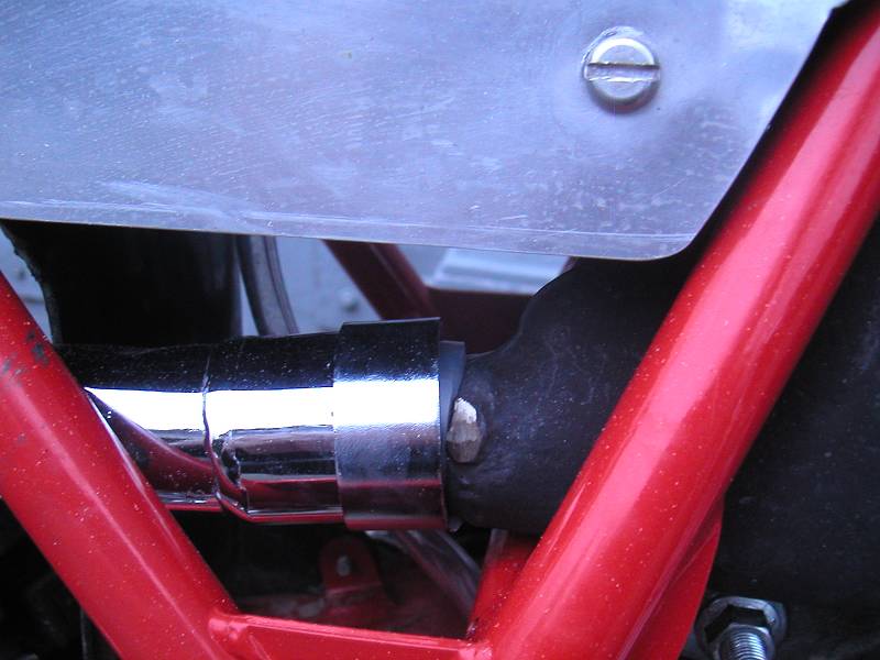

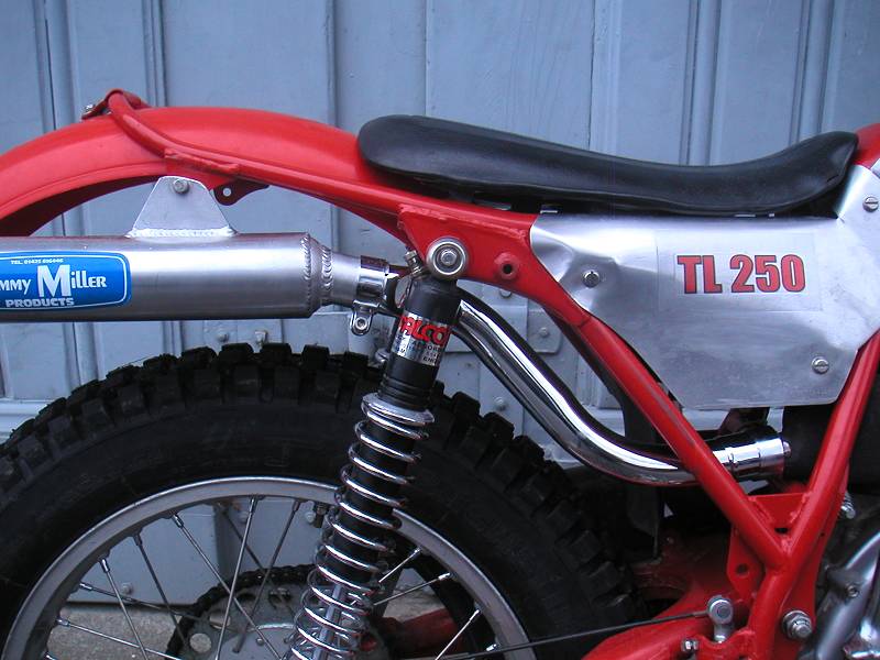

SMiller Exhaust fitted to TL250: I sew 1-2cm of the original pipe after the small exhaust. The Swan Neck has to be bent e little bit down (abaout 1cm)and maybe a little towards the shock. I used a piece from a silicon tube (ok till 200 Degrees ?, have not ridden yet in summer heat)an popped it on the remaining (shortened 1st exhaust tube), used also some silicon spray. This allows to vary the angle and you don't have to bend the swan neck too much.
Here a pic
Hope it helps
Patrick
Here another pic
