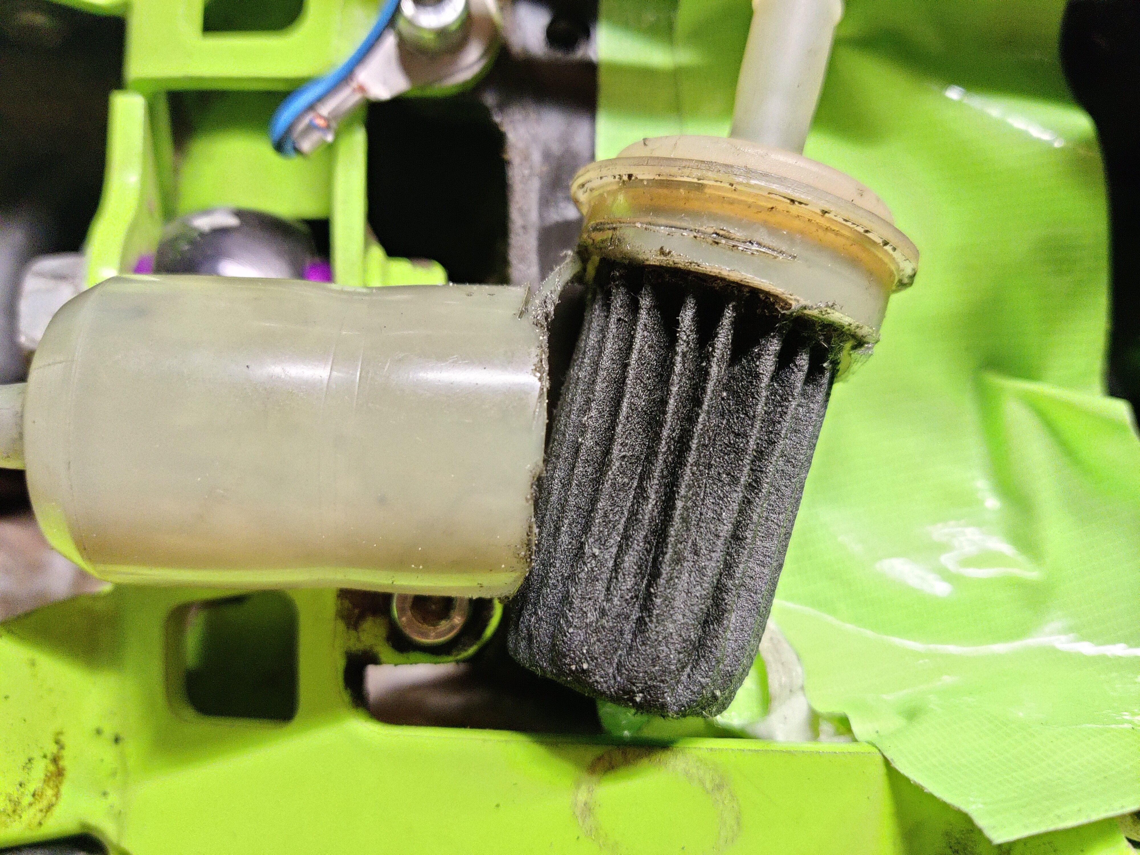

There is a pump and filter in the fuel tank and I believe early bikes can leak causing the engine to run lean.
Mine did it, not sure what the fix was as I took it in to be fixed though I read it's either the filter pipe connectors or the pipe itself.
The pipe clips aren't great as the one on the top of my tank started dribbling recently when the engine was running.
See this post for what the pump and filter looks like.
There are a few posts regarding Vertigo fuel filter or Vertigo fueling problems that other owners have started.
