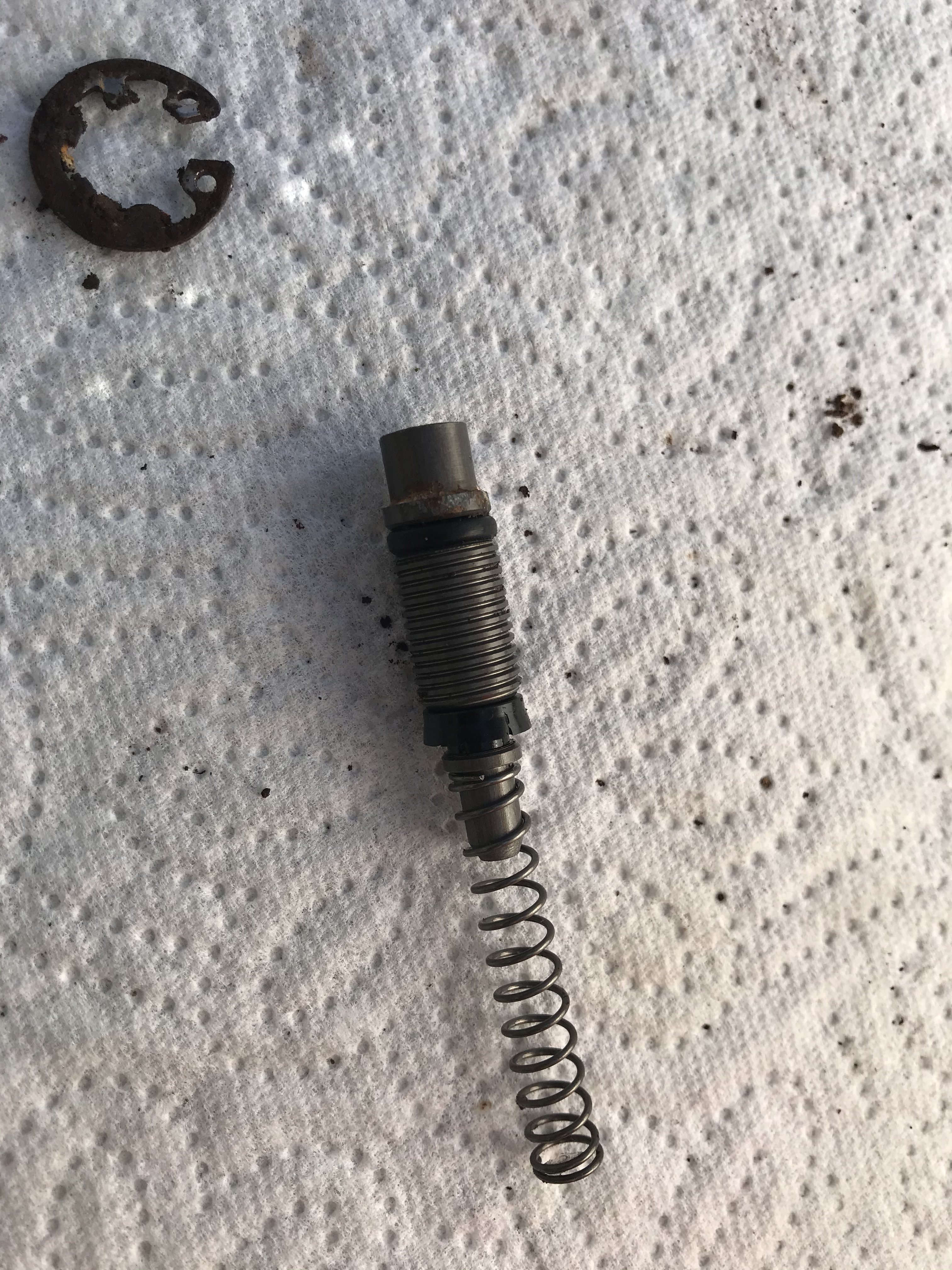

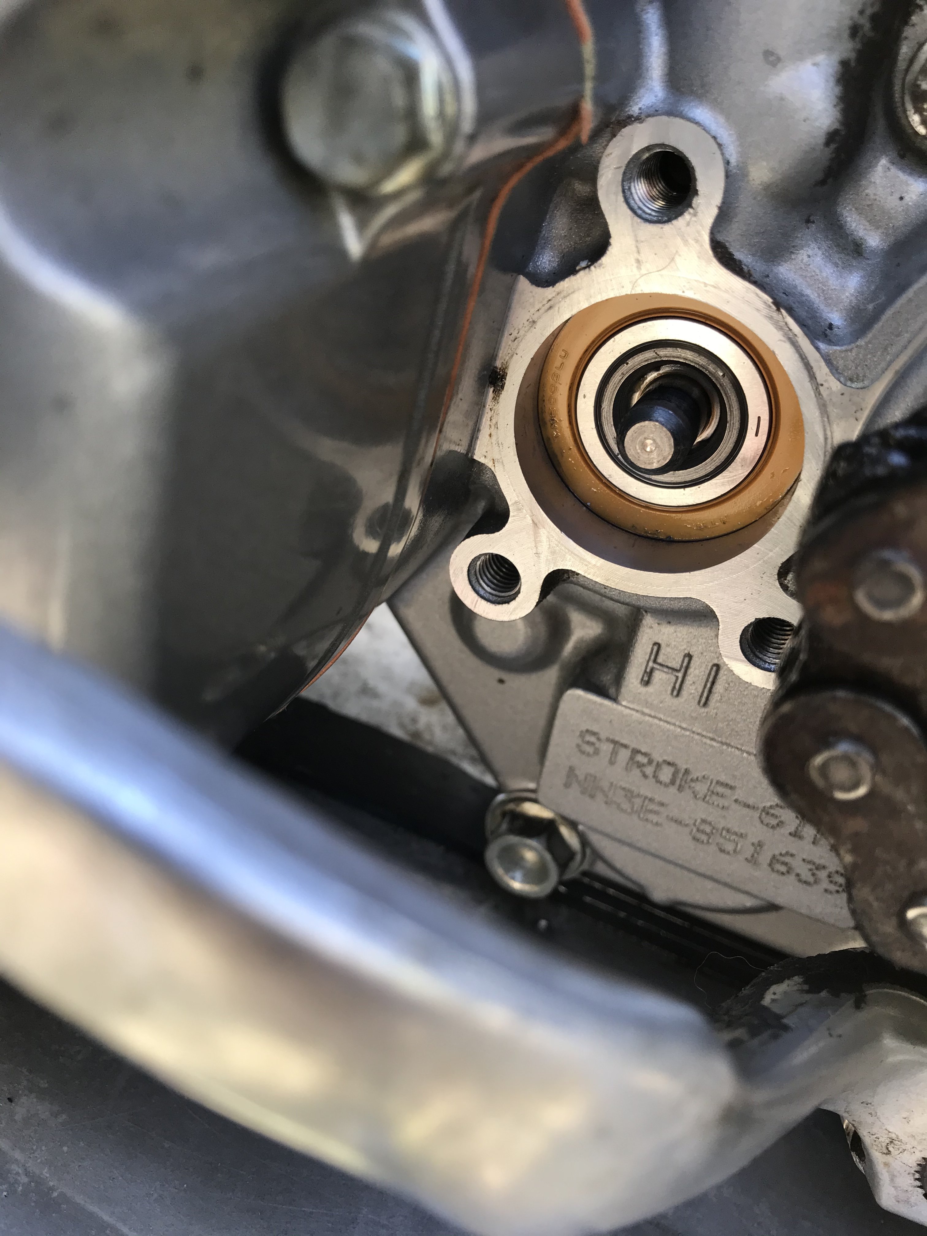

March 23, 20206 yr Author I have pulled apart the master cylinder, was a bit rusty at the other side of the lever dust cap. The seal does have a little mark in it, not sure if this should be there as it is no crack. At the engine side/ push rod side of the Slave pistion was again a bit of oil. This is no brake fluid as I thought it was but transmission oil. Is this normal? I think it comes through the hole of the push rod when this moves. I have pictures attached Edited March 23, 20206 yr by Robert J Pictures added
March 23, 20206 yr Doe the fluid level in the master cylinder reduce?If not neither of the cylinders are leaking.Id be looking at the clutch itself,bet the clutch basket is notched and rough where the clutch plates contact it.The clutches on these used to drag when new,not as badly as yours is though.Steel plates might also be warped too.Look on the Montesa forums on here,bet there's loads of information
