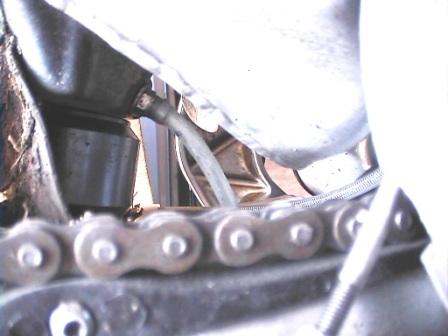

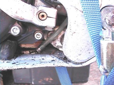

If you ride a lot of deep water I would recommend fitting a drain pipe to the air box (just in case!)
Buy a valve stem (rear wheel).
Drill a hole at the front and bottom of the airbox (same diameter as the threaded stem).
Poke a straightened out wire coat hanger down into the airbox and out through the drilled hole.
Thread the valve stem over the wire and wiggle it down until it pops out of the hole you just drilled.
Fit the nut and then cut the threaded stem down to about half the original size (don't throw the offcut away).
Unthread the nut to clear off any sharp burrs.
Refit the nut and tighten it all up (no need to seal it but I suppose it wouldn't hurt to use some silicone)
Fit a length of clear piping to the threaded stem.
Thread it towards the front of the bike and down towards the back of the gear lever and let it hang in the sump guard area.
Fit the threaded offcut into the end of the pipe and replace the dust cap.
After each submarine expedition, simply glance at the clear pipe to see if any water has been collected. Remove the dust cap to drain and then refit :P
There's no way that I could come up with something so simple and effective I'm afraid :P
I sneaked into Silsden HQ and watched Griffo prepping the Team Beta bikes for last years SSDT - I'll try and post a piccy later...

thanks for posting the pics as well kinell...
