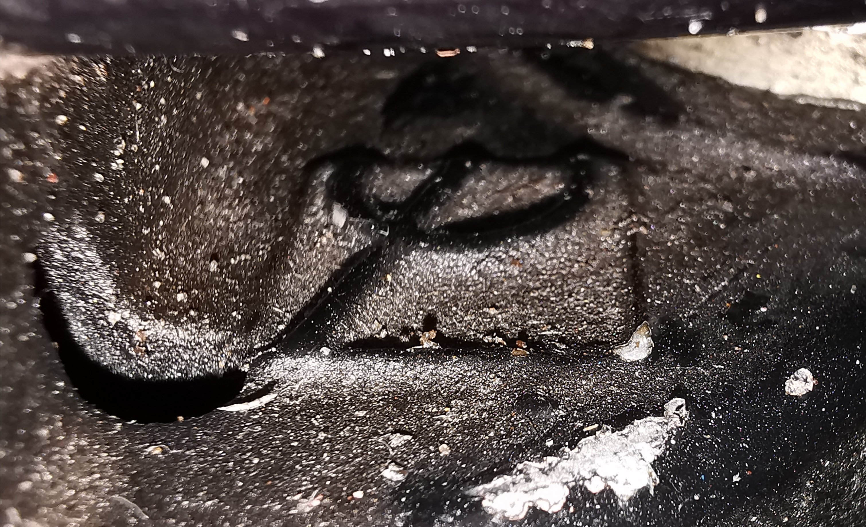

It's some random 35mm forks that's on the bike but I'm 95% certain it's the original yokes that's on the bike. There's a funny logo on them that I haven't seen before, I'll try to get a pic of it.

The sign is the Marzocchi logo so it is a Marzocchi triple clamp or yoke and such a fork you need too if you want to stay original.
