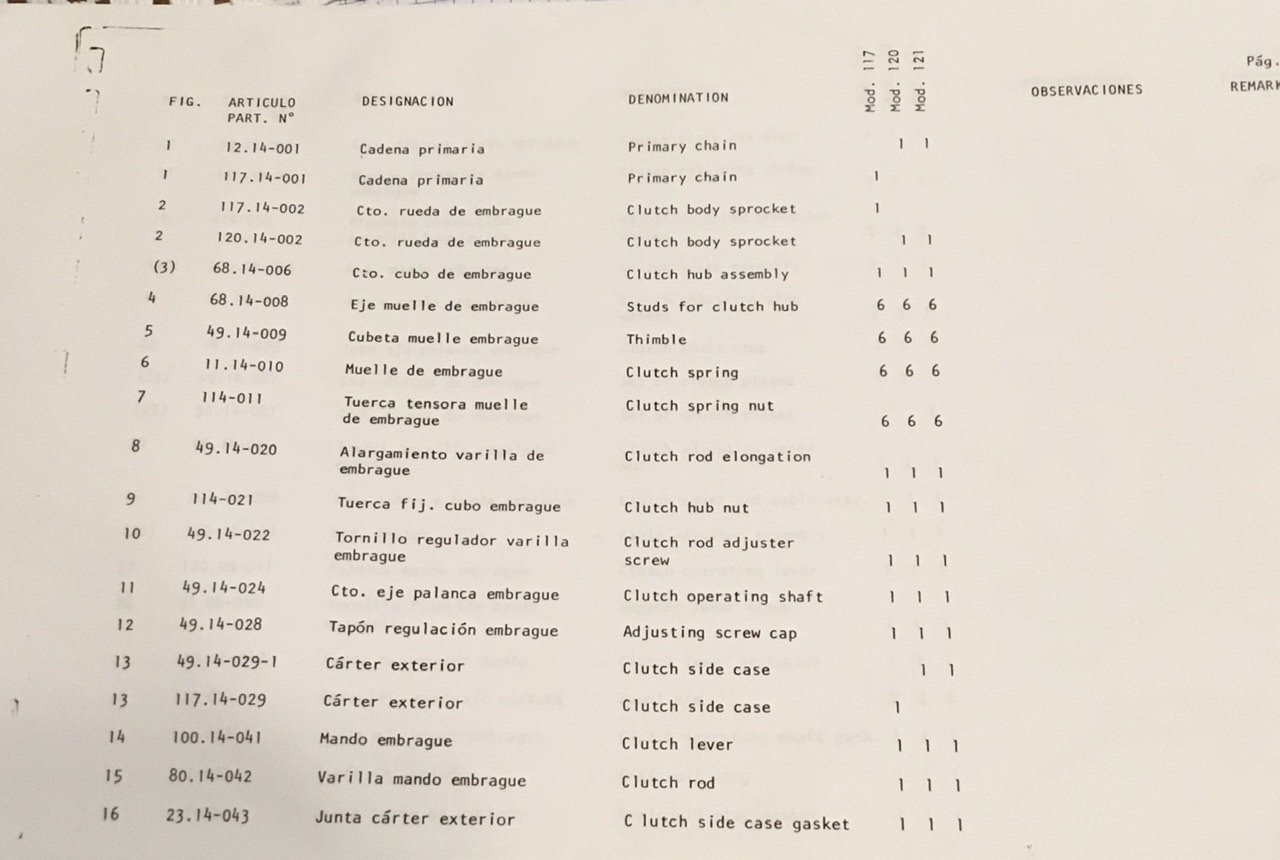

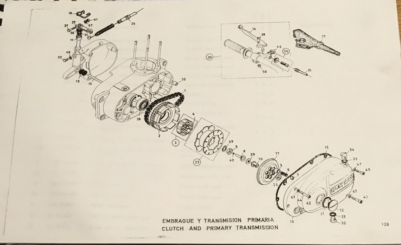

The model 120 and 121 are the same according to my parts book. Inmotion might be able to tell you if an MK6 would work. I would bet that its the same.
Thanks Scot Taco, yes the 250/360 are same part number it’s just there seems to be a lack of Mk7 in general. I’ve tried InMotion, they didn’t have a Mk7 and I was waiting on them getting back to me with some info as to other marks being a possibility. Hope to hear from them soon but they are extremely busy and I didn’t want to miss out on Something which is for sale just now and may be suitable. If I can’t get a suitable basket it puts the whole rebuild in question....there are brand new ones being made in Spain but Mk10 onwards. The options all seem to be either Spain or USA and if it have to buy from there I want to be 100% sure it’s the right fitment before I buy.
