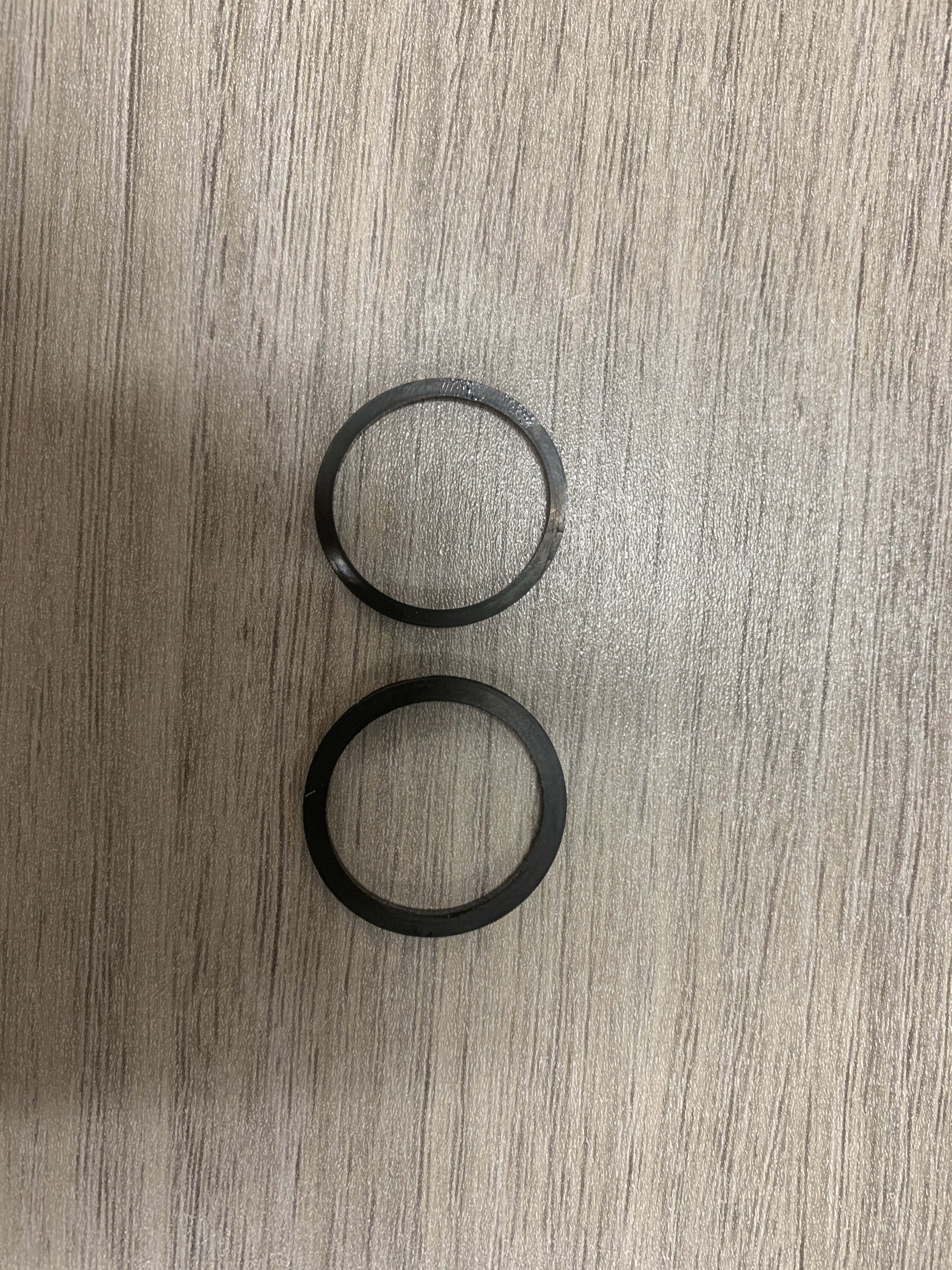

matgriff Posted February 2, 2021 Share Posted February 2, 2021 (edited) Hi, I recently purchased a nice 2009 290 to start getting back into off road riding. It's tidy but needs some small jobs doing on it, one of which was a sticking front brake. I stripped the caliper down, removed all the pistons and seals, cleaned it in my ultrasound cleaning bath, and bought a new piston & seal kit.... all good so far..... however I had a right job trying to get the pistons back into the caliper halves with the new seals in place. Everything was spotless and lubricated with clean brake fluid. I eventually got them in, however I soon found out that I'd nicked a couple of the seals when fitting the pistons. When I came to bleed the brakes using my vacuum pump, it was sucking air in past the pistons ? For info it's a AJP 4 piston caliper. I've ordered some new seals and will try again, anyone else attempted this ? if so do you have any tips to pass on ? thanks Mat Edited February 2, 2021 by matgriff typo Quote Link to comment Share on other sites More sharing options...

matgriff Posted February 2, 2021 Author Share Posted February 2, 2021 (edited) 1 hour ago, totty79 said: Use a small mirror to check the seal groves in the caliper as you can't see it all directly. Any muck or corrosion in the grove will make the seals too tight. Hi, thanks yes I'm sure they are clean, I put the caliper halves in my ultrasonic cleaner tank for 30 minutes, came up spotless. In hindsight I used a bit of red rubber grease on the new seals, maybe that got behind the seals enough to stop them pushing right back into the grooves ? I'll just use clean brake fluid next time. Mat Edited February 2, 2021 by matgriff Quote Link to comment Share on other sites More sharing options...

matgriff Posted February 2, 2021 Author Share Posted February 2, 2021 (edited) I have it figured out, the new seals are slightly smaller and thinner and fit correctly ? however the one i pressed home with the wrong seal was stuck and i had to damage the piston getting it out ... oh well the ebay seller who sent the wrong bits can send me a new set of pistons ... at least i have the right seals now Edited February 2, 2021 by matgriff 1 Quote Link to comment Share on other sites More sharing options...
