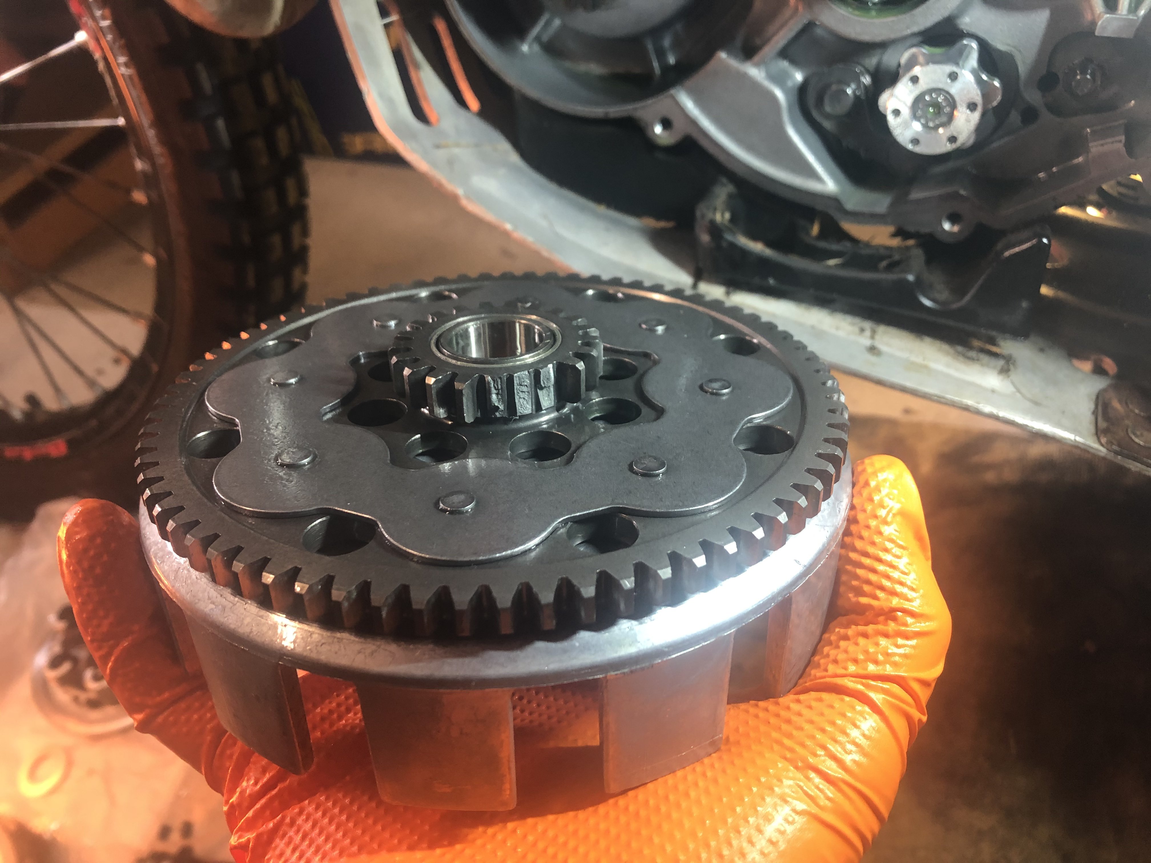

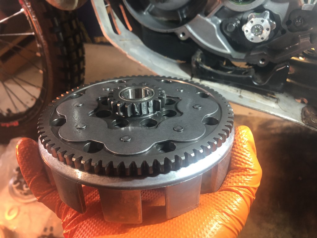

I took the clutch off and found it’s not a problem with the kick start mechanism itself but the kickstart drive sprocket on the back of the clutch basket (see photo) which has lost three teeth. So the kickstart drive just not catching on the main drive.

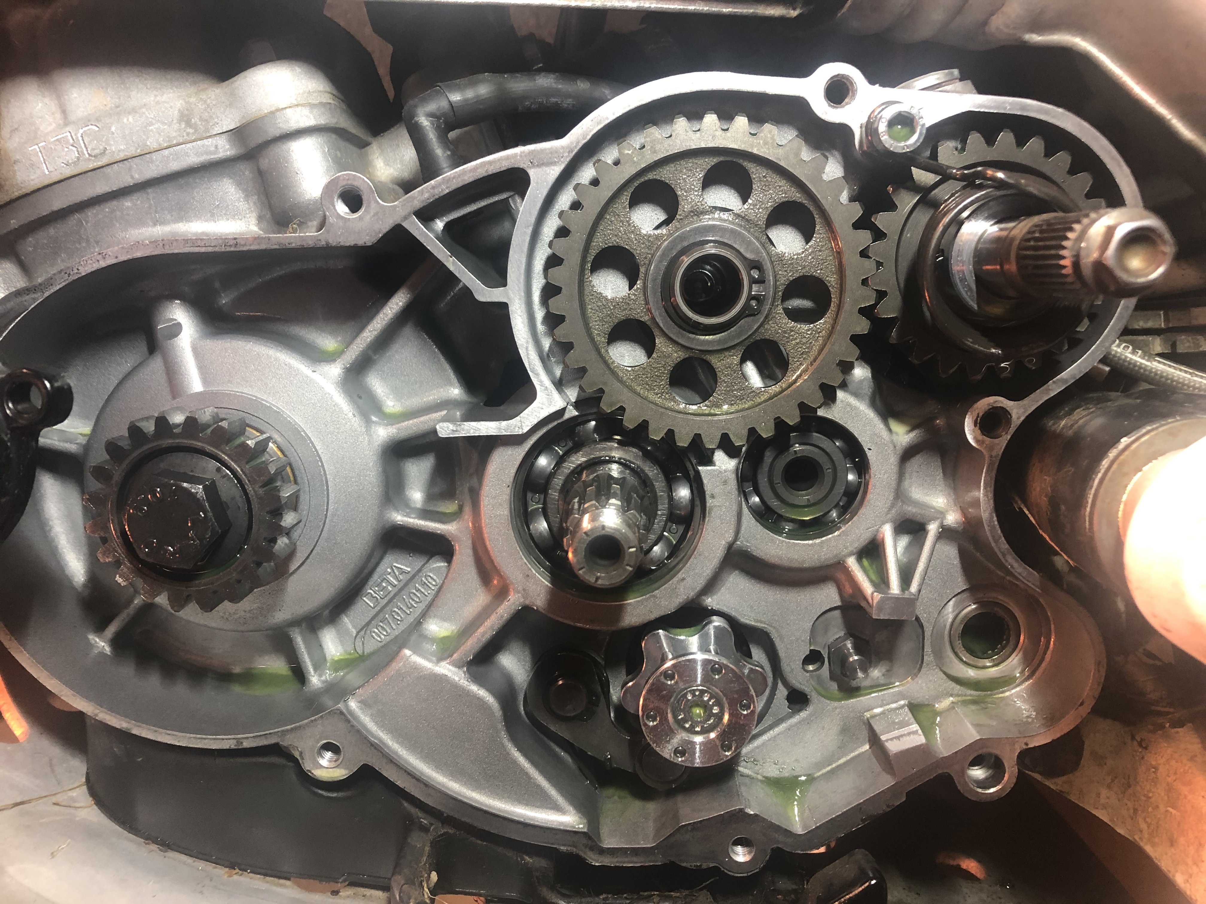

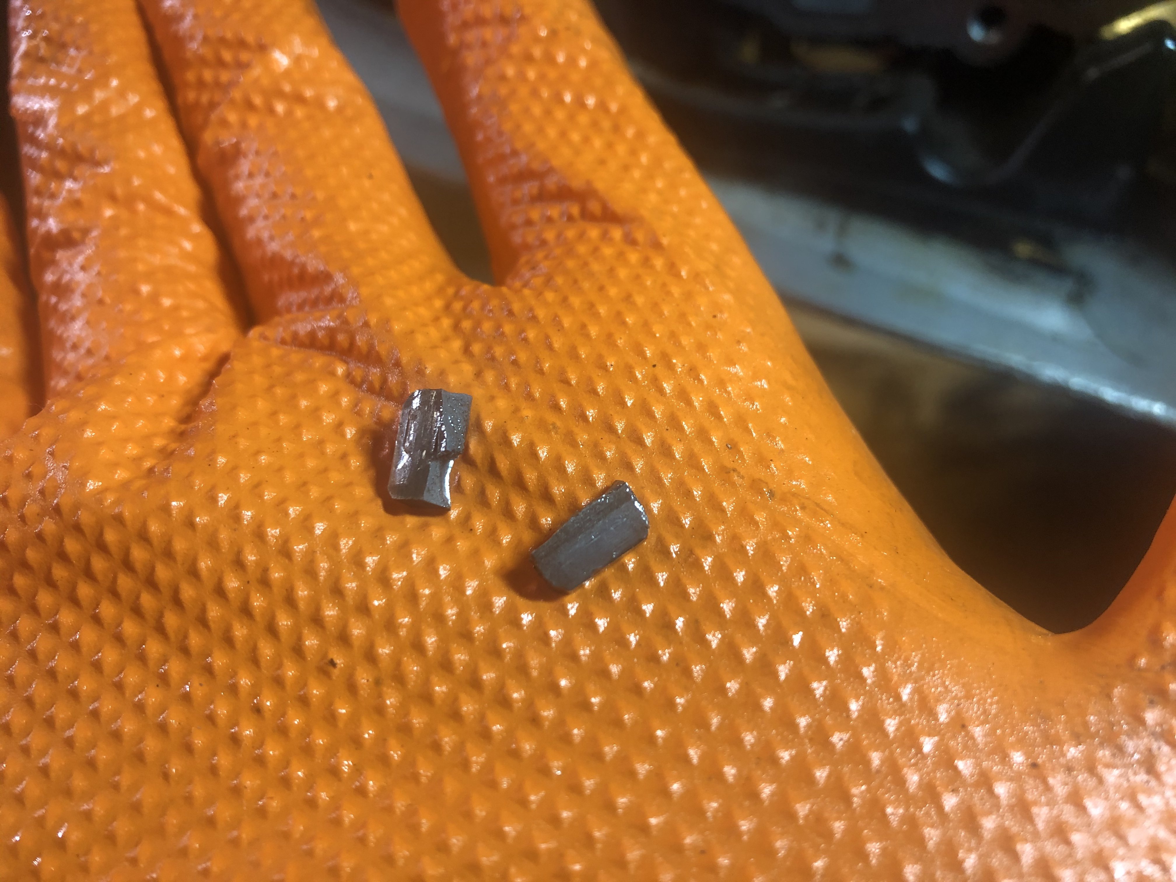

2) I can only find 2 of the 3 missing teeth on this side of the engine. (Pic). What’s involved in finding the last tooth? Where to start looking? How to go about it? How big a job is it?
if it’s a huge job - is there any sense in putting it back together and leaving the tooth in there or is it very likely to trash the gearbox and just not worth risking?

In part answer to my own questions, it looks like the clutch basket and main / starter drive sprockets are one piece. Though looking at the parts list, BetaUK don’t seem to have one in stock which surprises me.
looking at the workshop manual link rcgods kindly provided, looking for the lost tooth in the gearbox will mean splitting the crankcase which I presume is an engine out job ? I presume you can’t take the gearbox side of the case with the engine in.
My main question now is wether to hunt further for the lost tooth. I’m presuming I should.
anyway thanks to those of you who can comment.
Just because you can't find the third piece now doesn't mean its still in the cases.  It could have come out with the oil at some time.
My Evo lost two teeth from a gearbox cog and I only found out when they came out with the oil.
Before you split the cases I would give the engine a shake and see if you can hear anything.  One of those telescopic magnetic tools might help get it out.
The only way you will be certain it's not inside will be to split the cases!

Got the new part from BetaUK (£300 - gulp) and a fresh clutch case seal. Refit everything with Part manual diagrams to be sure everything going together correctly.
Filled the case with Diesel (literally full), bounced it round, turned the engine over with the ignition off and drained the diesel, then standard fill with oil and this time ran  / rode it for 20 mins and drained the oil before another standard fill with oil and went riding (or at least my boys did) with no problems. Prob change this oil after an hour or two.
My impression is that I broke two teeth and found them pretty quickly in situ but suspect (as you said Stu)  the third tooth has been gone for a while (perhaps even in previous owners time) and is either 'dust' or came out one way or another with an oil change some time back (or at least I hope it did).
