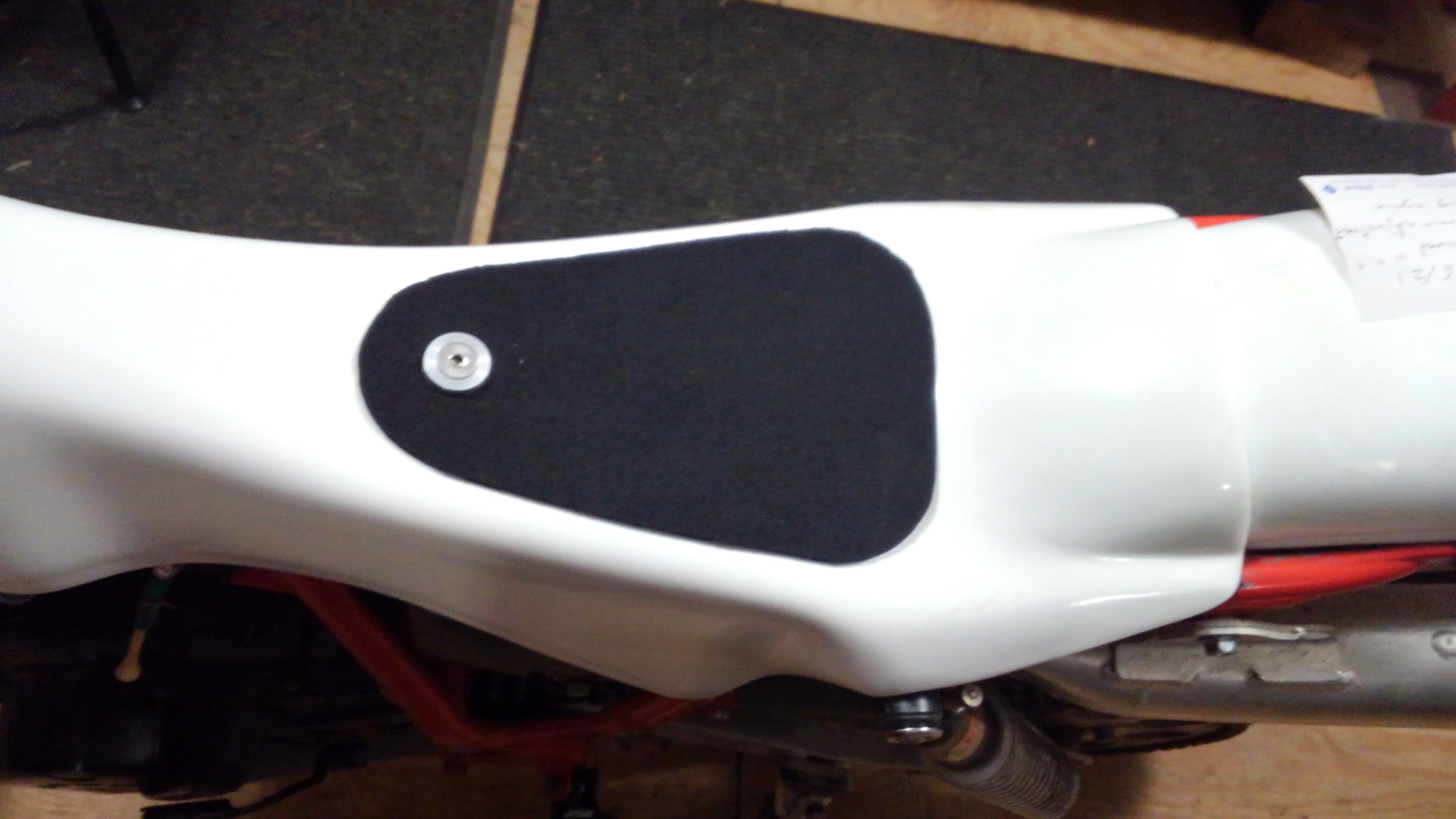

stevec Posted October 16, 2021 Report Share Posted October 16, 2021 (edited) On 10/15/2021 at 5:46 PM, Ftwelder said: "I was thinking about using colored adhesive backed kitchen shelf paper for a saddle." I used closed cell, adhesive backed neoprene foam sheets like these:https://www.amazon.com/Sheets-Adhesive-Neoprene-Insulation-Vibration/dp/B08P1W9QQD/ref=pd_lpo_2?pd_rd_i=B08P1W9QQD&th=1 . I went with 1/8" thick but 1/4" would work too. Easy to trim and looks the part. Edited October 17, 2021 by stevec 1 Link to comment Share on other sites More sharing options...

Ftwelder Posted October 19, 2021 Author Report Share Posted October 19, 2021 (edited) On 10/16/2021 at 6:20 PM, stevec said: I used closed cell, adhesive backed neoprene foam sheets like these:https://www.amazon.com/Sheets-Adhesive-Neoprene-Insulation-Vibration/dp/B08P1W9QQD/ref=pd_lpo_2?pd_rd_i=B08P1W9QQD&th=1 . I went with 1/8" thick but 1/4" would work too. Easy to trim and looks the part. That looks nice! wear a cyclist bib shorts under my pants but will probably go bareback before adding anything. I used a 3/8' thick closed cell neoprene floormat on the OSSA and it needs to be cut back.. Edited October 19, 2021 by Ftwelder Link to comment Share on other sites More sharing options...
