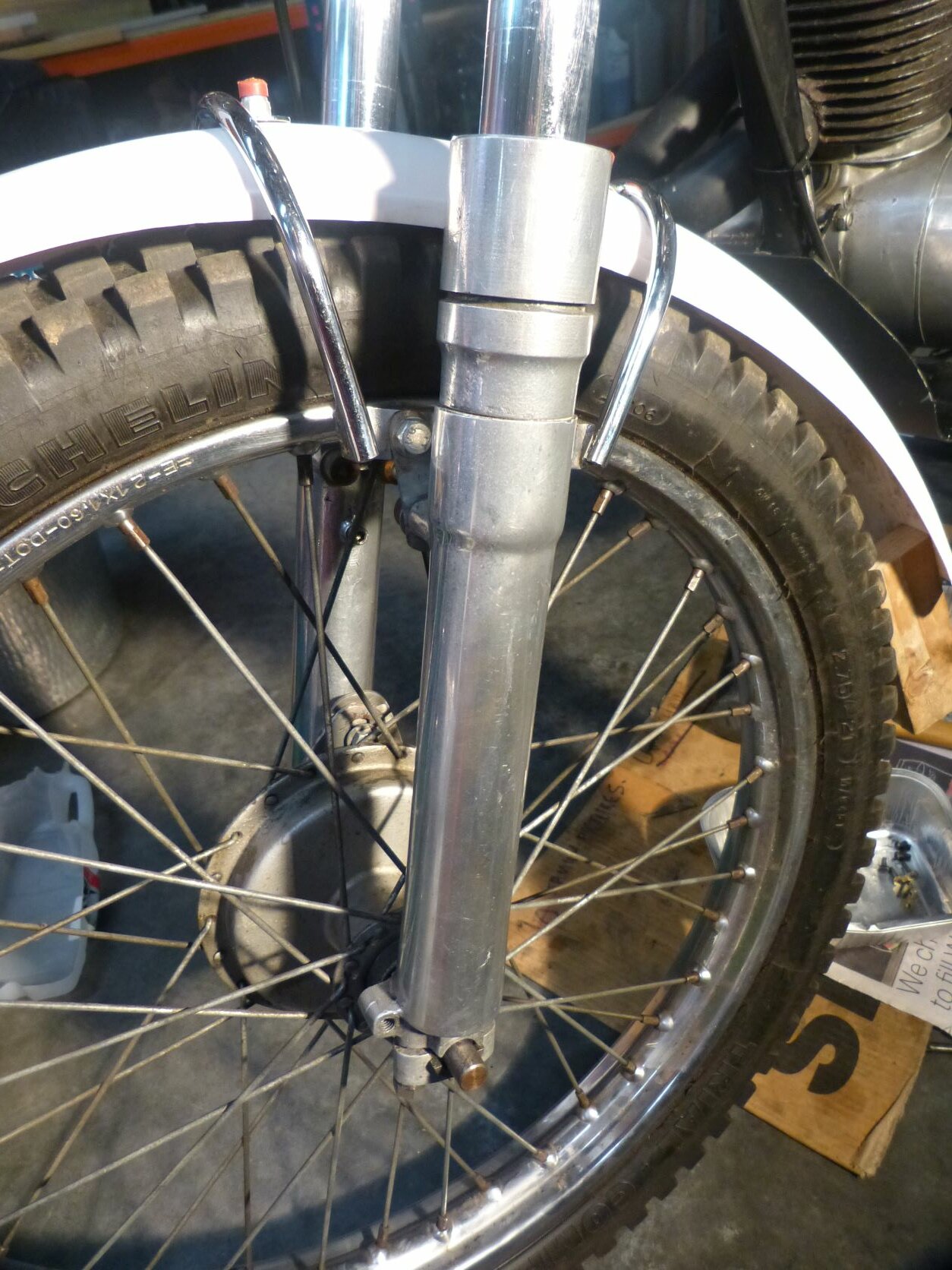

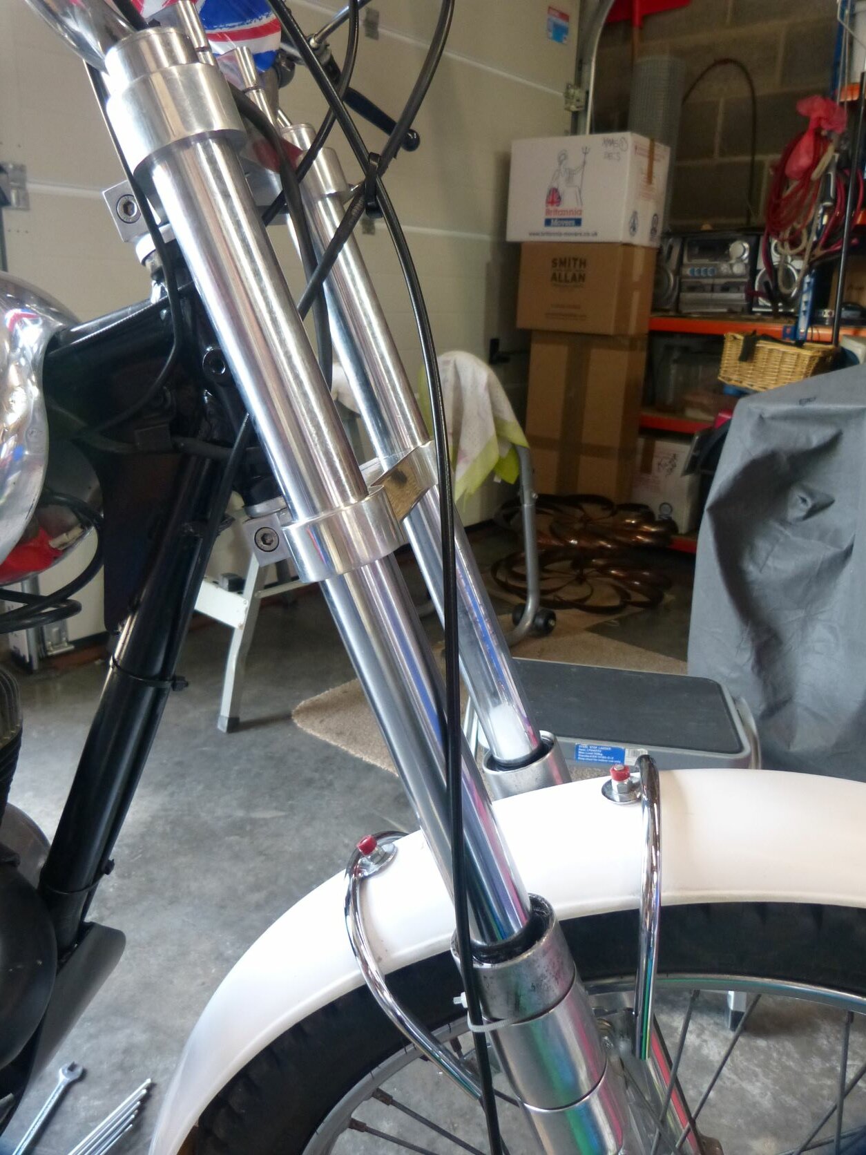

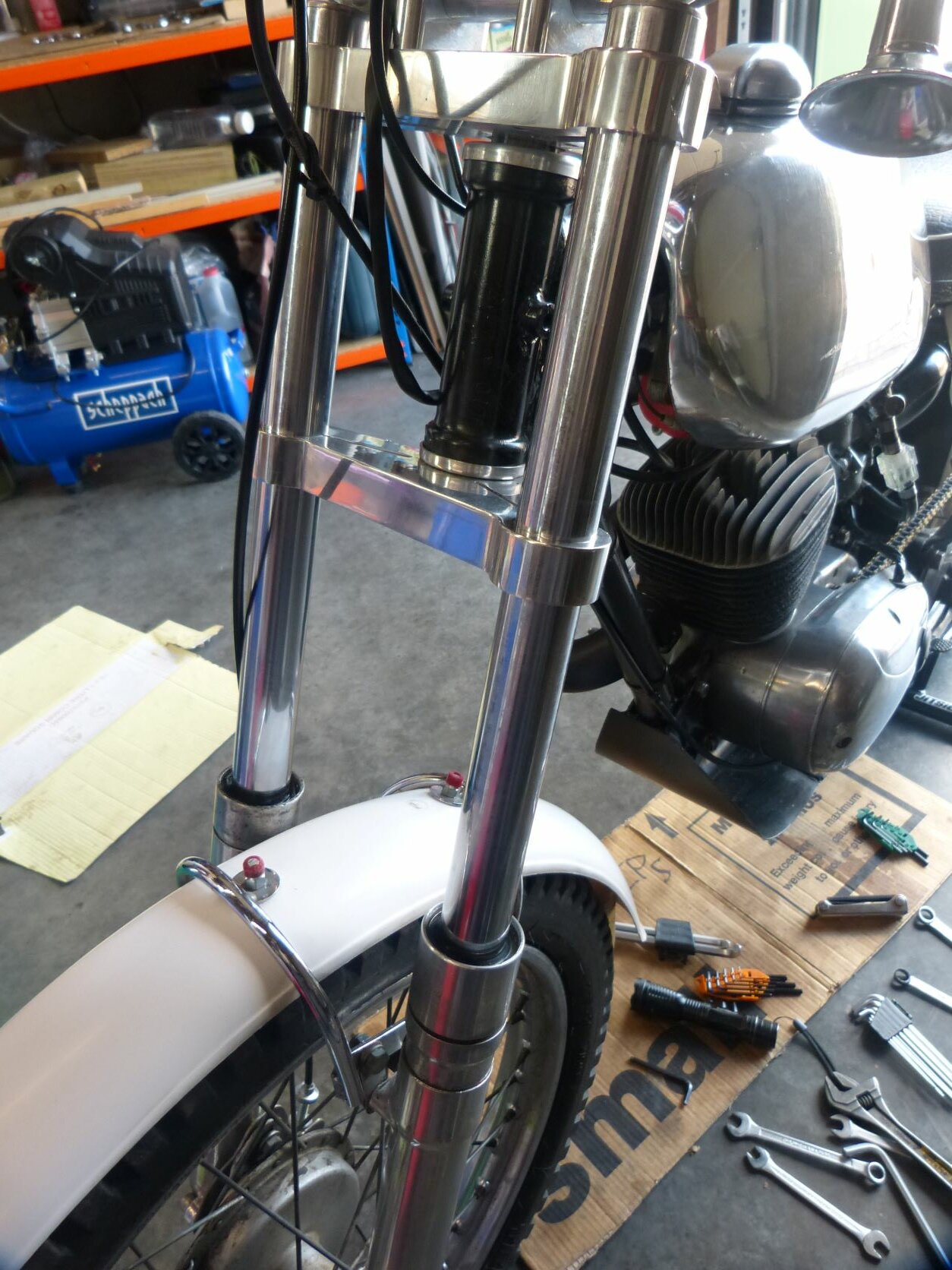

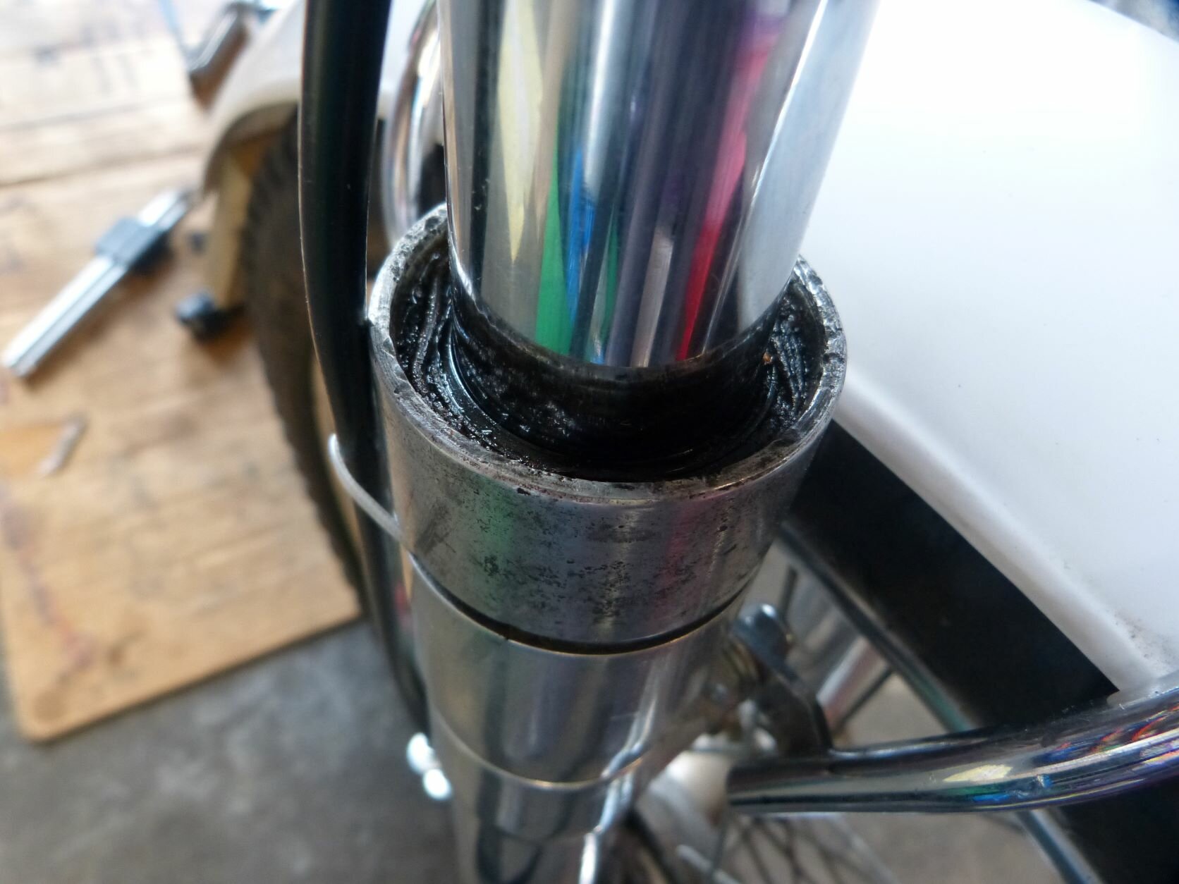

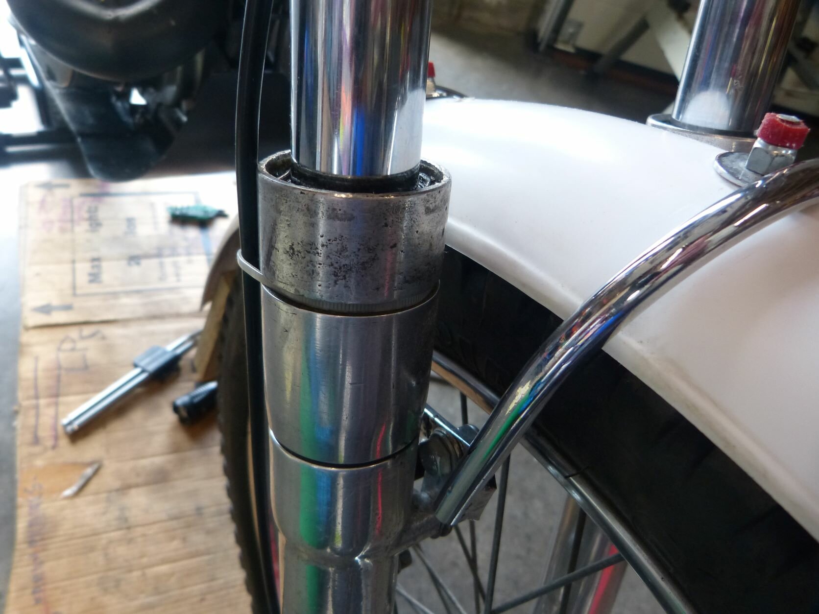

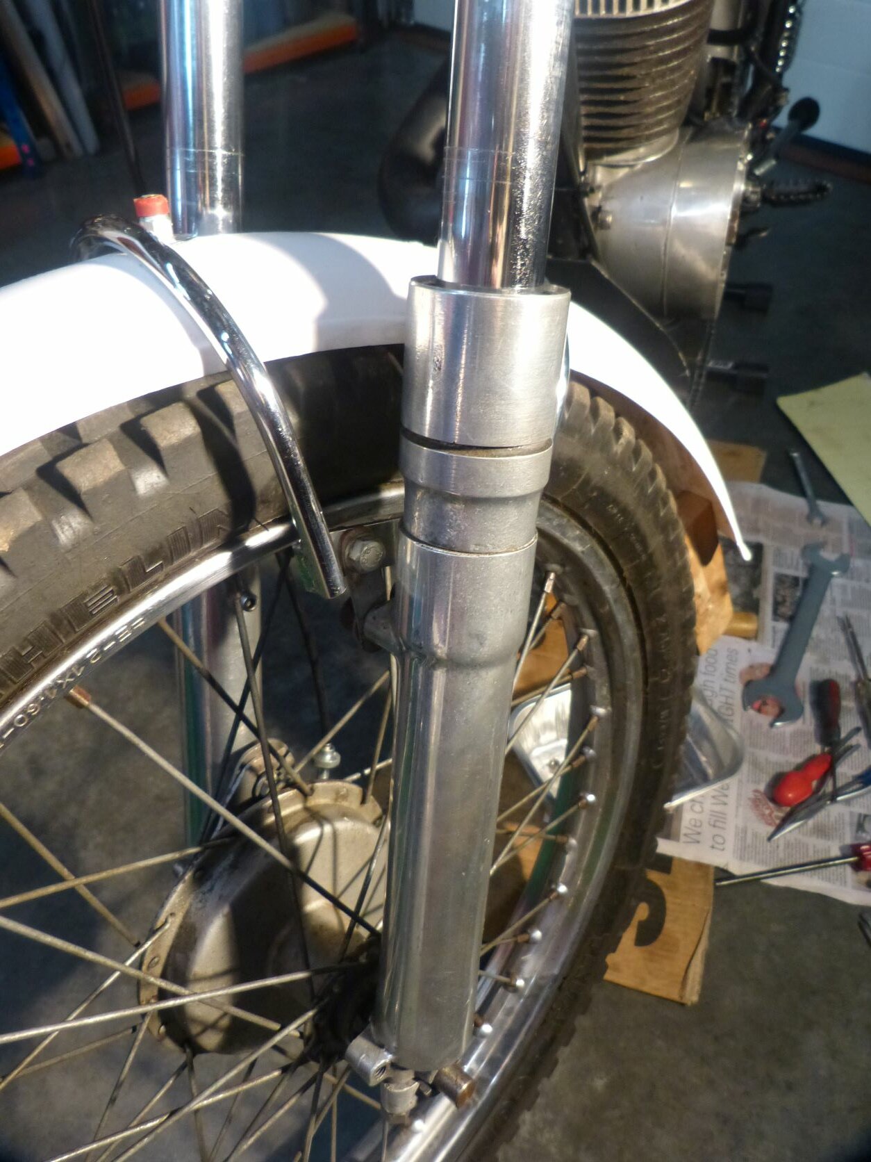

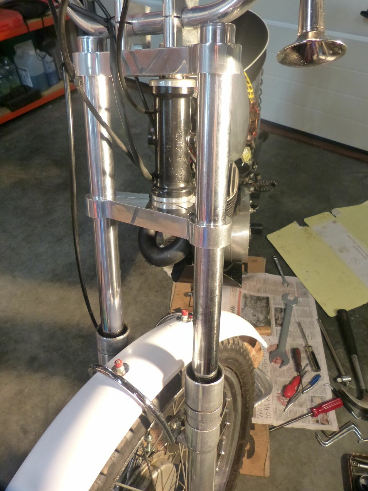

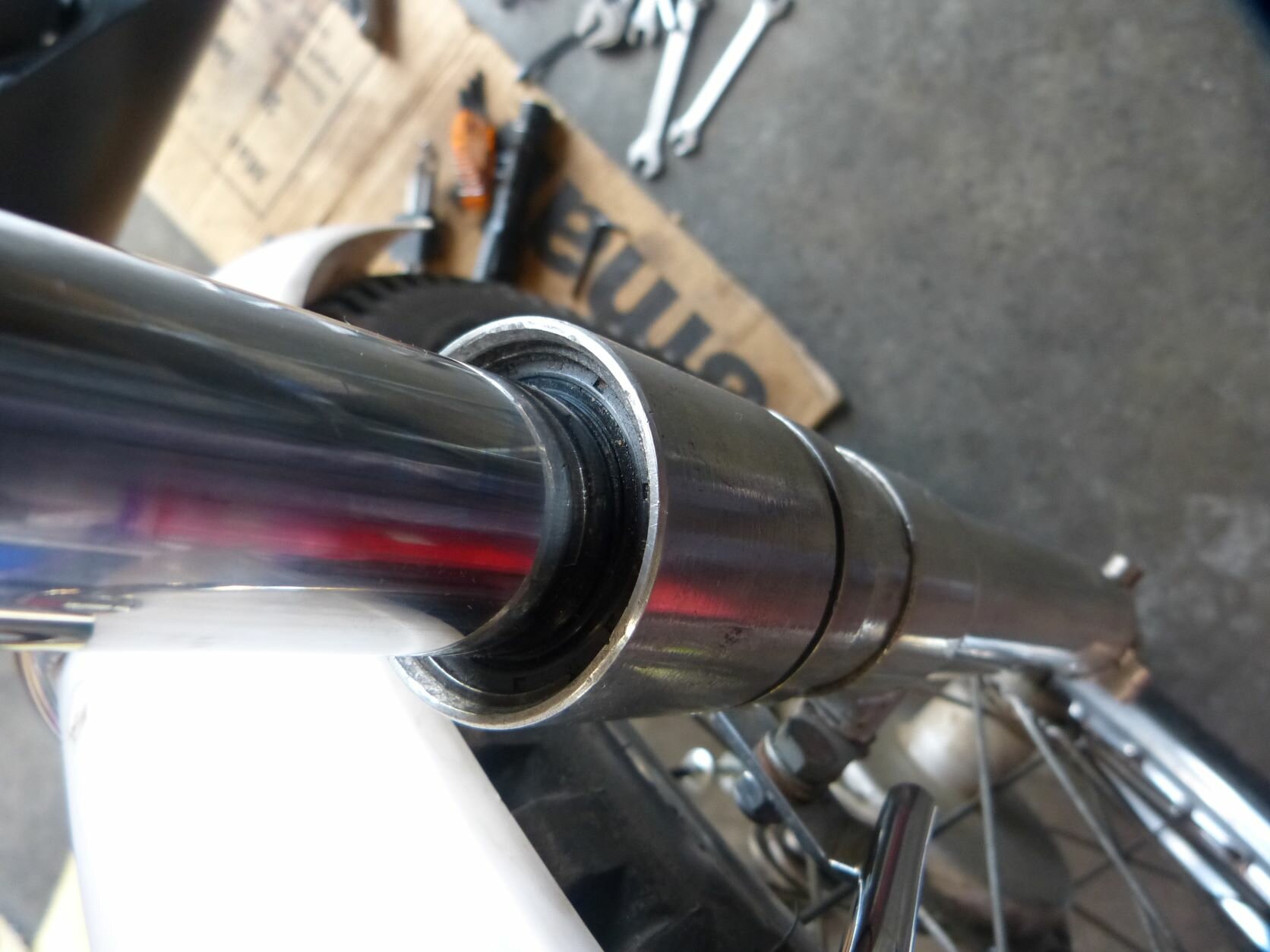

Hi, I've got a Bantam with replacement front forks/yokes - one of the top oil seals is knackered and I'm trying to identify the make of forks, does anyone know the make or where I can source a replacement seal. See attached photos.
Thanks Elliot

Hi, thanks for the advice. Doing a quick measurement, with the forks still in place, the diameters seem to be 35 and 47/48, which seems to be on the oil seals they sell - cheers..
Any idea on the make of forks, the seller said 'Tricky' I think - but can't find anything on the web about them.
The lower forks appear to be maybe 3 pieces ? ie heavily modified so the original spec may not be to relevant.

You appear to have AJS or Matchless lower fork legs with more modern fork internals with a made up distance piece to fix them together. This is how they are normally made up irrespective of which forks are adapted.
Your best option is dismantle the forks remove the oil seals and measure both seals and the space they fit in to get the best replacements.
35x47x6-10mm seals are standard and can be found in many options. If they are thinner, don´t worry. It is easy to put a 35x47x7 seal in a space for 35x47x10. If you like, you can machine a spacer, but in many cases this is unnecessary. Be carefull not to scratch or damage the seals when assembling the forks. Grease/oil and some tape might be your best friend. Use a scraper ring above the seal.
Magic - thanks again for the input. The top of the seal looked a mess, it actually cleaned up and has stayed 'dry' there was a lot of mud and crap - plus the retaining clip was a bent piece of rusty wire, have replaced with a piston ring.
Will get 2 x ordered and replace it in the near future.
