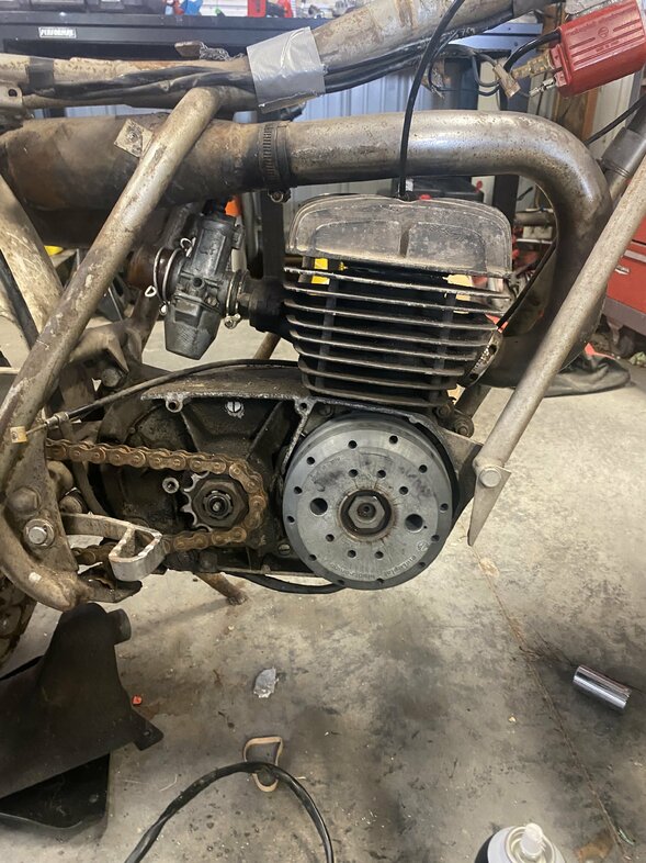

ossabikes27 Posted October 15, 2023 Report Share Posted October 15, 2023 hey all, i’m trying to replace the stator in my 72’ 250 mar but i’m not really sure what to do where i’m at. i have a vague idea but i’m just making sure i don’t mess anything up. i was wondering if anybody knows what i need to do to get to the stator from here? thanks. Quote Link to comment Share on other sites More sharing options...
lemur Posted October 15, 2023 Report Share Posted October 15, 2023 (edited) Right behind that flywheel that spins with the crankshaft, you're almost there. The big nut in the middle needs to be removed and then the next thing you will need is a puller to remove the flywheel because it is on a taper shaft with a keyway, the flywheel carries the magnets that make the power when they pass by the stator coils. Breaker points ignition is also behind that flywheel and a small condenser/capacitor too. Edited October 15, 2023 by lemur Quote Link to comment Share on other sites More sharing options...
cleanorbust Posted October 16, 2023 Report Share Posted October 16, 2023 (edited) No points on a MAR as far as I recall. The early models were somewhat known for electronic ignition failure. Edited October 16, 2023 by cleanorbust Quote Link to comment Share on other sites More sharing options...
reggie Posted October 16, 2023 Report Share Posted October 16, 2023 There are some Ossa Mar bikes with points. Quote Link to comment Share on other sites More sharing options...
ossabikes27 Posted October 16, 2023 Author Report Share Posted October 16, 2023 2 hours ago, cleanorbust said: No points on a MAR as far as I recall. The early models were somewhat known for electronic ignition failure. what do you mean by points? Quote Link to comment Share on other sites More sharing options...
ossabikes27 Posted October 16, 2023 Author Report Share Posted October 16, 2023 2 hours ago, reggie said: There are some Ossa Mar bikes with points. what do you mean by points? Quote Link to comment Share on other sites More sharing options...
woody Posted October 16, 2023 Report Share Posted October 16, 2023 3 hours ago, reggie said: There are some Ossa Mar bikes with points. MAR had electronic, the green TR77 had points, then they went back to electronic on thr Gripper. They're interchangeable so it's possible to fit the points ignition system to a MAR 3 Quote Link to comment Share on other sites More sharing options...
woody Posted October 16, 2023 Report Share Posted October 16, 2023 1 hour ago, ossabikes27 said: what do you mean by points? Ignition contact breaker points. The stator on your bike has no contact breaker, it's elctronic ignition. What are you replacing your stator with? Quote Link to comment Share on other sites More sharing options...
lemur Posted October 16, 2023 Report Share Posted October 16, 2023 4 hours ago, cleanorbust said: No points on a MAR as far as I recall. The early models were somewhat known for electronic ignition failure. I wasn't sure but searched and found them listed as replacement parts, he will know once he pulls the flywheel. Quote Link to comment Share on other sites More sharing options...
