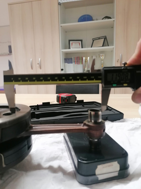

I have been very curious about the OSSA's connecting rod center-to-center length.  Could you make that measurement for me?
I think that at this point, given that it has good tolerances, I won't open it, it's still an operation that stresses the materials, for me it's the first trial engine I've rebuilt so I'll follow your advice if they actually aren't as stressed as a MX
tried to figure out how long the TXT conrods are but I couldn't find this information, it would be interesting to find out which connecting rod it is, I saw that trialshop sells the complete "original OSSA" kit
thought about how to measure the conrod mounted:
Whats-App-Image-2024-02-07-at-15-17-18.j
less pin/2 , plus hole/2 make "circa" 118mm. before reassembling the engine I take all the measurements of the crankshaft and put them here

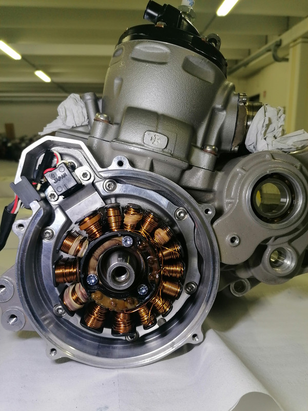

few more updates:

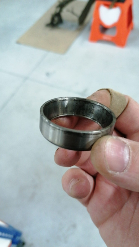

removed the ruined bushing from the crankshaft to make the modification to the plate with the ball bearing:
Immagine-Whats-App-2024-02-21-ore-20-18- Immagine-Whats-App-2024-02-21-ore-20-18-
After a few attempts there was nothing to do, I took the Dremel and made a path to be able to take it with the puller. You need to heat, it's really tight on the crankshaft

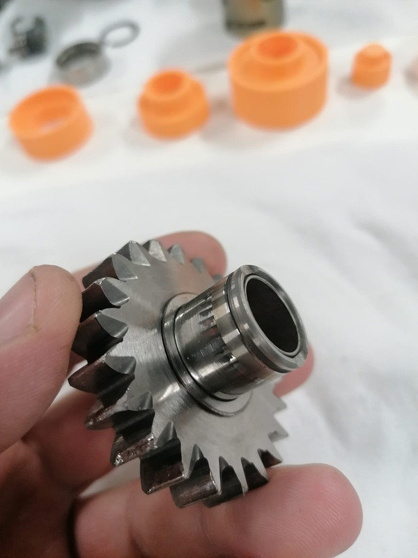

I started to clean everything and create a few 3D printed parts to insert the seals and bearings:

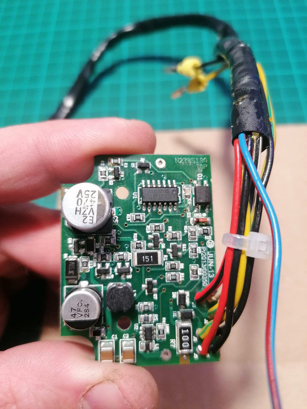

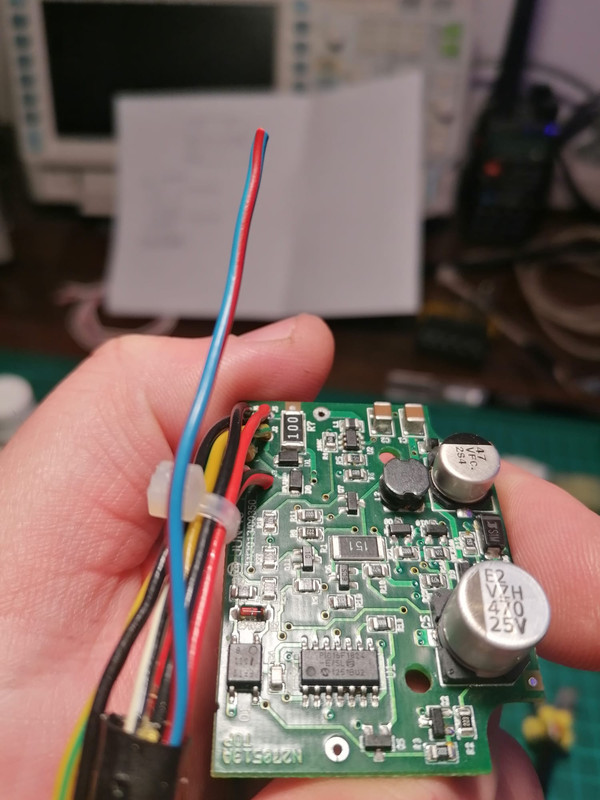

Looking through the things that the seller of my Explorer '14 gave me incredibly I found this:
After a bit of cleaning work, unsoldered everything, resoldered, fixed the cables, here it is:
Immagine-Whats-App-2024-02-21-ore-20-18- Immagine-Whats-App-2024-02-21-ore-20-18- Immagine-Whats-App-2024-02-21-ore-20-18-
Fully functional (I don't know why it was in that condition), I change the battery and capacitor and I think I'll update the electrical system of the '12 Explorer to mount it
the kill switch input is controlled by the PIC which controls the 30 seconds of operation of the step-up power supply and after passing 2 diodes it is sent back to the ECU
The pick-up from the flywheel passes through an optical transistor that activates the system
It would also be easy enough to replicate as a circuit, but big payoff this time!

Your EasyStart is slightly different (and better) than one I disassembled.  On yours, the wires are soldered directly to the PCB.  On mine, there was an insulation displacement style connector between the wires and the PCB.  One of the wires pulled out of that connector.
Thanks for the information on the drum, so just remove any residue that could come off and put it back on.. I just need to fix the starter gear and I should have everything to reassemble the engine.
I also noticed from the pics on your website that your Easy Start is different.. I wonder how many versions there will be. 😁 However the wires were not welded well, easy to get a few shorts..

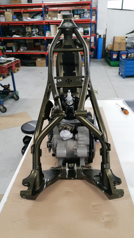

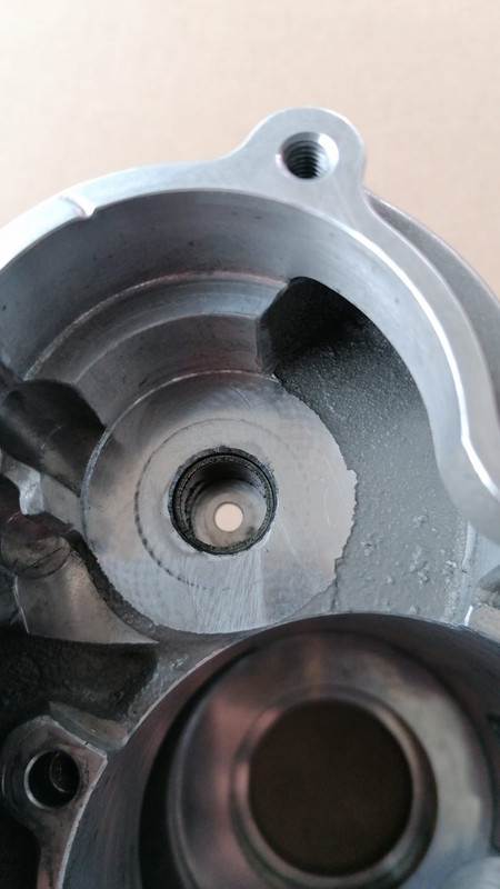

End-of-February update:

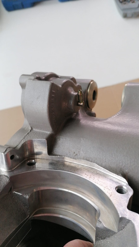

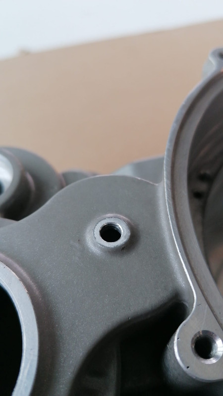

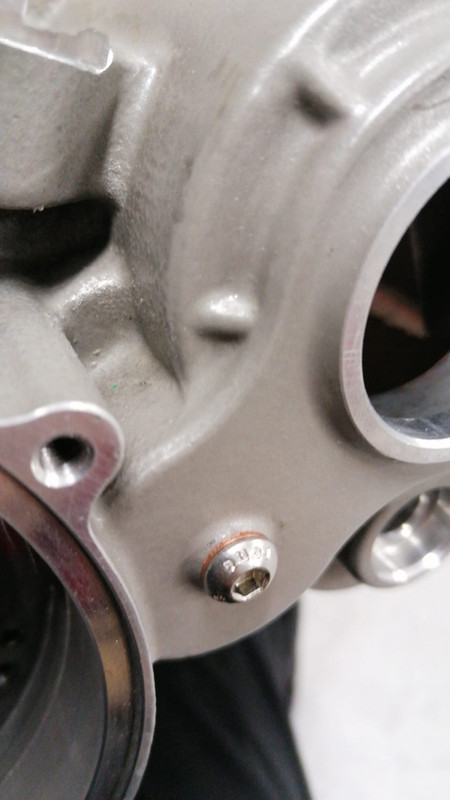

modified the engine crankcase to increase the oil capacity to 450ml by moving the ventilation intake behind the starter shaft (don't tell me about anyone who first closed the clutch cover with the starter return spring stuck 🤬😞)
Immagine-Whats-App-2024-02-24-ore-11-14- Immagine-Whats-App-2024-02-24-ore-11-19-
the wall is thin so I thought of threading the hole m5 and using a bit of loctite, it's much better than hammering it in:
Immagine-Whats-App-2024-02-24-ore-10-42- Immagine-Whats-App-2024-02-24-ore-11-21-
 threaded the original ventilation hole to m6 and added a stainless steel screw with a copper washer:
Immagine-Whats-App-2024-02-24-ore-11-30- Immagine-Whats-App-2024-02-29-ore-18-05-

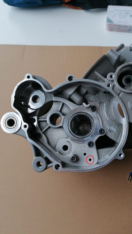

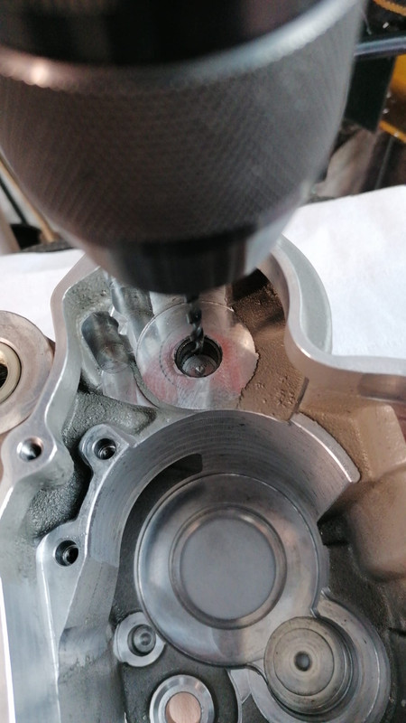

modified the gearbox plate by drilling a 4mm hole at the bottom right to allow oil to pass better on the left:
Immagine-Whats-App-2024-02-24-ore-12-53-

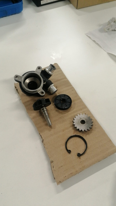

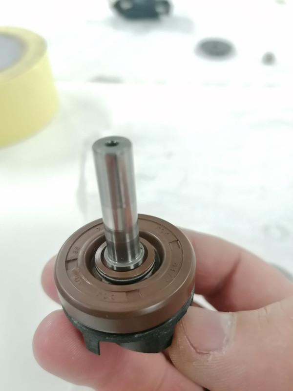

Water pump overhauled:
a small puller on the gear is enough to free it from the shaft, behind it there is a circlip and everything comes away magically:
Immagine-Whats-App-2024-02-24-ore-18-22- Immagine-Whats-App-2024-02-24-ore-19-28- Immagine-Whats-App-2024-02-24-ore-19-28-

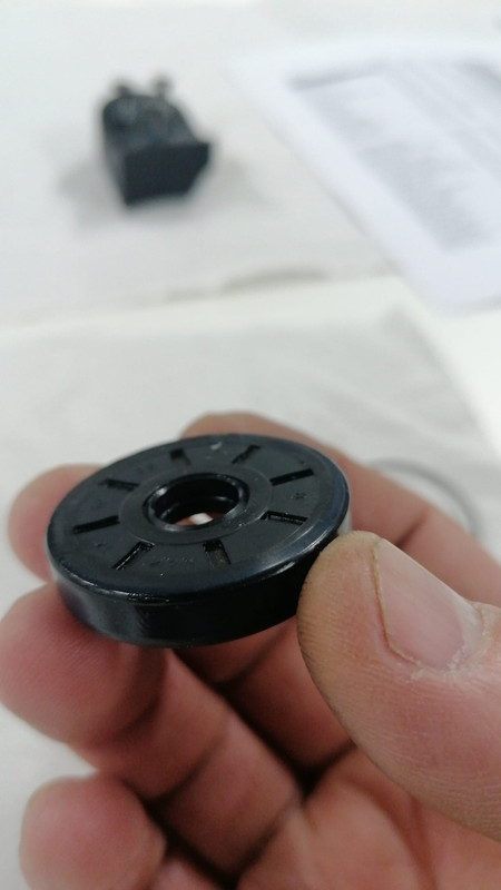

used a Gas Gas seal instead of the original one which has a double lip and is perfectly compatible:  MT280210020 10x35x7.
install backwards, you don't need as much pressure to insert the gear into the shaft, be very careful when handling the seals especially when sliding onto the shaft!

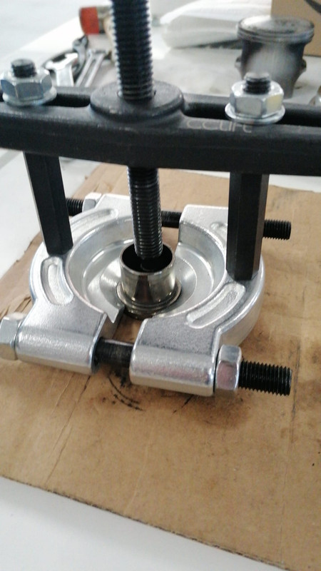

here I was really lucky, thanks to the €35 puller on Amazon (the best money spent ever), first removed the bearing rollers mounted on the plate and then using a piece of soft aluminum (be careful not to ruin the thread of the steering column) I pulled the bearing race.
for the frame I used a slightly bent iron rod and knocked out the bearing race using the 3 grooves in the frame

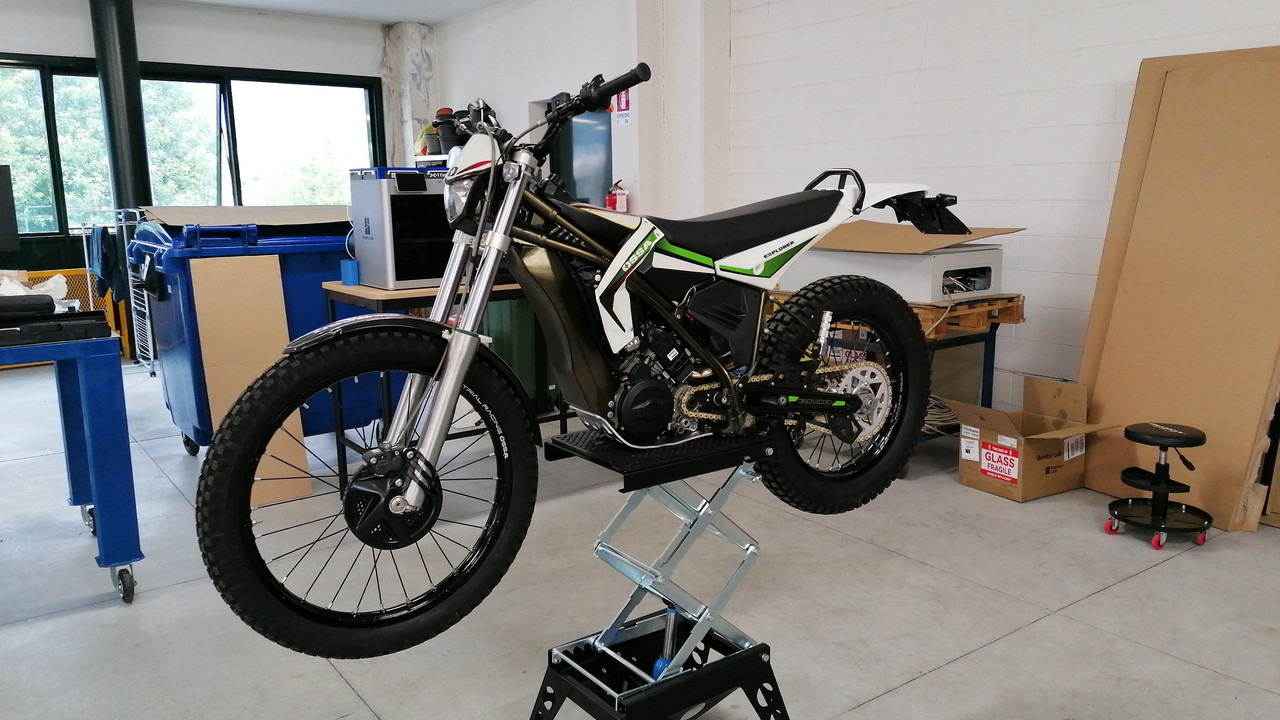

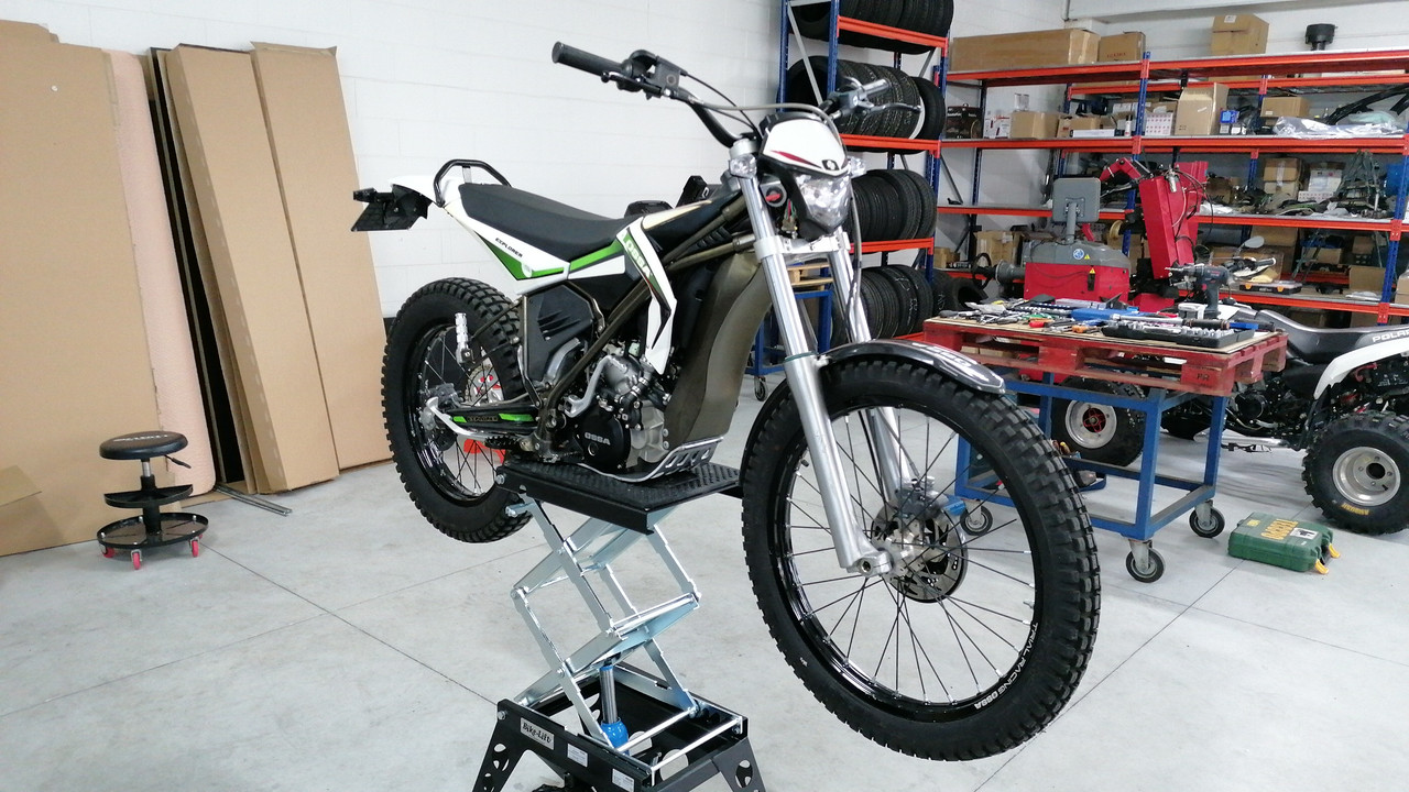

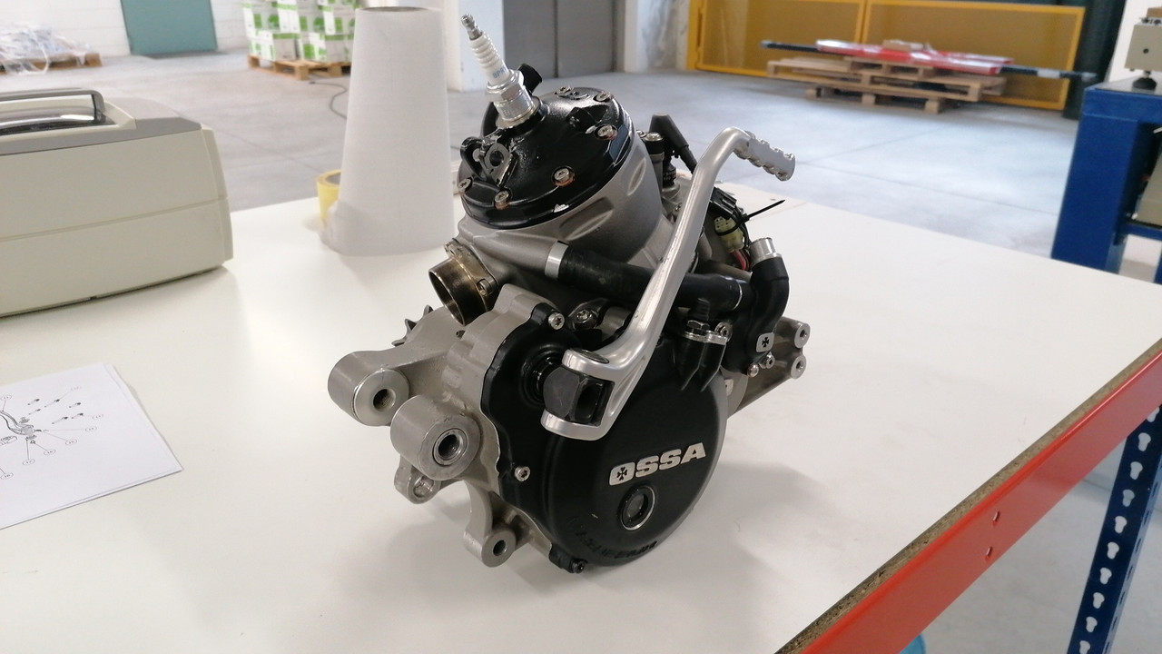

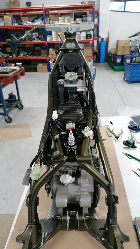

After some time and a season behind us, here are some photos of the rebuild:

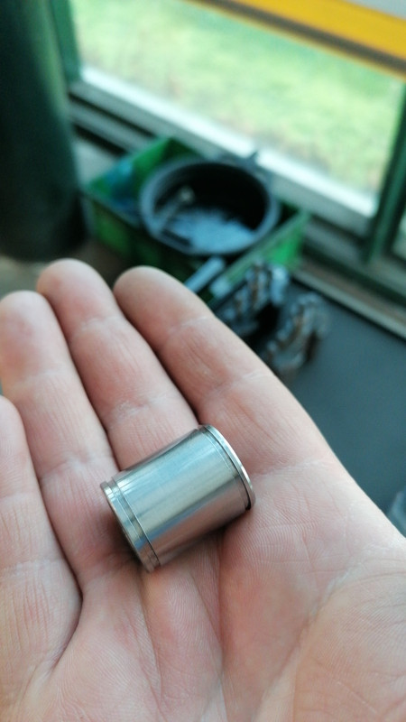

The bike has already done an enduro season and works very well. now I'm starting my Explorer and I'm going to open a topic on reassembly.

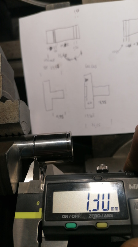

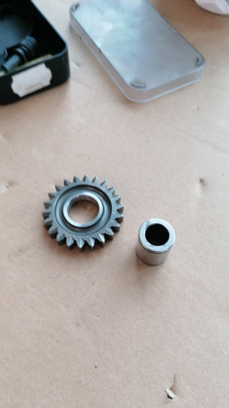

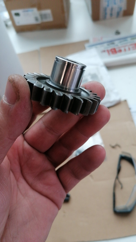

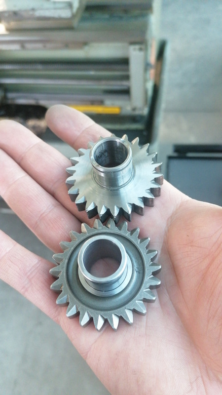

The big challenge was to rebuild the gearbox starter gear.
I used a gas gas gear and a piston pin from a Honda CR500:
IMG-20240323-WA0005.jpg IMG-20240323-WA0011.jpg IMG-20240323-WA0022.jpg IMG-20240323-WA0026.jpg
Here is the final result:
After a season of start-ups (and we know that it is struggling to start) I can confirm that the modification works perfectly!
Obviously it was not easy to work hardened material and take a gear back into the lathe, but I had fun!
