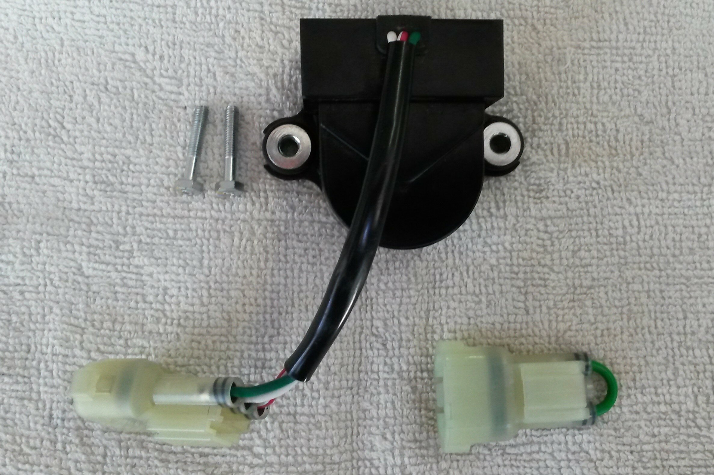

As others have said, some of those things don't need fixing.  However, if you feel the need to remove the Bank Angle Sensor (BAS) then this might help...
The BAS is connected via a 3 pin connector inside that blank vinyl boot above the front sprocket.  To bypass the BAS and allow the bike to run, you need to jump the two outer wires (the green and the red/white) in that connector.  Montesa use very nice sealed connectors from Sumitomo.  To do this bypass correctly, you should buy the correct Sumitomo HM090 male connector. and wire it as shown below right (plug the centre hole).  Anything else will risk water ingress into the wiring.
One place you can get the connector is Cycle Terminal in the USA.  Look for "Male half only Natural Male HM090-3 $3.25 each" on http://www.cycleterminal.com/hm-sealed-series-090.html page.
