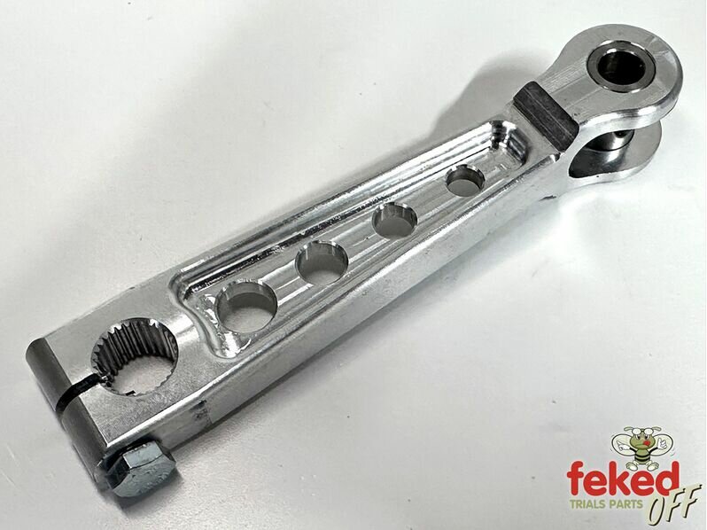

johnnyjazz Posted September 28 Report Share Posted September 28 (edited) Hey friends, any thoughts on this for the reflex? I've installed new EBC grooved pads but rear brake is still terrible! - is re machining the drum a better option? thanks for any insight before i drop some $$ Edited September 28 by johnnyjazz Quote Link to comment Share on other sites More sharing options...

johnnyjazz Posted October 7 Author Report Share Posted October 7 (edited) Hmmm!. try as I might I cant find anyone near me (Westchester, NY) who can do this..the one warm lead turned out to be a guy who only works on Harleys. none of the machine shops wanted to know So, with that said- would that brake arm extender make any kind of difference at all, or is it just a waste of time? i did indeed check to see the shiny bits on the pads that are in contact with the drum..and yeah, it aint much! lol. is there anything else i could do? bike only has 1700 miles on it. Edited October 7 by johnnyjazz Quote Link to comment Share on other sites More sharing options...
