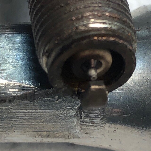

mcman56 Posted October 2 Author Report Share Posted October 2 Plug color is a bit uneven but doesn't look too bad. It doesn't smoke. I am running much leaner than stock jetting. When I got it in 2018, it had the factory jetting of 27.5 pilot and 120 main but ran poorly. The advice was to go richer but when I went that way it was worse so I went the other way. It kept running better the leaner it got so I ended up with 17.5 and 115 which is much leaner than all recommendations. The engine is getting up near 300 run hours so I wonder if it has slightly less vacuum and is less tolerant of lean jetting. Quote Link to comment Share on other sites More sharing options...
lineaway Posted October 2 Report Share Posted October 2 With lean jetting the valves could be slowly fading with the heat. Try a compression test. Also the intake boot is prone to cracking. Quote Link to comment Share on other sites More sharing options...
