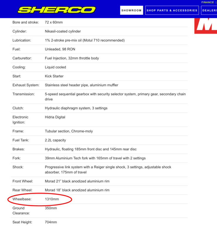

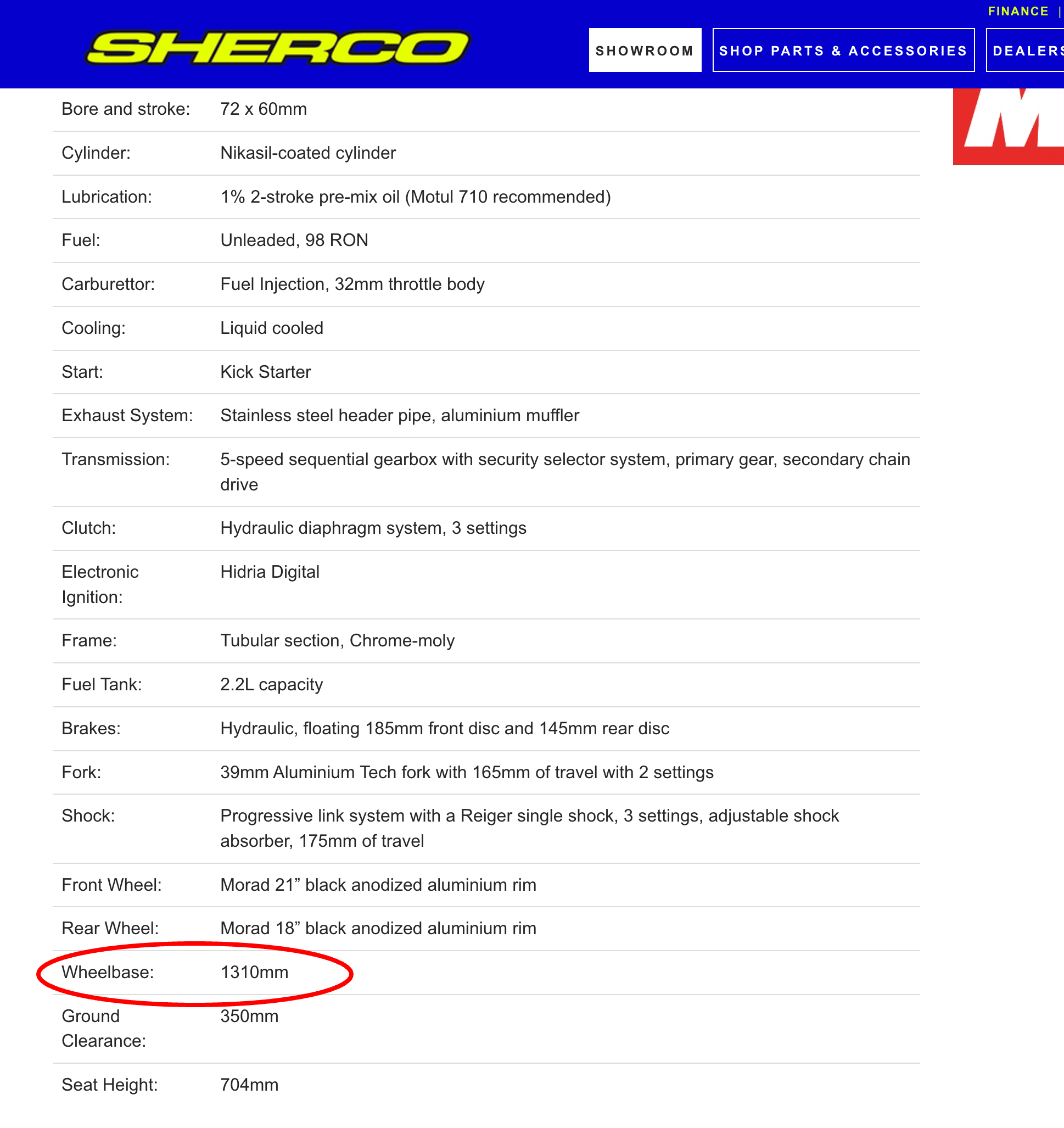

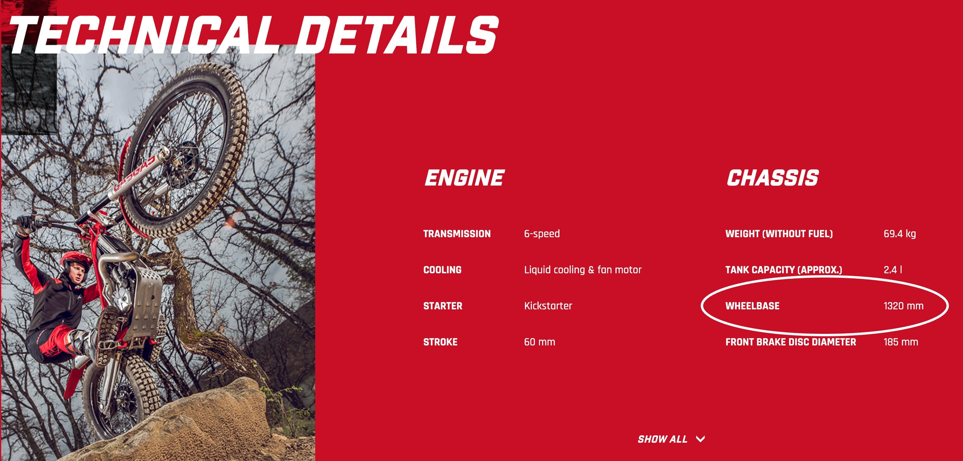

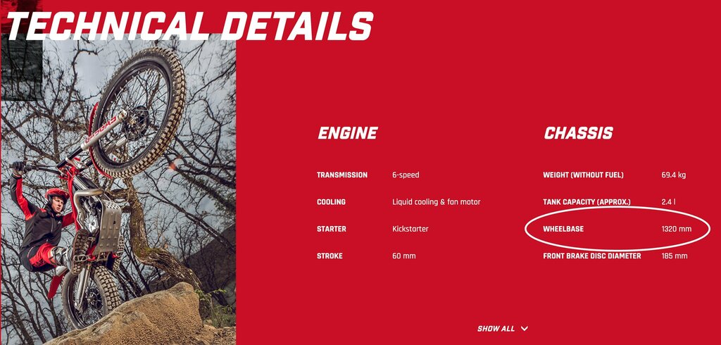

arnoux Posted December 22, 2025 Report Share Posted December 22, 2025 1 Quote Link to comment Share on other sites More sharing options...
