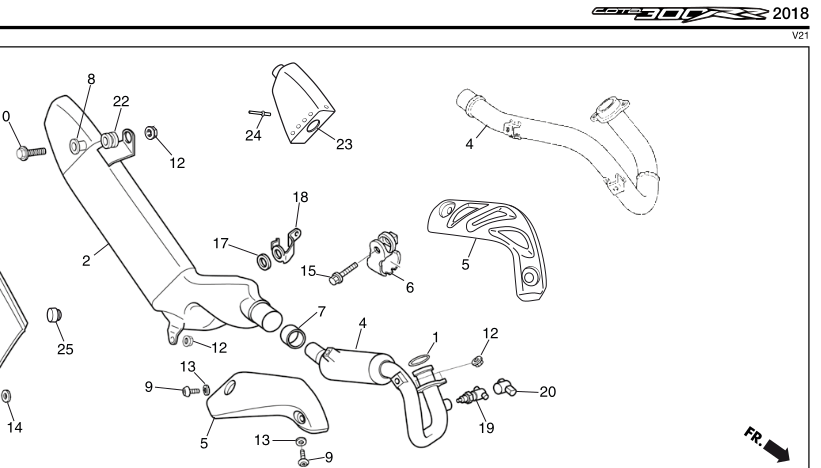

mcman56 Posted January 5 Author Report Share Posted January 5 This is a 2018 300RR. I don't see anything like that on the parts diagram. (The power bomb pipe with O2 sensor is for the street version) I would like a softer off idle response. Quote Link to comment Share on other sites More sharing options...
jrsunt Posted January 5 Report Share Posted January 5 I presume you’re uk based, the street legal or ED and 2ED bikes weren’t really ordered by dealers in the uk as there isn’t a market for them, the 4ride filled that market. The 3ED and 4ED are the competition versions that came more or less ready for trials without having to swap parts. The 4 ride (2ED) does come with the road legal front pipe as well as a 3ED/4ED front pipe in a kit. It was generally swapped for the 3ED parts as it made the bike a lot better. This is only a 26mm pipe as with all the 260’s. The parts list shown by lemur is from a 2005/2006 bike. Which only had to fulfill Euro4 requirements. The restrictor was a very basic top hat design, something that could easily be fabricated to fit the 300 pipe. It may be worth looking in to. If you could find one off the original 4rt it would fit, the cylinder head is exactly the same from the 1st 250’s right through to the current 301rr Quote Link to comment Share on other sites More sharing options...

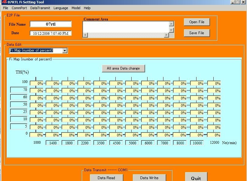

konrad Posted January 5 Report Share Posted January 5 (edited) 21 hours ago, jrsunt said: Mapping would be the way to do it, getting hold of a HRC (fully programmable) throttle body may be impossible though. This is very interesting to me! I talked a friend into buying an HRC "Setting Tool" for his 4RT. I'd never see one for sale in the USA, but he was able to get it out of the UK. It's been in my lab for over a year now, as he seems to have lost interest in riding trials. So I have yet to connect it to a bike. It appears to be able to work with any of the non-homologated ECUs (which should be all the 4RTs in the USA). It does not permit unlimited mapping. What it does allow is a "safe" deviation from the map for any given throttle position and RPM range. It works for both fueling and ignition timing. I'm attaching a screenshot below. Edited January 5 by konrad Quote Link to comment Share on other sites More sharing options...

jrsunt Posted January 5 Report Share Posted January 5 That is interesting Konrad. What ECU have you managed to connect to? On the silver sticker with the part number there is also a 2ED, 3ED and HRC. The early Repsol 4rt’s were all fitted with the HRC version which was programmable. Due to customers fiddling without proper knowledge of what they were doing some ECU’s were causing headaches for the dealers which in turn resulted in future ECUs becoming locked and then the 2 map switch as a compromise. There are also a few “works” ECU’s about from factory bikes. They connect to the software via a 9 pin plug rather than the usual 4. Quote Link to comment Share on other sites More sharing options...
lemur Posted January 5 Report Share Posted January 5 3 hours ago, mcman56 said: This is a 2018 300RR. I don't see anything like that on the parts diagram. (The power bomb pipe with O2 sensor is for the street version) I would like a softer off idle response. See the tailpiece part # 23 and see the tailpiece that it replacers with rivets, I have one of those as spare and I bet lots of other do too. The rest of the restrictors are simple to make on a lathe if you don't want to source them as original Honda parts. Quote Link to comment Share on other sites More sharing options...
konrad Posted January 5 Report Share Posted January 5 (edited) 18 minutes ago, jrsunt said: What ECU have you managed to connect to? None. Unfortunately, have not yet even tried. The unit was purchased secondhand, and it came with a variety of example maps (I guess "map modifiers" would be more accurate) including the 300. The concept is the same as that used on Honda's EFI MX bikes. Sorry for the hijack, mcman56. Edited January 5 by konrad Quote Link to comment Share on other sites More sharing options...
