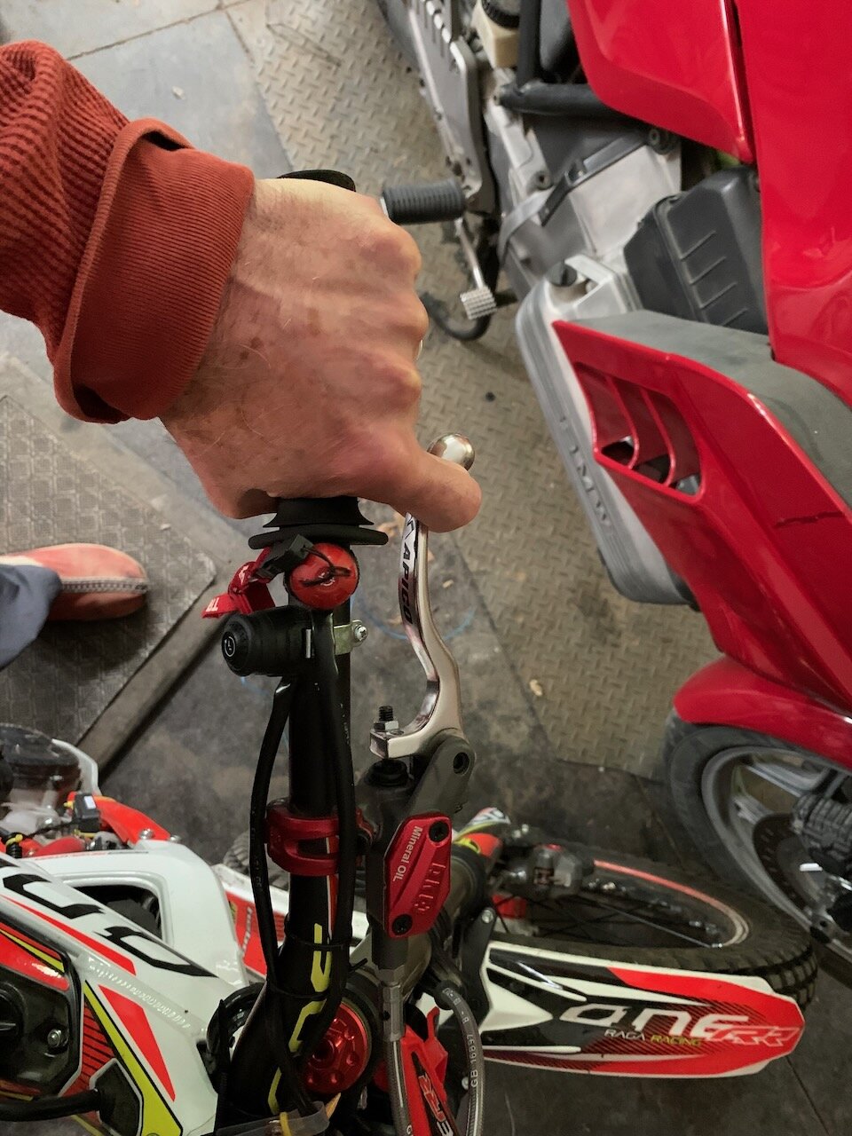

If the clutch works nice right now, I would modify the lever to address your lever problem.  Shorty levers with perches moved way in on the bars and the lever adjusted so your finger can comfortably be at the clutch friction point.  You will rarely bend or bust levers in a crash and never crush your grip fingers behind the lever in a fall 🤓 inexpensive modification to try.
The effective length of my lever setup provides very near double the leverage of a "close to the fulcrum point" setup.  105mm vs 55mm.  ... just measured it
Setup works best for old veteran smashed up arthritic hands.  If you experience arm pump you likely need to adjust the start of the clutch lever friction zone even closer to the bars, shown in the picture is ideal such that your finger can curl one knuckle from the bars, like a comfortable trigger.
