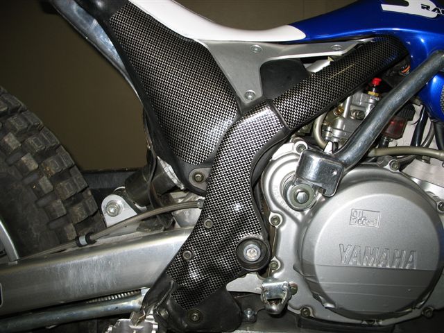

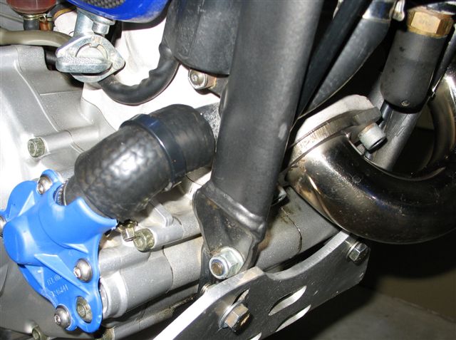

There is one major drawback to a having a Scorpa and that is because the bike flatters your limited riding ability, less points are gained and you find its time to move up a level...... Trouble is you then need ability and rather large appendiges (of which I have none) and damage may and does occure...... For us with limited funds (and a nagging wife) kevlar fork, swingarm and water pump protectors are out so for a mere $15 Aus i've made these bolt ons!!!!

The carbon fiber rear exhaust guard is well worth the money. Nice add-ons.

Ive just got mine and noticed the weak points of the bike for scratching, mainly the frame where your boot rubs. As you have the 04 as do i you can repaint it and it will last about 15mins, ive got the flat bash plate and really like the mod you have done.

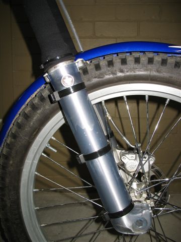

The fork and swingarm protectors are 52mm clear poly tube, belive it or not it helps you grip with the heal of your boots for lifting the back.... (the swing arm not the fork protectors)

Here's my efforts at protecting my recently purchased 2nd hand Scorpa on a budget.
Flat bashplate - 2nd hand.
Front forks
Upper
