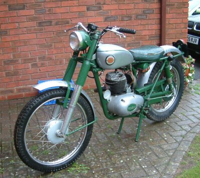

Hi - I'm new to the forum and new to the pre '65 movement. Saw the demo at the Historic motor sport show and it re-awakened old urges. I've acquired an unmolested '59 Francis barnett Trials 83, which needs new tyres. I can't find a 19" trials tyre anywhere. Millers advised me to build a new wheel with an 18" rim. Is this the only way?
Any help would be appreciated

Thanks for the excellent response. The general concensus is to make an 18" wheel. I have found a genuine Frannie barnett hub which is 36 spoke. Any recommendations for a rim and a wheelbuilder?
It still leaves me the problem of finding any sort of 19" trials tyre for the original wheel - Ill keep on looking

I finally found a Dunlop 19" at www.vintagetyres.com
Tel: 01590 612261. It will get me through an MOT and preserve the bikes originality. I have also acquired an 18" Akront rim through the somewhat eccentric route of buying a knackered Montesa Cota 200 - Anyone interested in some Montesa bits? - I have most things now except the rims!! I've got to get rid of it quickly before the wife finds out.
