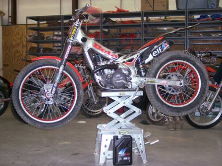

we had the factory test our bike while here in the usa...ok we have some juice for ya..you need a able round grinder..and a talent for buffing and grinding..
ok we take a stock exhaust gasket..open up the exhaust to match gasket open the end of exhaust port of the cylinder to the exhaust. take 25 thousanths off head to raise compression. we use the stock dell 'orto carburator with a 103 main jet and a 42 pilot clip up one spot on needle..add v force reed system
runs awsome much cleaner than std and adds alot of power all through the rev range bottom to top . Ignitions are a factory deal we tried the factory one but had mixed results.. i think you will be pleased with these mods .. just make sure you have a competant person do it for you .. Reeds are available in the usa for 140 usd.. they make a big differance .. we also change the choke jet to a much bigger size cant remember the number right now.. The factory boys really liked our mods .. really liked them.. here attached is a pic. of our RCS 125...
