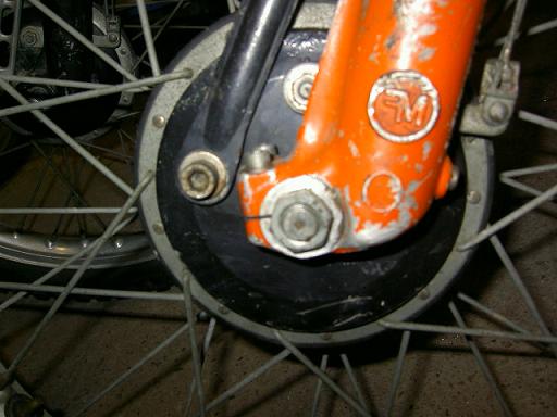

It would be good to see a picture of the standard 300 front brake, if possible....
I do have a 240 which I have not started work on yet so have not compared the brakes, I guess the most efficent brakes will be the ones fitted to the standard 300?
Thanks
The first pic is a std 300 frt brake, Some call it a twin leading shoe, some say it has self centering pads. Note the double lever and pivot in the housing at the bottom.

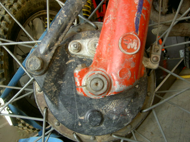

The second is from a 200 or 240. It deffinitely has less stopping power
