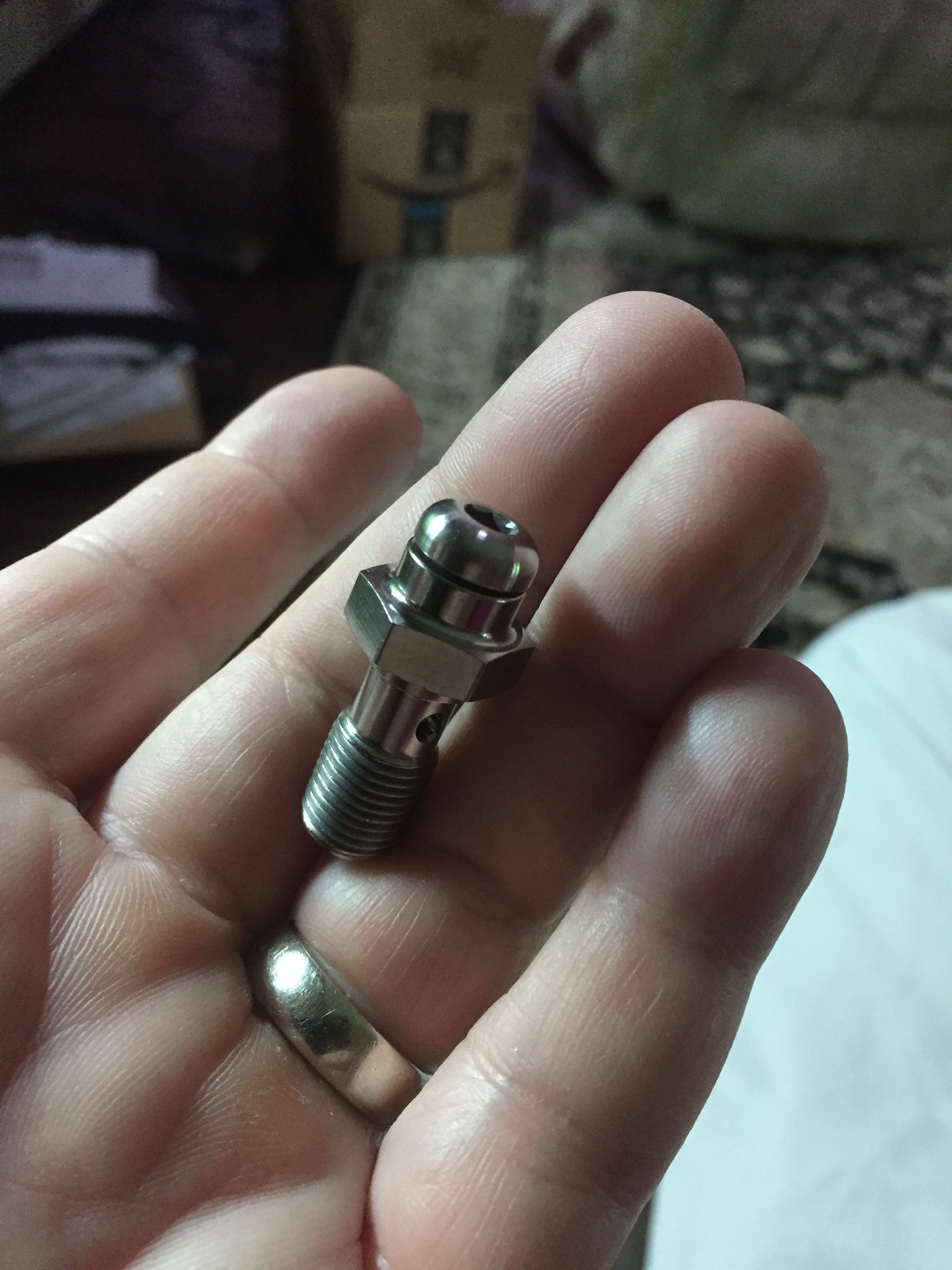

  6. Newest idea, I hate bleeding the rear brake since the high point of the system is the rear master cylinder. So I want to put a bleeder there. The problem is the airbox won’t allow a standard bleeder banjo. So I’m going to try this. I figure if I groove the threads for flow I can put a sealing washer on top and sneak in a cut off allen wrench to bleed when necessary. Titanium? Yup. Overkill? Well yeah! Would work better with the lower profile of a steel bleeder.
