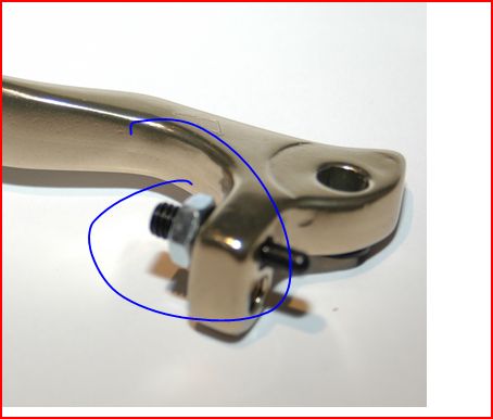

  4. As in, fully disengaged no matter on lever posistion? or fully engaged.
    If fully disengaged
    Try changing the oil, leaving her to warm up properly and then go up to 5th gear and then back down through the box quickly with the clutch held fully in, should release quickly enough... Also, try fiddling with the lever adjuster, is your push rod going right into the master cylinder? is there a push rod? I've lost many of these over time, could of dropped out when dropped or knocked in the shed!
    If fully engaged adjust your levers first, like, your not going anywhere
    Adjust your levers, this can be done by using the wee nut on the lever blade as said above. Adjust that fully out, if still nothing try new oil! Listen out for noises whilst engines running, could it be transmission?

  8. Give it a quick bleed, only takes 5 minutes if done properly, if this doesnt help try adjusting the levers, the push rod into the master cylinder adjusts slightly, not sure how on the scorpa but if its an ajp it should just involve a spanner on the wee nut by the lever blade!!
    As you said it was dropped on the right side, front brake lever, just make the nut hasnt been knocked loose!
