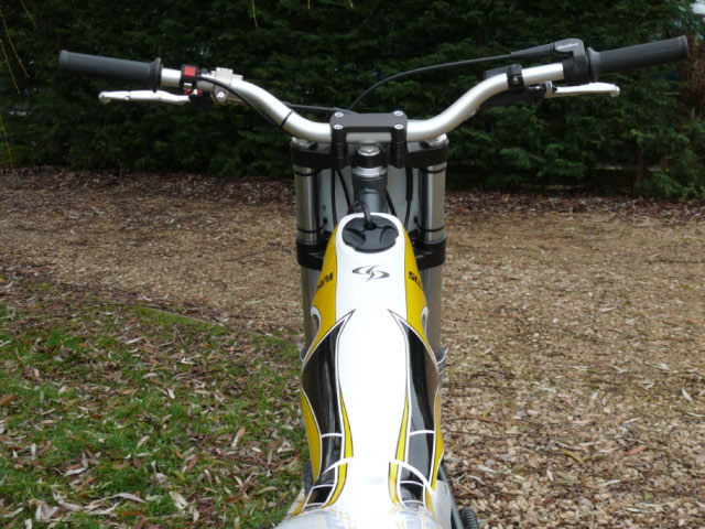

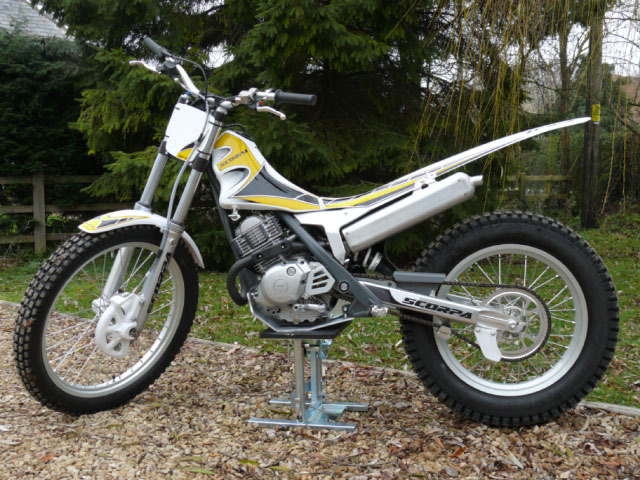

johns Posted January 8, 2007 Report Share Posted January 8, 2007 Miles better than an old tl 125 or a tlr 200 Jamie...... Quote Link to comment Share on other sites More sharing options...
seandellear Posted January 8, 2007 Report Share Posted January 8, 2007 Love the colours on it and a really nice looking bike! Cheers Quote Link to comment Share on other sites More sharing options...
Guest DGShannon Posted January 9, 2007 Report Share Posted January 9, 2007 If you are a Yamaha fan, you gotta' love the colors! I rode an SY175F (143cc) for a little over a year, and absolutely loved the bike. I weigh 225 lbs, and was amazed at how the bike would pull me around. I con only imagine the the now larger engine is that much better. The only problem I experienced with mine was the ground clearance at the front edge of the skidpan. The way the motor mounts results in the front being low to start with, but add my weight to the equation, and I had to be constantly aware of what I was about to hit, or go over. I have since moved on to the SY250F. Great bike as well, but there is something to be said for the simplicity of that little air-cooled motor. Especially when it comes time to adjust the valves! Quote Link to comment Share on other sites More sharing options...

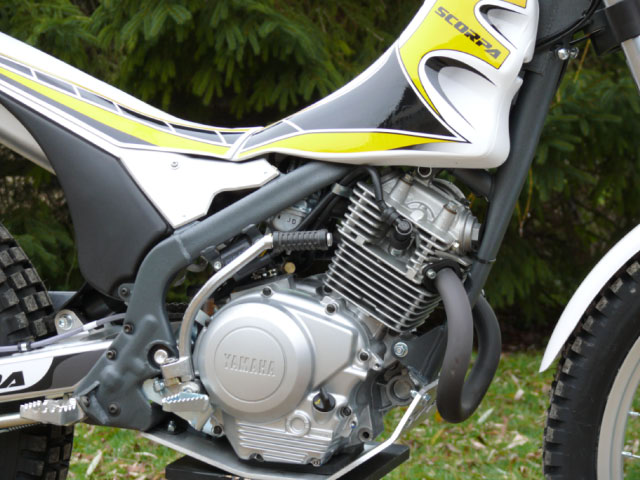

lastplacebrad Posted January 17, 2007 Report Share Posted January 17, 2007 Very nice indeed that John, is that the new SY200, but why o why no proper coating on the front pipe!! Quote Link to comment Share on other sites More sharing options...
austini Posted January 18, 2007 Report Share Posted January 18, 2007 My front pipe on my 143 must of been caoated in black chocolate from new because it started peeling as soon as I started it, even now after a wet trial or I didn't dry it well enough I have to give it a quick respray. Pity because the rest of the bike is superb!!!!!!!!!!! anyone recommend a decent exhaust paint that stays on! Quote Link to comment Share on other sites More sharing options...
donmurray Posted January 18, 2007 Report Share Posted January 18, 2007 My front pipe on my 143 must of been caoated in black chocolate from new because it started peeling as soon as I started it, even now after a wet trial or I didn't dry it well enough I have to give it a quick respray. Pity because the rest of the bike is superb!!!!!!!!!!! anyone recommend a decent exhaust paint that stays on! Same happened on my 125F. I took all the original paint off and resprayed with some high temp exhaust paint from an auto store. It still peeled off from the first few inches. I'm sure there's a paint that will hold. Maybe somone will post. Quote Link to comment Share on other sites More sharing options...
lastplacebrad Posted January 18, 2007 Report Share Posted January 18, 2007 If i were to buy an sy-f 143 (or whatever) i would either get the pipe sent off and chromed(or teflon coated, yes really!!) or buy a new pipe, send that off and try sell the original, a rusty front pipe (fnnrr-fnnrr) would drive me mad!! Quote Link to comment Share on other sites More sharing options...

essex rider Posted January 19, 2007 Report Share Posted January 19, 2007 Why not get a mitani pipe??? Im sure they make them for scorpas, if not mitani it was another japanese company. As for painting the exhaust, remove all the paint and thoroughly degrease it and the paint will last a little longer. Quote Link to comment Share on other sites More sharing options...
marky g Posted January 20, 2007 Report Share Posted January 20, 2007 I had mine chrome plated from new, I know some platers wont touch an exhaust if it's been run on a bike......in the past I've found most high temp paints are very poor, even worse on the super hot front pipe. Quote Link to comment Share on other sites More sharing options...
lastplacebrad Posted January 20, 2007 Report Share Posted January 20, 2007 As for painting the exhaust, remove all the paint and thoroughly degrease it and the paint will last a little longer. Not a 4 stroke it wont, they run a much hotter front pipe than a 2t. Quote Link to comment Share on other sites More sharing options...
