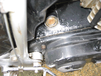

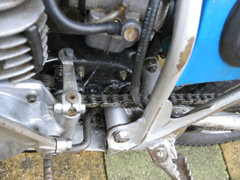

That occured to me after posting Dabster, I meant JR's bike. Have a zoom into the cases, looks like the spindle goes thru' the back of them.
No, the spindle doesn't go through the engine, it is mounted either side of the engine
So you have two "stub" spindles then? Wouldn't that make the handling "interesting"? Or do the "stub" spindles mate with a female that's been grafted onto the rear of the motor. Pic doesn't show that much detail.
There is no attachment to the engine. They are just the stub spindles you mention, mounted directly to the frame plates either side but I couldn't see exactly how as it is all very tight. I think just a bolt pushed through the bush from the inside and a nut on the outside. The spindle is so much closer to the final drive than on Vesty's bike. It worked well as JR had some good results on it when the Bult was past it's best and up against 240 Fantics etc.
Maintenance nightmare though as just to get the clutch case off looks like removal of the swingarm or the engine....
