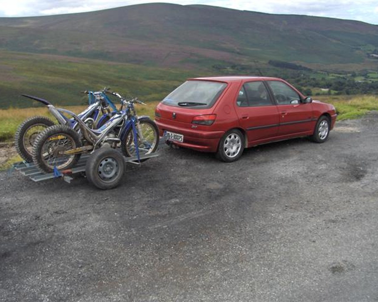

One thing to note is that the 306 doesnt actually have any springs on the rear. They use a kind of torsion bar system.
I know this because I made my bike trailer from the rear axle of another 306. The torsion bars are on splines on either end you can remove the two ends and lower or higher the car on jacks then just pop them back in, its fairly simple.
See the attached picture, the trailer in that pic is not the one made with the pug axle.
