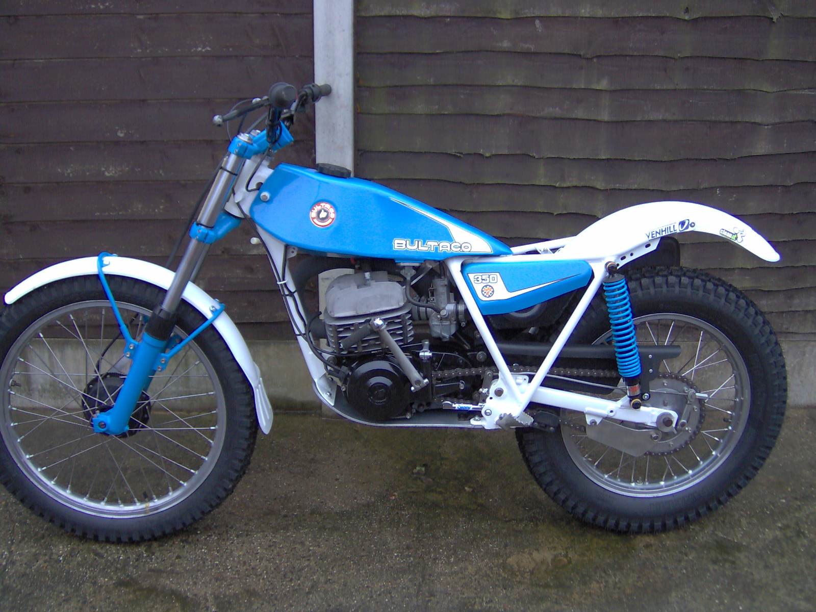

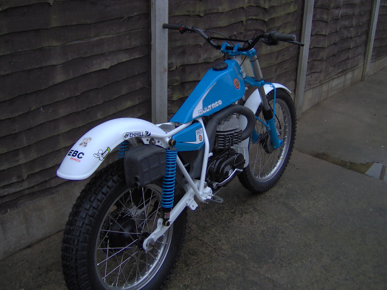

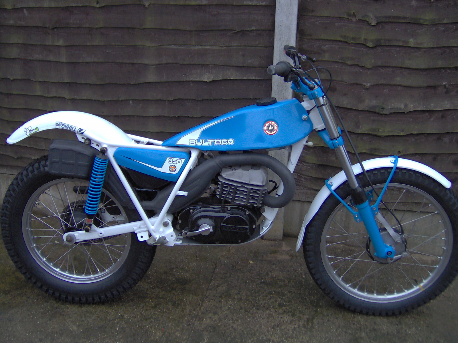

Hi all ,a few photos of my near finished 199b ,just need a nice seat & side stand (hint hint )
and one more (donations welcome its cost me a fortune )thanks

Nice Sherpa, well done! Pity you used a Sammy brake pedal, the alloy originals look better (IMHO)
Edited by Big John
Hi big john ,yeah the miller pedals are rubbish,job to sort out another day .Are the side stands loads different on the 199a? .

Think It's because they wanted the control pedals transposed to "Classic British" type layout. Just down to what you're used to i suppose?
I agree with you BJ and have kept the alloy std r/h brake pedal on mine, doesnt seem to bother me swaping from l/h to r/h so perhaps i'm lucky, but wish i could stop the kickstart hitting the arm of the gear lever :thumbup:
Nice resto BTW although the rivet counters will be on soon with "advice". tank, torque arms etc :D
Just use it and enjoy ;)

Bultaco did a near side brake pedal in alloy fitted to earlier models before the switch to right side braking (a US requirement), I have a couple here that I will use on my 199B's but as the Dabster bike has a special swinging arm (al la Comerfords) the standard pedal will not fit as it's too long. Fitting the brake to the nearside or leftside and shifter to right, gives a much more positive "feel" to the rear brake (right Snr. Greeves?)
As for the tank that's the UK alloy version absolutely correct for a UK spec 199B as Comerfords had them made for the job, so's the bike could be used in the SSDT and UK road based trials. EEU and home Spanish versions had the plastic (and later fiberglass) tanks fitted.

OOOOPs bow to your superior knowledge Obiwan :wall: Mine must be an import then :D never mind.

You need to "waste" the torque arm/ sprocket protecter for a better look.
Swap the lever perches too else one day you will regret it!
