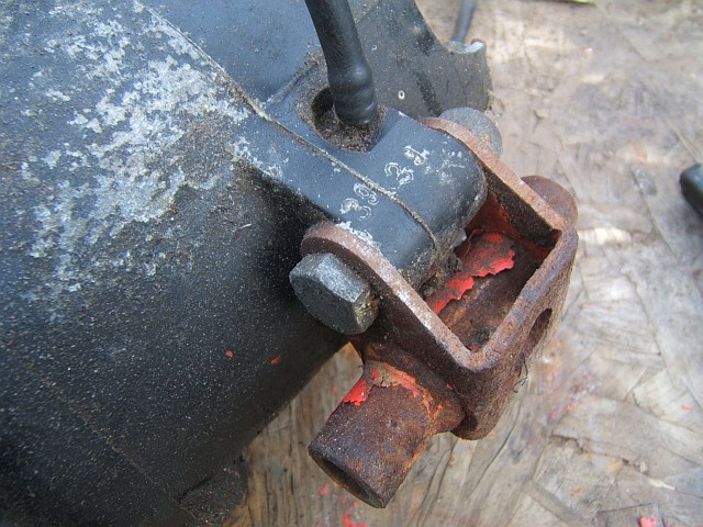

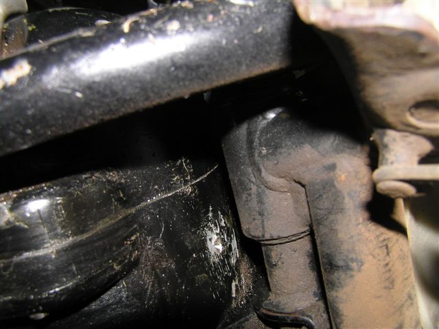

348 and 349 gearboxes do have breathers, but they don't have hoses on them to reach above water level! Have a close look at the rear of the gearbox casing about where the swingarm pivot is and you should see a little hole there which is the breather. Another 348 I bought had that hole sealed up with araldite (and no other way of preventing pressure/vacuum issues within the gearbox)

my in progress Cota 330 (Similar engine) has a breather for the gearbox which has about 18" of plastic tubing on it. This tubing was routed up the rear loop tubes and tucked under the tank. Pic attached of the engine end.

I found that breather while transporting my 348 on its side in my estate car!
That mod on the later engine should be easy to do next rebuild.
should be easy to drill and tap a blanking plug in the caseing then fit a breather and rubber snorkel.

My original engine has no breather, the slightly newer one just aquired does.....but .... looking inside the cases it doesn't seem to actually link to the gearbox chamber!
I will have a better look and work out whats happening, and design something suitable for my rebuild.
