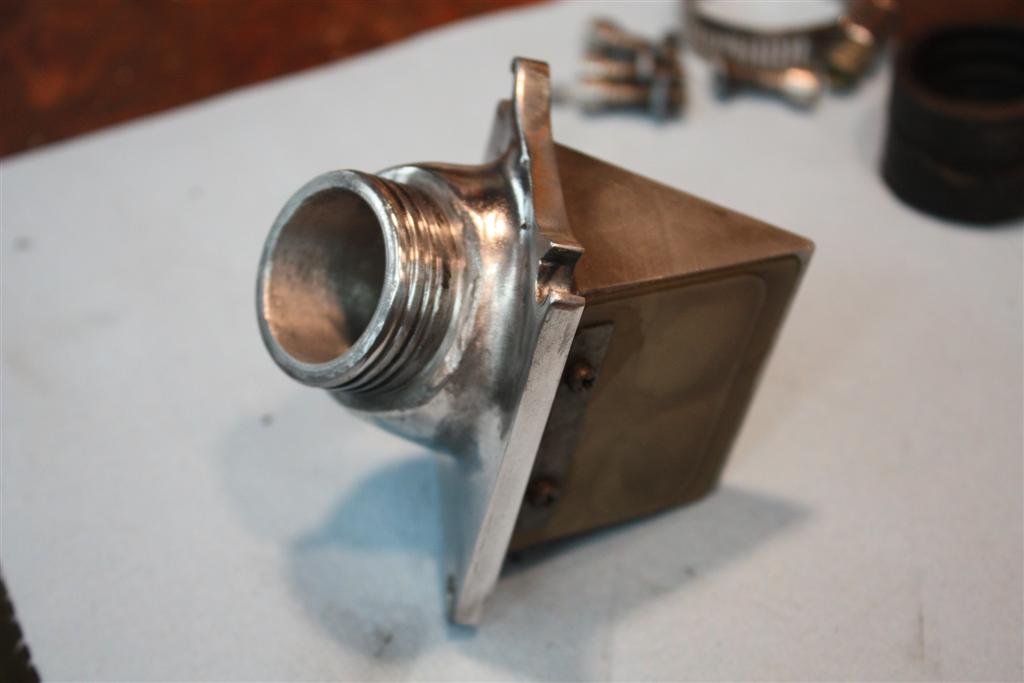

Here's a photo of the cast one-piece manifold/reedcage off the bike:
