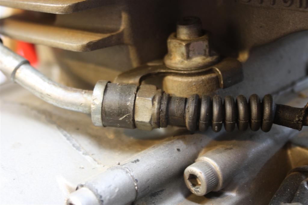

Clutch cable end threaded and nut added to reduce flex in ferrule area to make clutch feel more direct

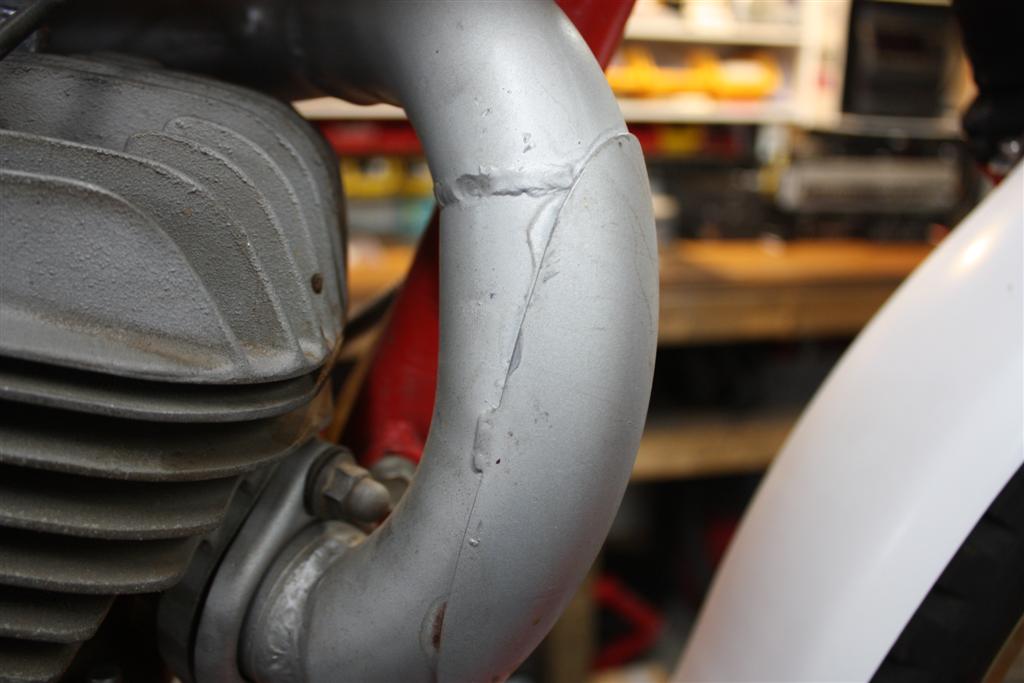

Cut curve of u-bend tubing added to vunerable part of exhaust bend for better rock protection

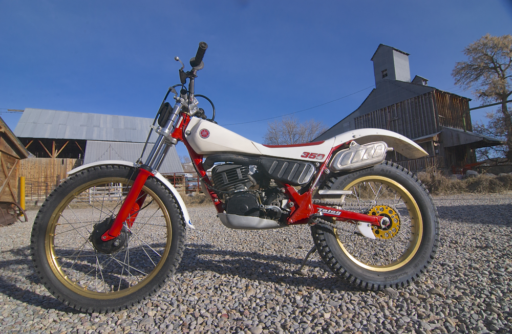

Here are a couple of pictures of the bike now.
Looks like you have the `86 gearing! Next replace the front brake cable mount to the fork with a piece of aluminum block to take up the `flex`. Improves braking quit a bit.
Looks fantastic! I think I may be missing my old one...
Put that speedo in a box somewhere where you won't loose it,she'll be bashed in no time otherwise.
I'm having great luck with the Neutech Tubeless system,allows me to run super low pressure in my SWM rear wheel,Highly recommend(2.5psi no issue)
Yeah. I wanted Talon sprockets and I ordered them from Trial UK, so I figured since I ride in so many rocks, I might as well go with the '86 sprockets. By the way, the two sprockets and the air-freight charge were still cheeper than going with the very-limited supply for these bikes here in the states. I would highly recommend these guys for anything light. The front brake cable mount is next on my list of things to do.
I thought about going with the tubeless system ... maybe next year, I've spent enough that my wife is starting to notice! Speedo is probably safe, as I am self-employed with no disability insurance, and wrecks so far have only resulted in bruises—on me. I am practicing a lot in big rocks and boulder fields though, so it may be better if I take your advice.
Thanks to both of you for your comments.
