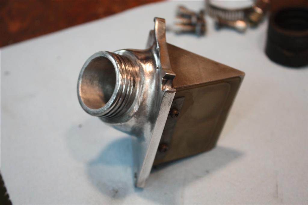

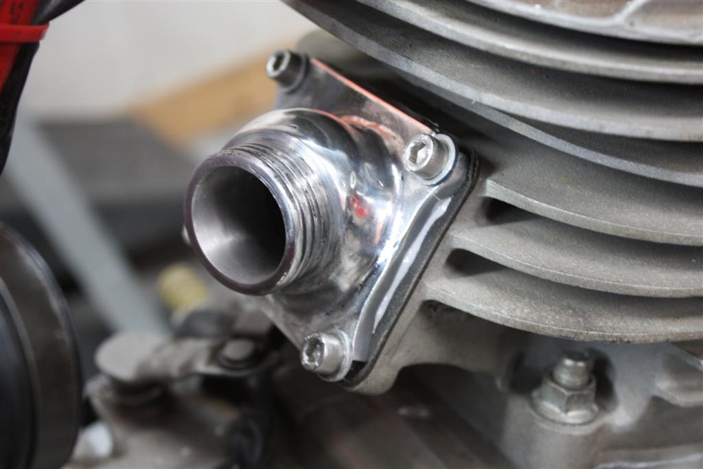

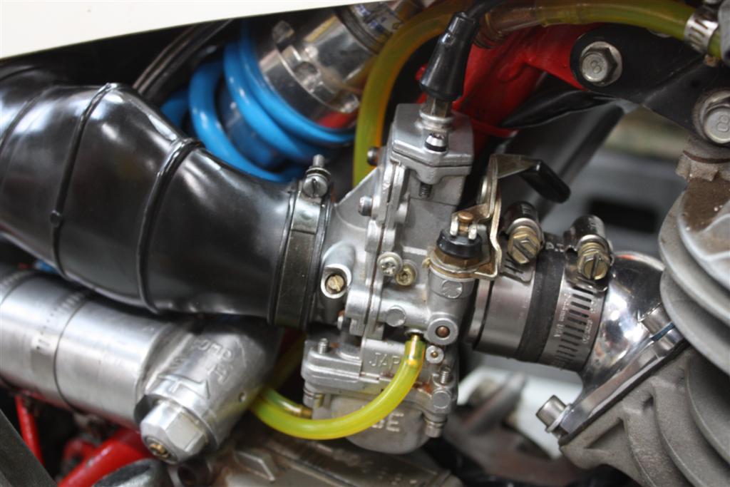

since the A/C Mono forum has gone a little silent, I thought I'd throw something in for us to chew on. This 85' TY350 has been in the family since we bought it new and I like to ride it at our Vintage events in Non-Comp, just-for-fun class.
It has become a test mule for my wild-hair, "hmmm, what if we did that?" brainfart projects and has been modified so many times it starts to whimper when I walk in the shop door. Photos are of a couple of the latest changes:
I revalved a Works Performance shock, added a steel-braided line and a adjustable remote reservoir.
The intake is a one-piece reedcage/manifold I made several decades ago and uses early CR125 dual-stage reeds.
The internally modified Mikuni flatslide 26mm has a machined sleeve to extend the spigot.
Anybody else out there doing weird things to TY Monos?

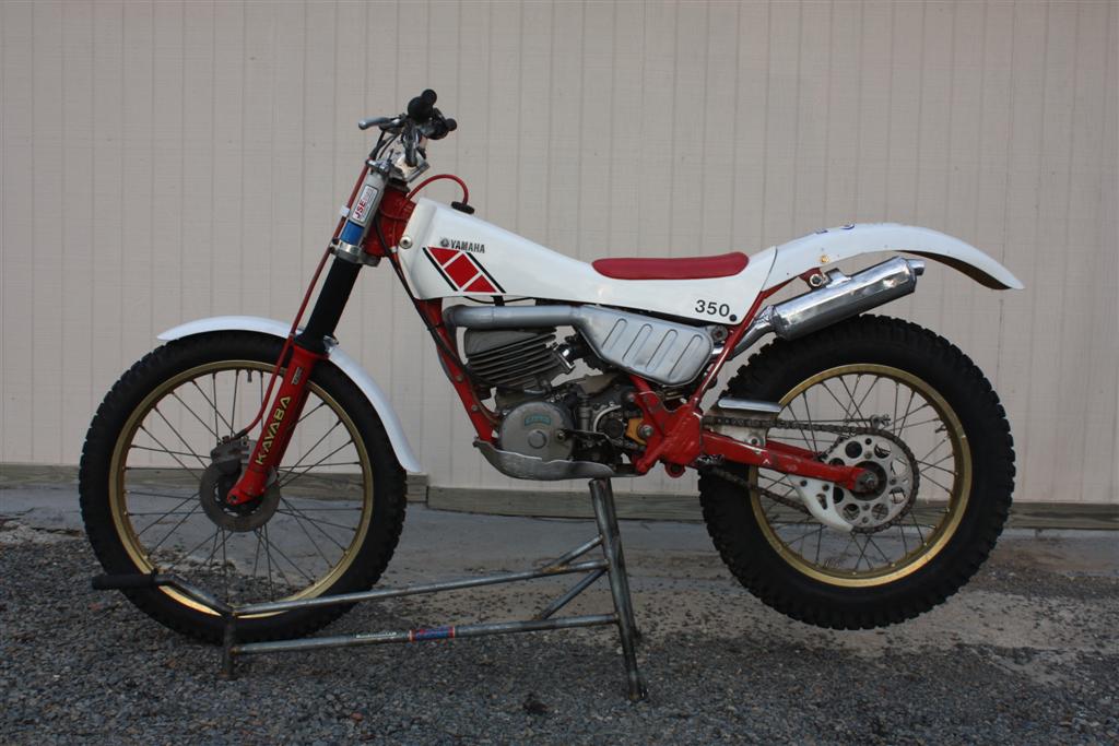

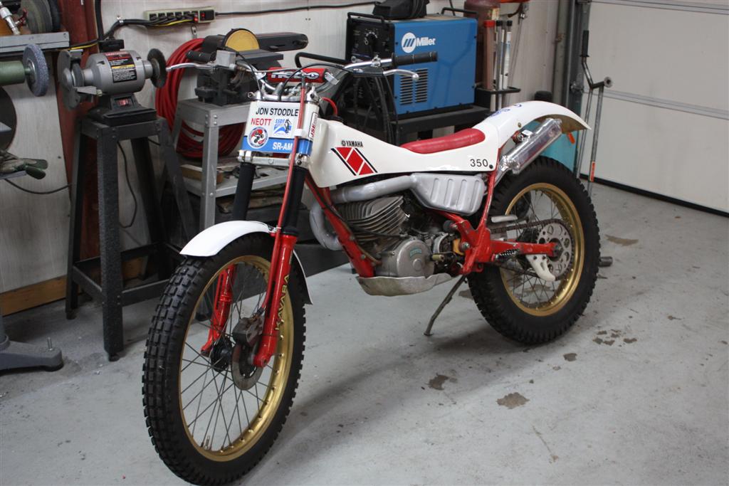

Oh and can we see some pics of the whole bike?
A couple of quick photos of it in it's present condition. As I say, it's a runner not a poser so it has it's share of scrapes and dings, and it sure is fun to ride.
Jon

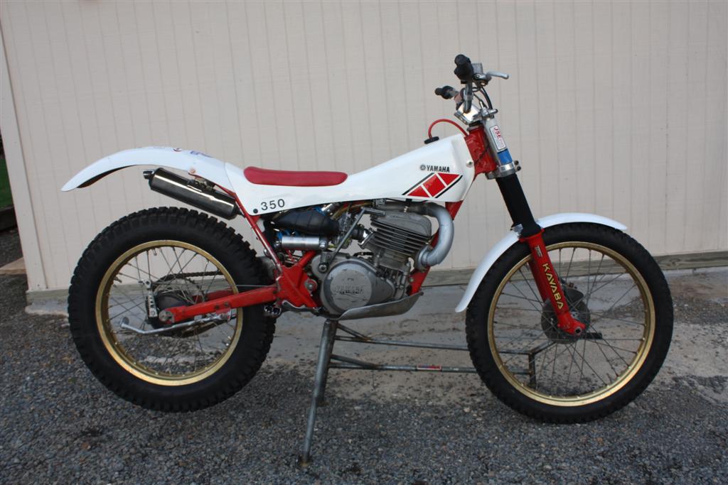

Another quick shot.
Jon
I see your TY350 looks like it has a TALON front disc brake conversion also..
It does and it works quite well. The Talon uses the early AJP pads and is quite simple in operation.
Jon

A photo of the one-piece intake and the carb mod:
