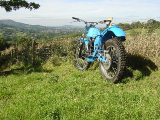

Here are some photos of my 221. Originaly the tank was ally and the seat was slightly different but the colour scheme is correct.

Thanks alot, this has been most helpful. My dad has just recently bought this as an incomplete project for me to restore. The previous owner had sprayed the frame white? Do you know what shade the blue paint is and possibly where i might get it?

The blue I used was old paint colour -Ford 'electric blue' - and powder coat (frame) was either RAL 5015 or 5017. If you compare RAL chart to an original Bultaco item one of them is a very close match.
