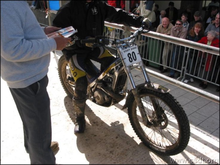

Ishy finished the 2002 SSDT on a Sherco 125 so it's not down to the bike.

Take it over to Whites al the spanner will sort it for you. Do you strip and clean your carb after you wash your bike? i notice it was wet in your pic and looks like you just washed it. it could be water in the carb bowl or air filter but this would run through after a while?

In the picture i had just washed it yes.
