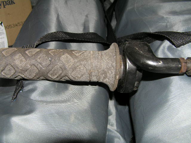

windlestone Posted January 29, 2011 Report Share Posted January 29, 2011 Looks to me like these are incorrect Twist grip Rear Shock Absorbers Fork Gaitors should be black Should have top and bottom chain tubes Petrol tank cap Link to comment Share on other sites More sharing options...

bpilgrim Posted January 30, 2011 Author Report Share Posted January 30, 2011 Looks to me like these are incorrect Twist grip Rear Shock Absorbers Fork Gaitors should be black Should have top and bottom chain tubes Petrol tank cap A few more questions! Do you know what the original twist grip would be? I got it with a broken Domino throttle and I put an new Amal T80/200 on. For the shocks, any ideas on the make and length? Thanks Link to comment Share on other sites More sharing options...

jimbo349 Posted January 30, 2011 Report Share Posted January 30, 2011 Thanks for the info on the rims and hubs, that's good news! I can now get them refurbed and get some new tyres on the bike! I was initially planning on doing the rims myself, as I wanted to learn how to lace wheels, but I don't have access to a jig to true them, so I think I'll send them off. Anyone know of any wheel refurb places? I don't think they need to be chromed, on the link above to an original 348, they look like they're just polished. Thanks Ben I would be wary of the rims with the heat they have been subjected to the ally will have softened and the rims are realy to be considered scrap in my opinion. The throttle whold have been a straight pull amal thingy and as for the amal levers buy them they dont beak like cheepo atermrket stuff I have had my MH 25 years and its still on the origional levers. Link to comment Share on other sites More sharing options...

feetupfun Posted January 30, 2011 Report Share Posted January 30, 2011 Yes if the front 348 rim has been heat-affected then use the MH349 front rim with the 348 front hub and remove the anodising and polish it. Standard rims are plain polished aluminium alloy - no coating or anodising. You can polish the hubs while the wheels are apart. If you have a bike, you don't need a jig to relace the wheels, you assemble them on a bench and true them on the bike. My 348 came with a black aluminium side-pull twistgrip and will take photos of mine today to show it for other people's opinions. I thought it was the original twistgrip because everything else on the bike was original. Be careful buying AMAL levers. There are cheap replicas available that look right but are brittle and there are also replica AMAL levers that are very good quality (as good as the originals). Cota 348 AMAL levers are black. Here are close-up photos of an original Cota 348 clutch lever and perch. The lever mud/dust covers have been removed in this photo because they make it hard to do cable adjustments. My Cota 348 twistgrip in the photo looks the same as the one on the "eye of Fred" Cota 348 so I reckon mine is original Cota 348. It is not on my ride bike because I prefer to use a modern AMAL sidepull twistgrip. Link to comment Share on other sites More sharing options...

02-apr Posted February 2, 2011 Report Share Posted February 2, 2011 Can't see the last pics but I'm sure my 348 came as original with a traditional throttle and a big loop of cable which I replaced with an Amal side pull. Original grips were really super as they were made for gloveless riding. Original cables had oiler holes in them too if I remember right. The first 348s were high quality stuff in terms of "extras" but this was diluted on later models. The standard rear units were, possibly, Sebacs but they had orange "bags" at the bottom. You'll be lucky to find these as the standard method of tuning these was to put them in a receptacle for the binmen to take away on a Monday morning. Don't worry about the missing headstock - that even happened to works bikes out in the wilds at the SSDT. And it's time all modern mudguards were made from whatever the originals were instead of "instant break" toffee - so much for advancement of technology. Link to comment Share on other sites More sharing options...
